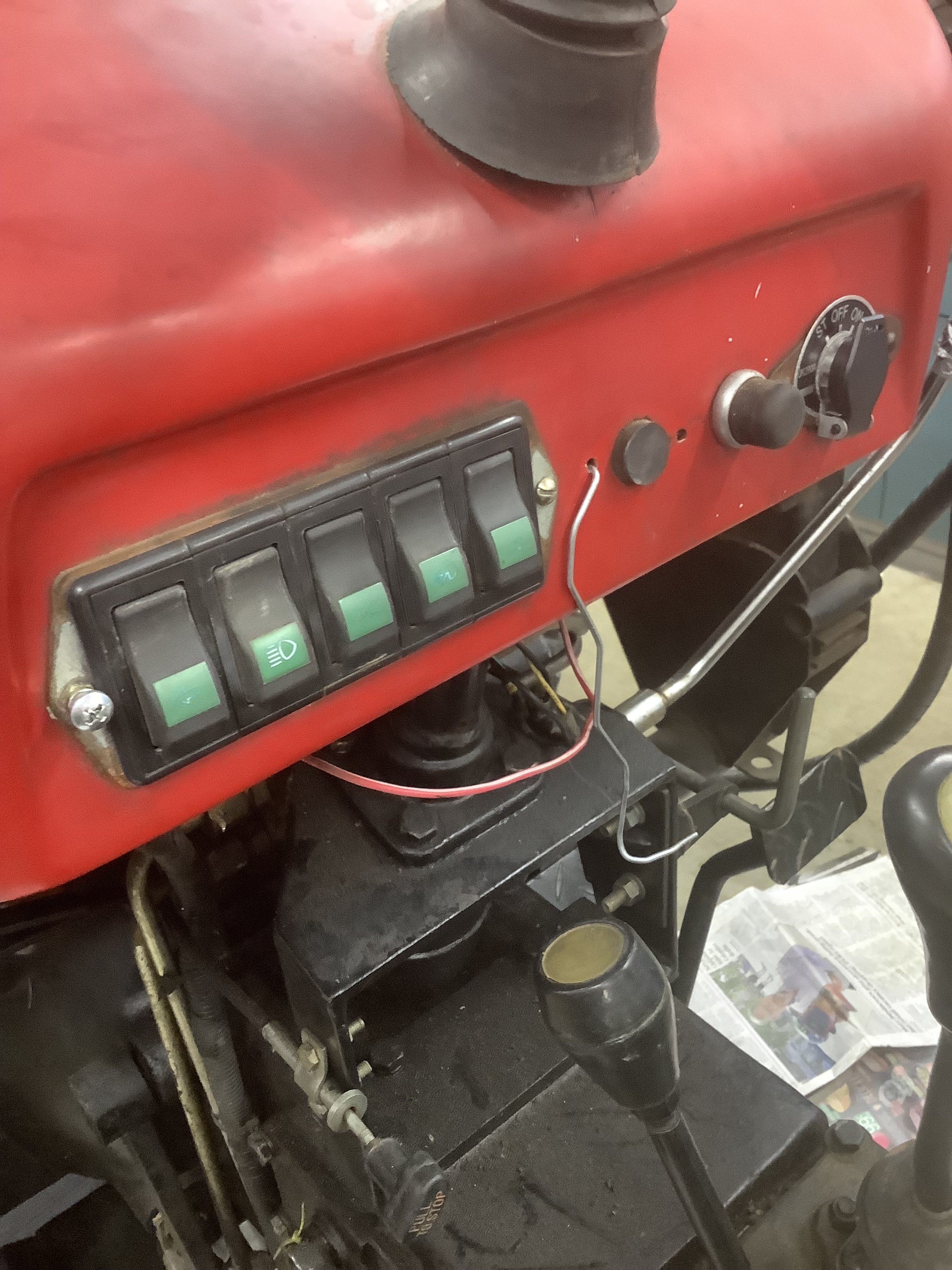

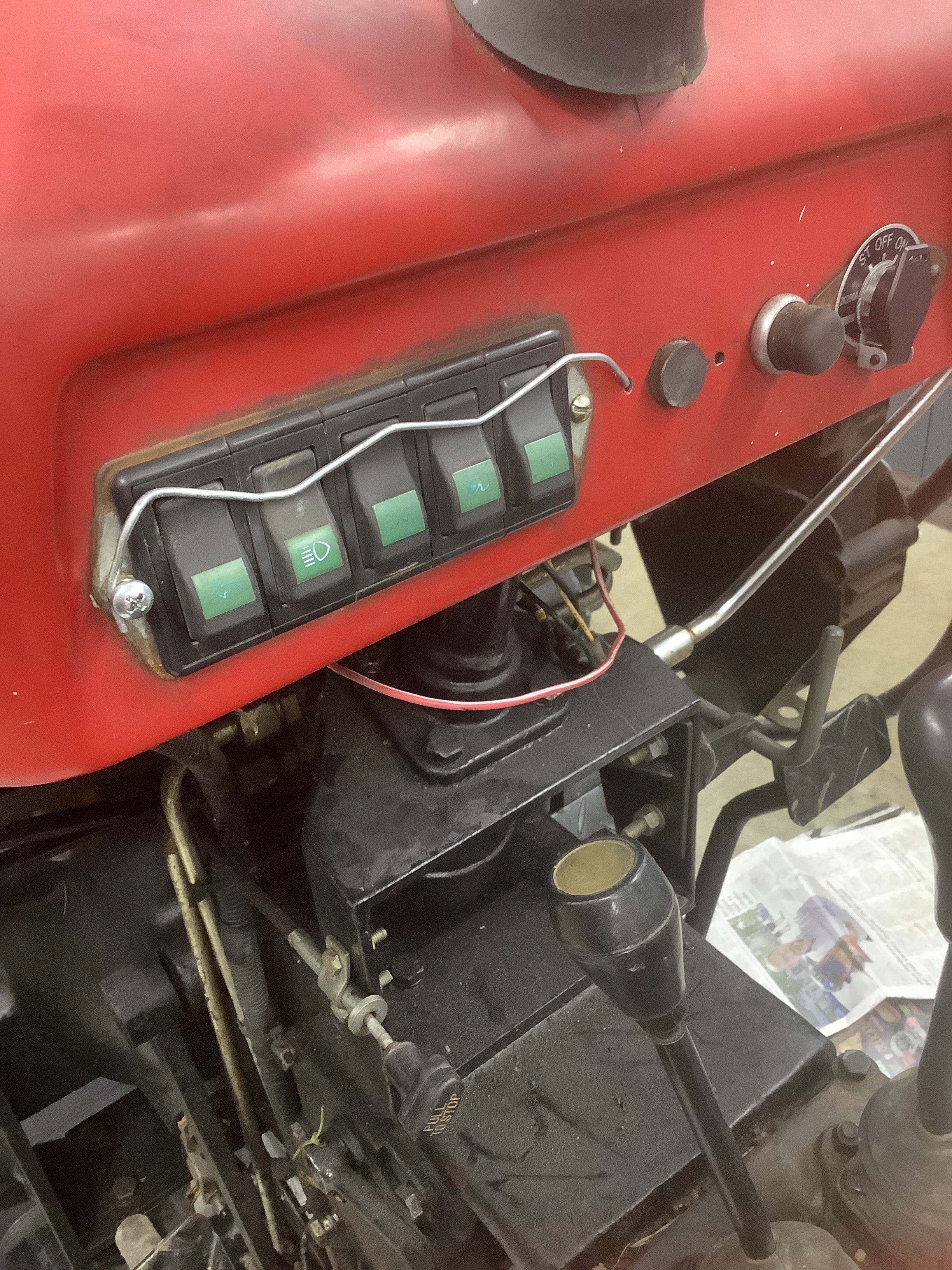

Seems like every time I get off my Jinma 354 I accidentally hit one of the power switches. This can also occur when I use the cover…I also blame my cat for hitting them or maybe it’s the squirrels.

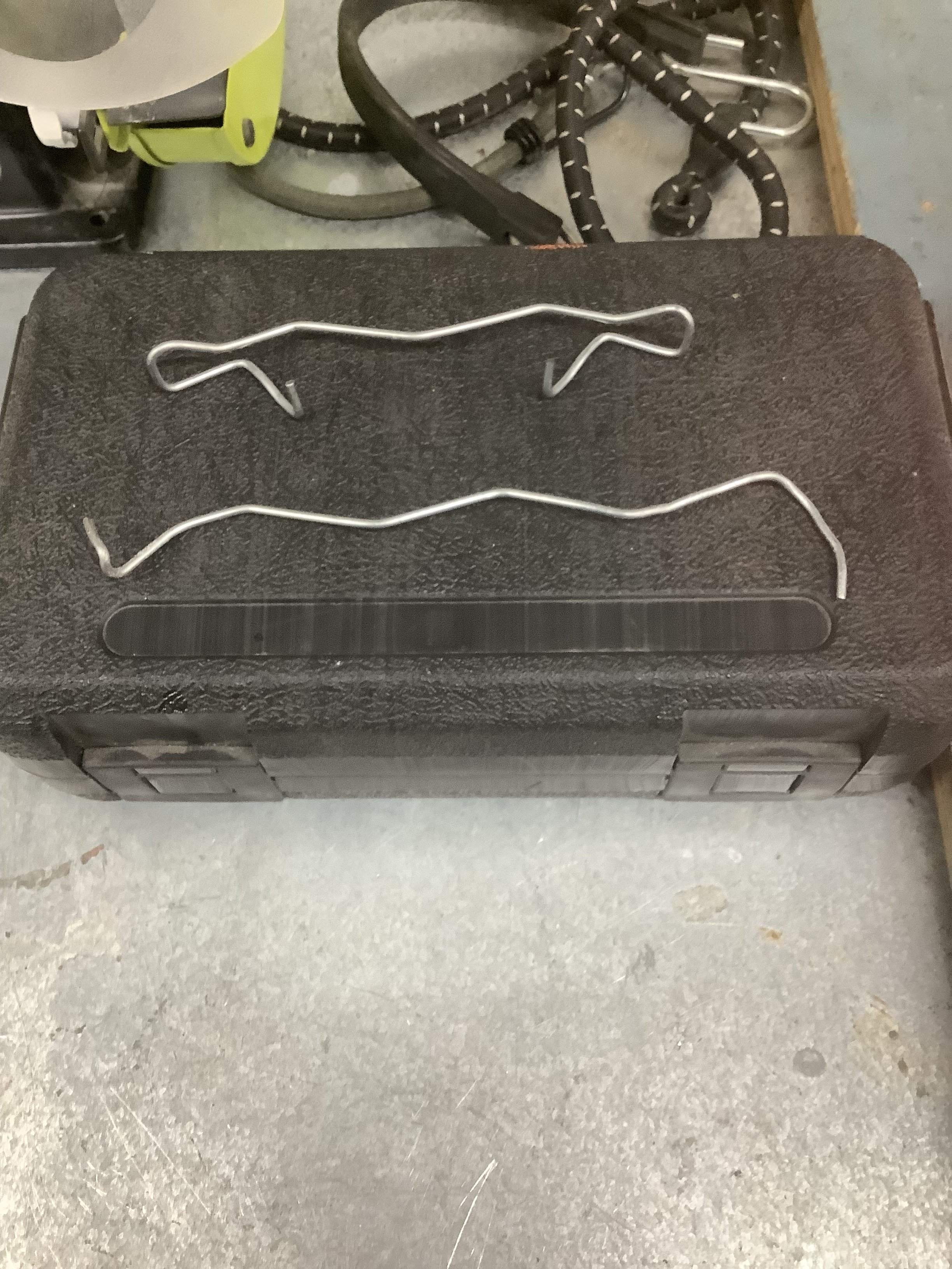

Since I just wanted something basic I used a Ford Escape brake pad spring clip and bent it to go in an existing hole to a lengthened machine screw I put in on the left side of the switches. This all took all of ten minutes and bam no more accidental switch tripping.
There you have it low buck, simple and looks period too.
