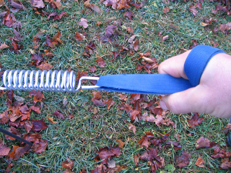

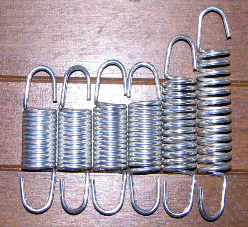

Quite frequently I've seen references in these forums to Tirechains.com as a source for tractor chains. Back in November, I ordered a set of chains from them for my JD790. I included a set of the spring tensioners with the order. While the tirechains.com web site recommends purchasing a binder to install the tensioners, I figured I could tighten them up by other means. When I installed the chains for the first time I simply gripped the end of each spring with a webbing loop and pulled it to the link. Well, you can imagine my surprise when I pulled the springs out (without any mechanical advantage) and the springs failed to retract - i.e., the springs are cheap crap!
Next, I did what any customer might do. I sent an email to the folks at tirechains.com and told them what happened, including photos of the faulty springs. I asked what they would do to back up the product. They wrote back the next day questioning the technique I'd used to tighten the springs. They asked that I send photos of the webbing loop that I'd used to tighten them. I complied and sent them a photo of the 1" webbing strap wrapped around my hand and attached to the spring. That's the last I heard from them.

I had no issues with my purchase from them. I use the spring tensionners (fairly large size for our 4320), I use their chain binder to tension but have used other chain binders as well as just pulling on them. I have really used a lot of tension/force and haven't had any damage, can't imagine being able to put enough force with a simple strap to cause problems (or indeed to get enough tension for it to work like I want), perhaps you got a defective unit.

I bought tire chains from them 2 years ago. I think you need to get their tensoner and go 2-3 times around the tire chain and incrementaly (sp?) tighten the chains. Unless your're saying the steel isn't "springing" back. For me, the steel springs were to tight to pull manually.

Gypsy Rose: first a warm (belated) WELCOME ABOARD!! Sorry to hear of your bad experience. Could be the non-springy spring was made from inferior Chinese steel, (made from rusted out US scrap metal) ? NO Joke!!
It sounds like you have the folks over there stumped, confused or "swamped" with a similar bunch of complaints, (possible). Either way I would not let it go and just keep bugging them with e-mails (for your records) and phone calls till you get some action or at least satisfaction.
If only the "one" spring is not spring steel, it could be just a fluke, but if more than one reacted the same way,....you deserve better than this!!! I'd keep at them, . . . squeeky wheels etc.......

I disagree with the whole tensioner thing, but that is separate from a customer service problem. I have dealt with tire chains on tractors for 40 of my 52 years. If the chains are properly installed, you don't need any springs, bungees, or other stuff to keep the chains on. Put them on as tight as possible, zip tie or wire down the loose ends of the side chains, and go.

All of the springs from both tensioners exhibited the problem. (Not just one bad spring.) I would agree with Tug - inferior Chinese steel. The stuff is definately not "spring" steel.
I'm not yet ready to let it go, although there have been multiple emails and phone calls. (Except for the first reply, emails go unanswered. Phone calls come with the promise that "someone from customer service will get back to you," but so far no follow-through.
Rick - I, too, wonder about the need for the tensioners. I put the chains on very tight and there seems to be little need for additional tension.
My hope is that the primary product from tirechains.com doesn't prove to be as inferior as the tensioners. Time will tell.
