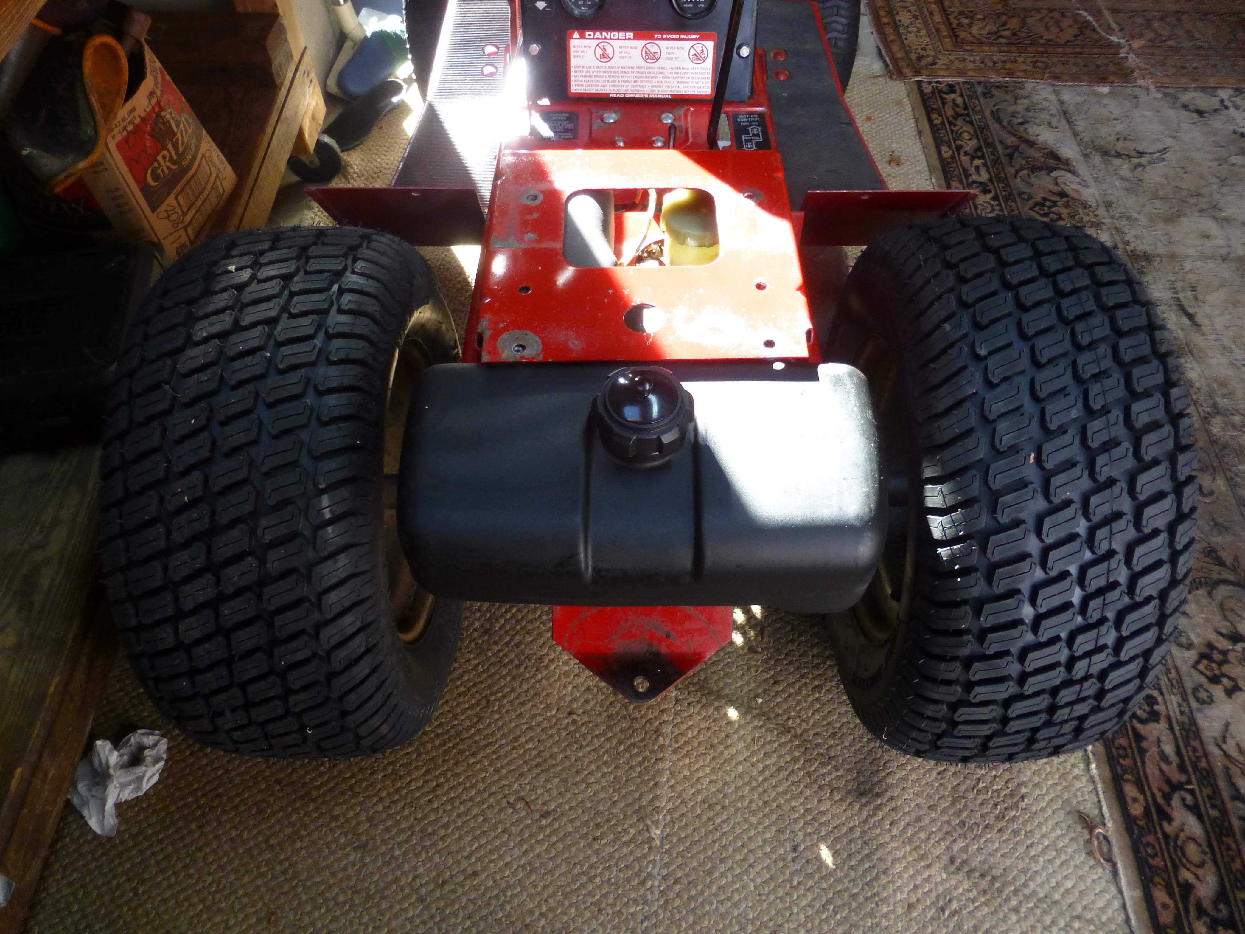

Just installed a new pair of Carlisle Turf Master tires on my Wheeelhorse garden tractor.
I looked for directional arrows and did not find any.
Wondering if these are mounted correctly? See photo, thanks.
Also, when I turn the steering wheel all the way to the right, the wheels tend to lock in the right turn direction.
This does not happen when I make a left turn. Any ideas on how to eliminate the right turn lock up?

Those tires are nondirectional so you have them mounted properly.
Check the steering linkage for signs of wear. Sounds like one of the tie rods might be going over center and causing the steering to lock up.

Tires are non directional. You have done well.

Thanks for the information. Will check the front end for wear, etc..
