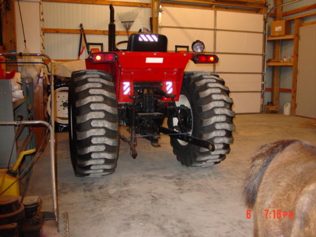

Check these out. I am really pleased with them.
