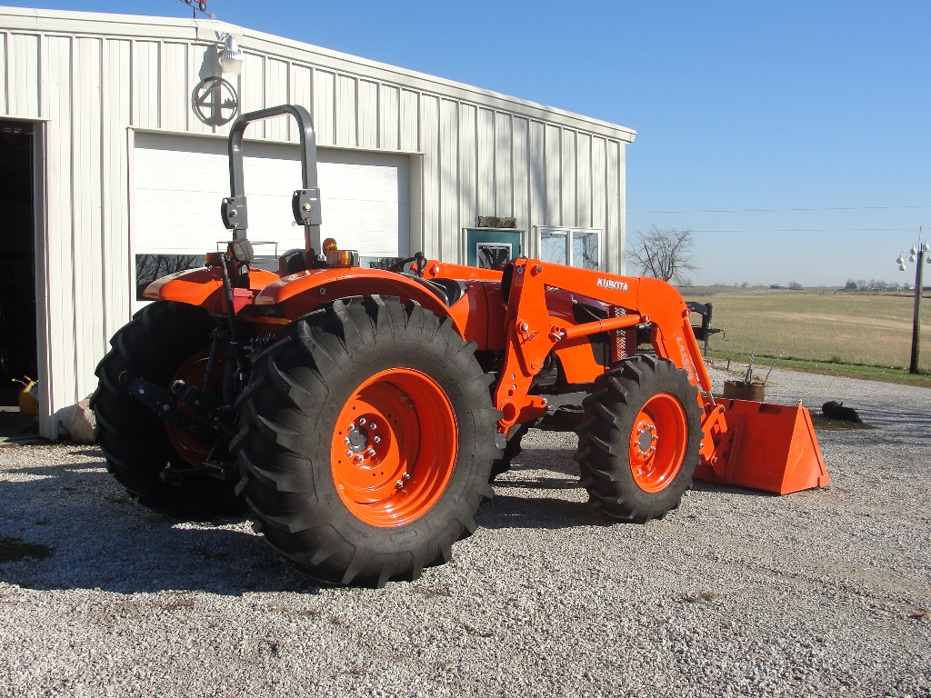

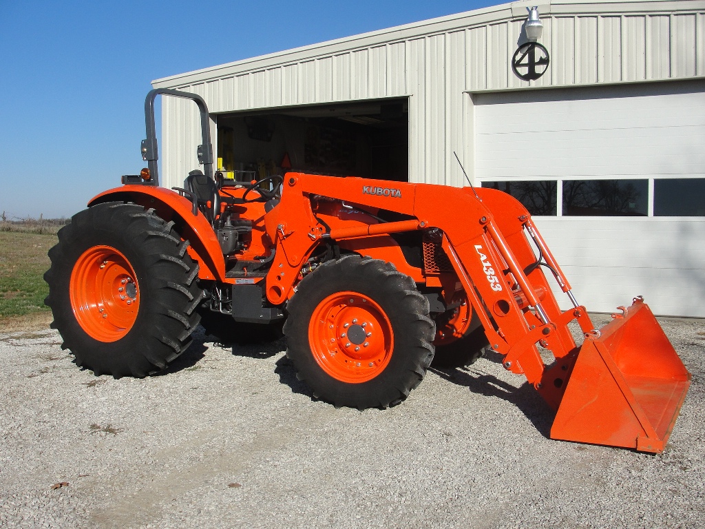

What does your tractor do now when driven in a straight line in 4wd?? Your info doesn't list a particular 4wd tractor.
If you install a size smaller on the rear the tractor will "pull". The fronts will slightly spin while driving forward in a straight line.
If you install a size larger on the rear the tractor will "push". The fronts will scoot on the ground as the rears push them along when driving forward in a straight line.
Either situation is very hard on driveline and tires.
My Kubota slightly pulls. It will turn shorter in 4wd without pushing the fronts.
My Ford is neutral, easily clicks into/out of 4wd while driving straight forward. It doesn't like to turn short and will push the fronts.

I believe the next size bigger for you will be 18.4x30. Here's an example of what they look like when compared to a 12.4x24.
