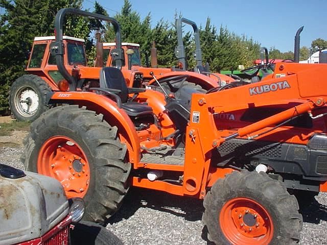

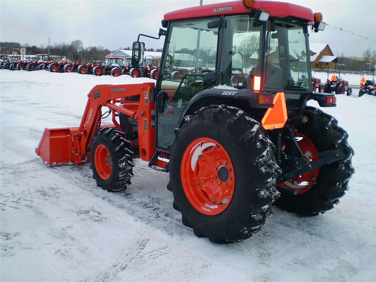

I pulled the first two pics from Tractorhouse.
Although I don't know if they are the taller of the two available tires for the 5030, it looks to me like there is room for chains as long as you don't leave too much slack in them. I have double-ring chains on my tractor, and I have about the same clearance between my fenders & the tops of the tires (R-1's). Hope these help..
