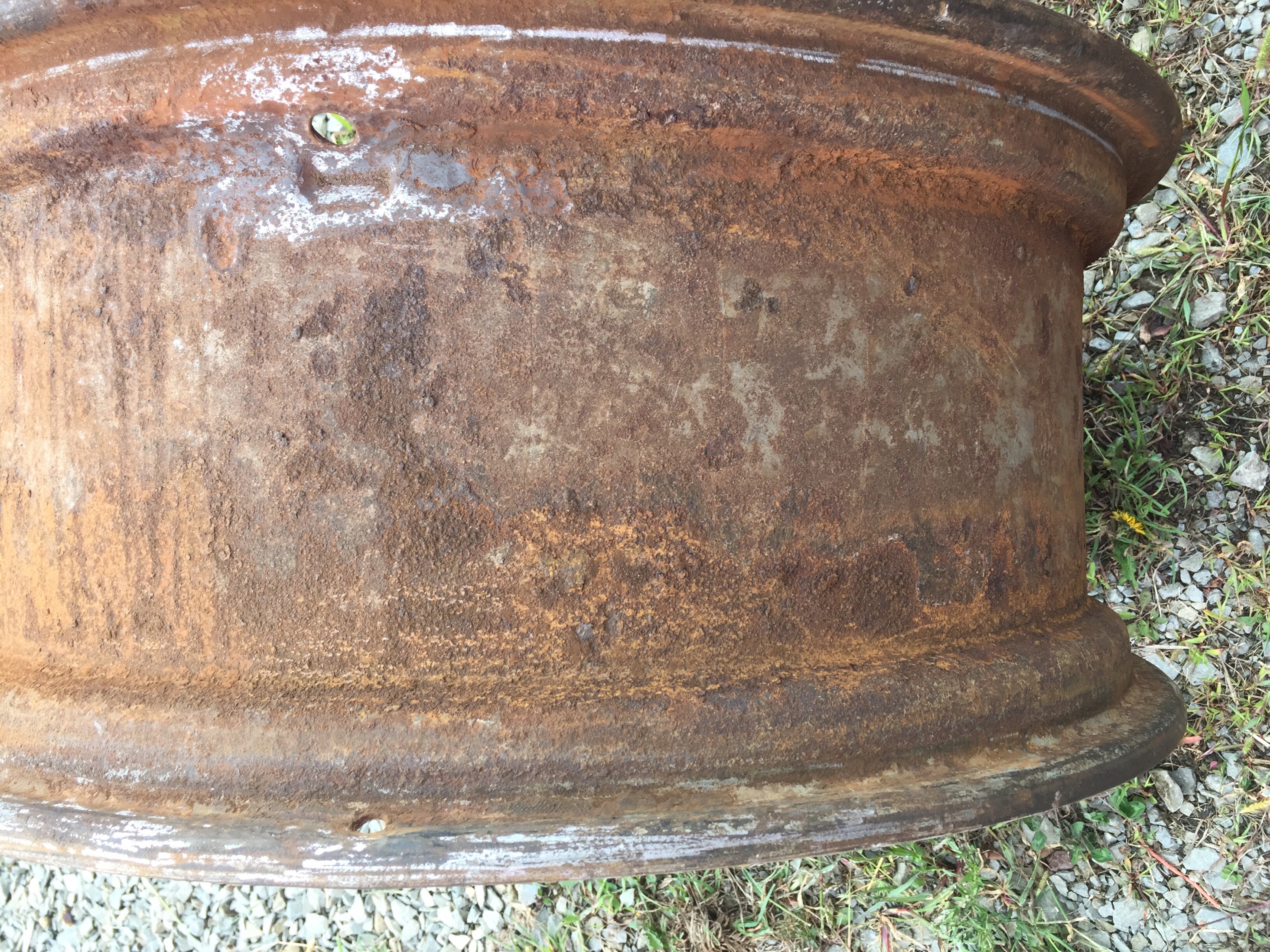

I only use the old 961 about 10-12 hours a year doing some brush hogging and general work.
One thing I've wanted to do since I bought the tractor about 7 years ago was to get the calcium out of the tires. I had it out brush hogging the other day and saw the valve stem looked damp on one of the tires and I knew it was time. Funny thing is, I just put new cores in the valve stems about 8 months ago.

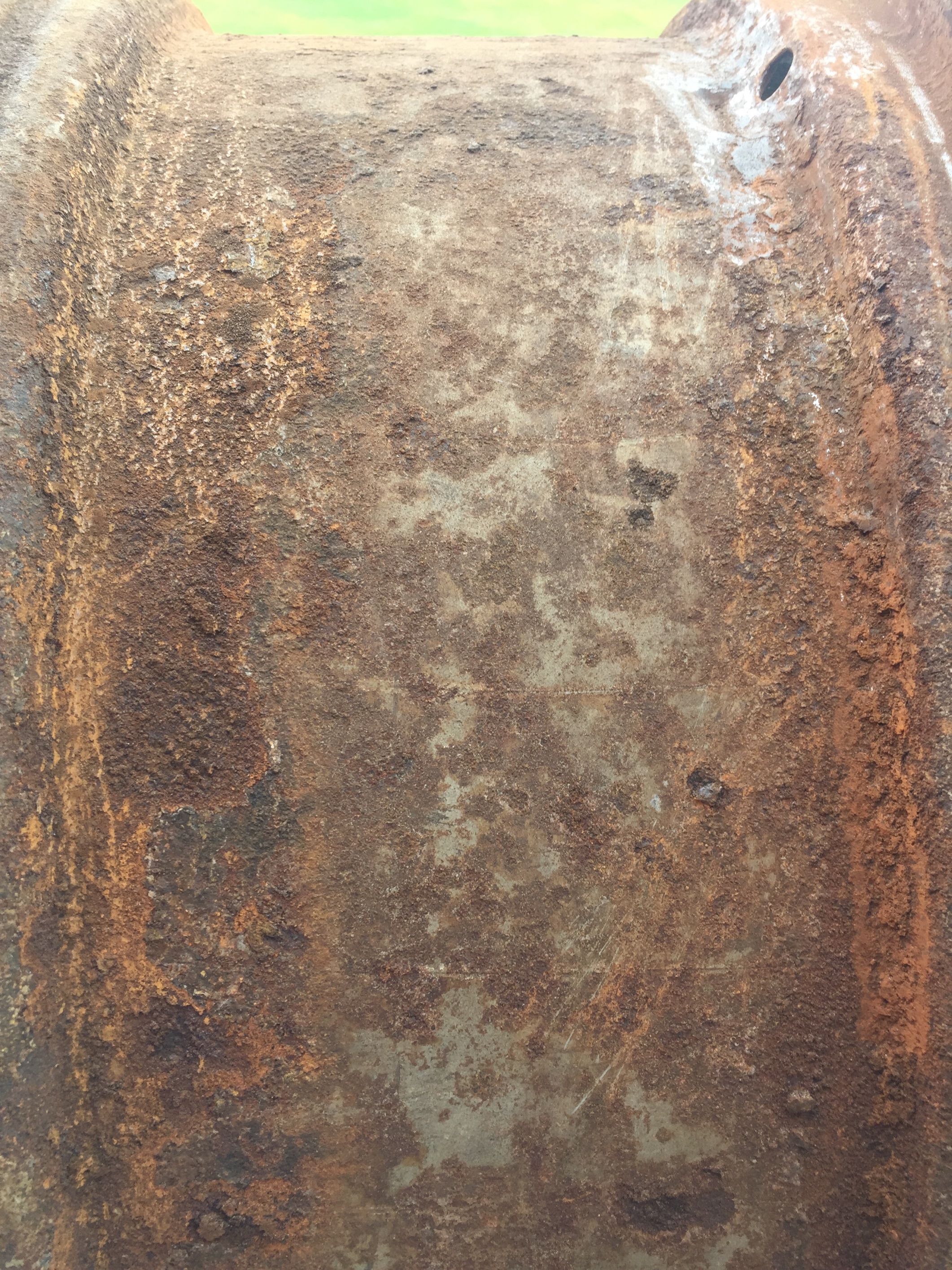

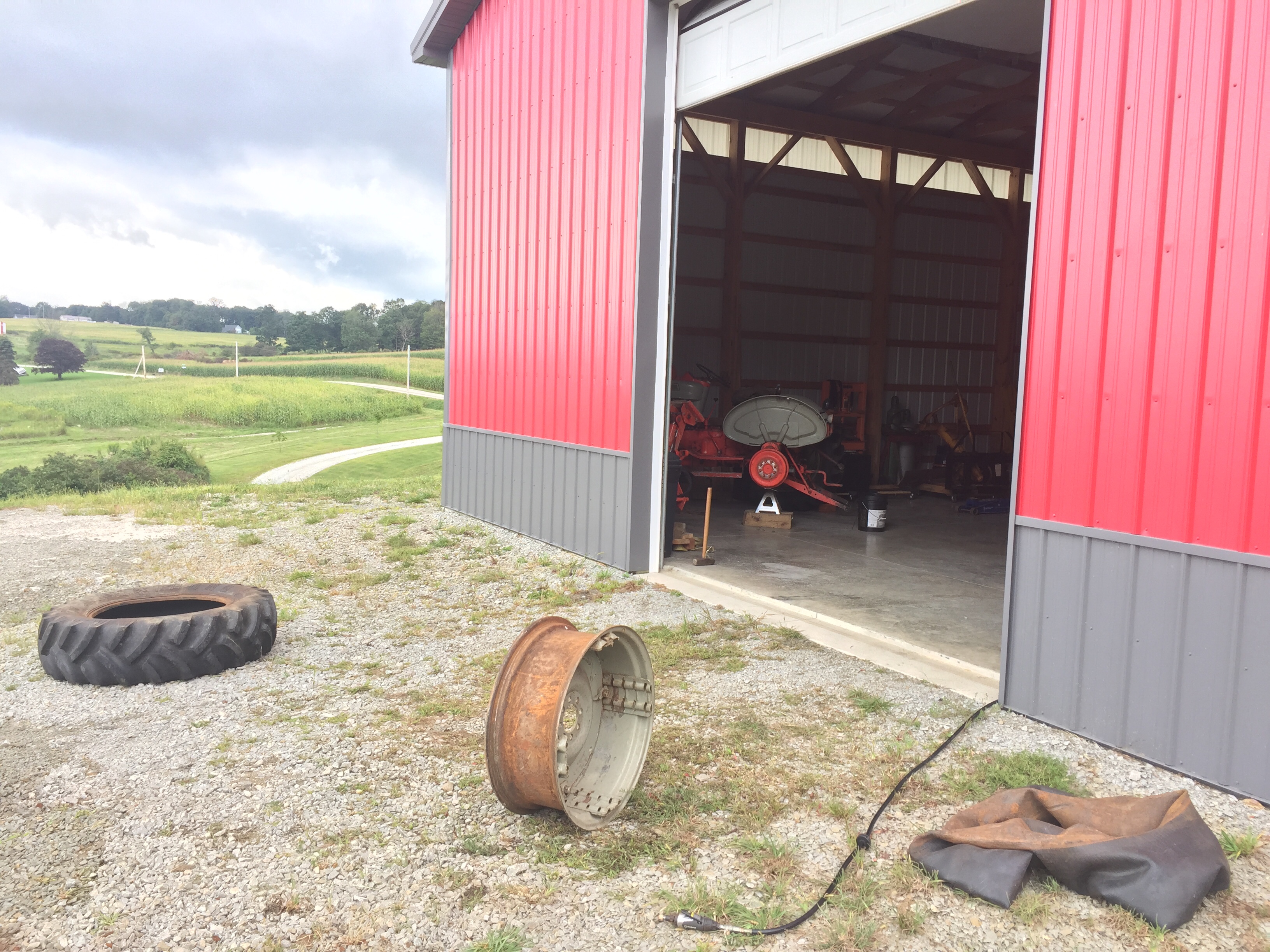

So today I drained the calcium out, pulled the inner tube, and then popped the tire off so I could clean and repaint the rim. The rim had some rust but luckily all solid metal everywhere. The rust was the worst around the valve stem. Tomorrow I'll get the rim cleaned up and a good coat of primer on it and maybe a coat of paint.

I highly recommend using rust converter AFTER you clean as much off as possible. Rustolum and similar primers are not intended to remedy rust that bad. The best converter I've found is Jasco but there's others.
   / Tire/rim tear down
I was able to get 99% of the rust off with a few different shape/size wire wheels and cups on my angle grinder. It actually cleaned up very nice but I forgot to get a picture before priming. After grinding I washed the entire rim with a detergent solution and once it dried in the sun rinsed and wiped it all down with brake cleaner. Sprayed one coat so far of rust converting primer, can't remember the brand right now but I've used it previously and it has worked very well. Probably going to do two coats of primer, one coat of paint, and a coat of rubberized undercoating. Mainly using the undercoating to fill in the small pitting and because I've had it laying around so might as well use it up.
   / Tire/rim tear down #6
The BEST fix for those rims is complete sandblasting, and two (or more) coats of marine 2 part epoxy paint.
