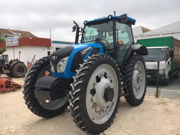

Wondering what the tire ratio front to rear is on this one. :)
   / Tire ratio front to rear #9
I'd say just about a perfect 1 to 1.
I'd add a few percent making the front do the pulling to aid in steering ability....perventing the rear from pushing the front around interfering with steering ability. On the subject, I was out in the snow yesterday with my new LS and tested the ratio. I kept the R4s on the front but changed the rears to R!s and wanted to see how my match went. As close to perfect as one could imagine, even in mild turns. In tight turns I could see a slight blur of the snow but that could have just been the angle at which the lugs were meeting the snow and providing traction.
