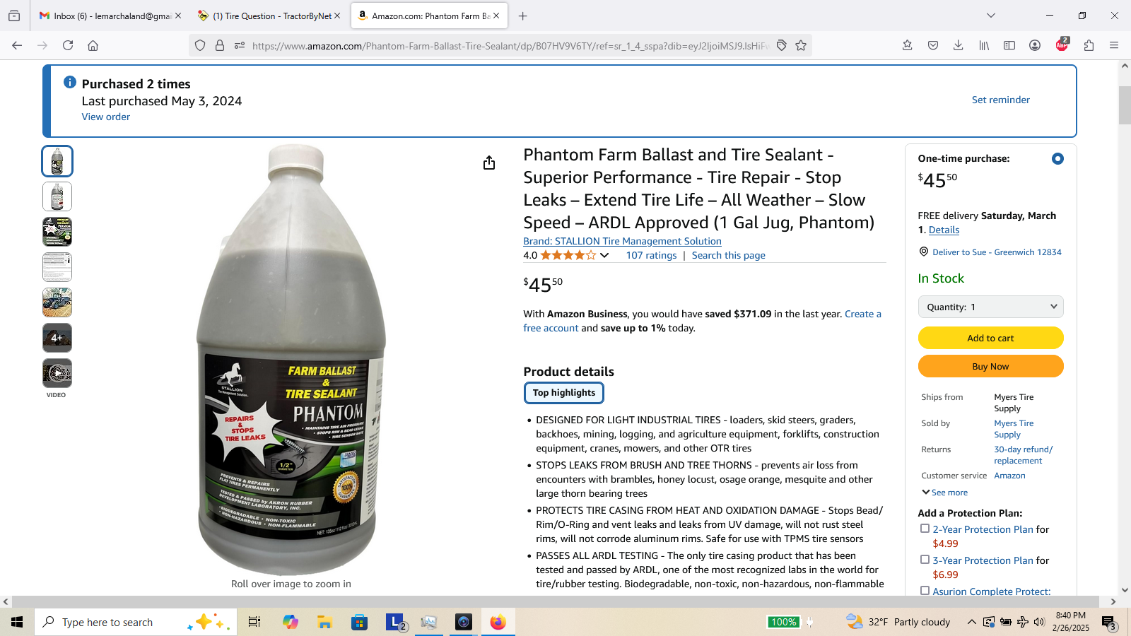

Or add a stop leak product;
I've had good results with this in older tires,

Slime, Foam Filling, Tubes can all be viable options.
I’ve had good luck with all of the above.
First check that the valve core isn’t leaking and no punctures.

20 years, same tires... will need to replace as they are wearing out. Within 4 hours of owning the tractor, I ran over a 2x4 that had 4 nails coming out of it.
Great, used slime and that lasted 10-ish years but always had to "top-off" with air. Finally, put a tube in. Works great but it was a royal PITA to clean out the 10 year old slime.
I would NOT recommend slime... I had a lawn mower where the tire with slime had exploded!!!
   / Tire Question #7
Many don’t like slime… especially tire shops.
I had a wheelbarrow that was always flat and in 2010 slimed it… no problems so far… your mileage may vary.
