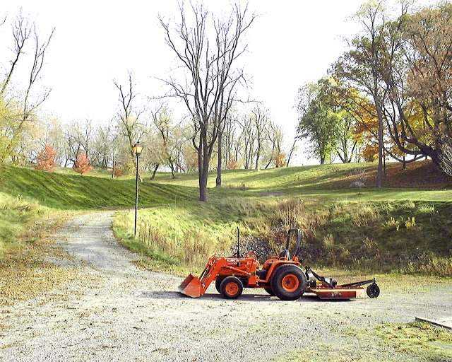

   / Tire question w/ a new "slant" #10
Re: Tire question w/ a new \"slant\"
Leef,
I think you will be fine with the tires loaded. I had a B8200HST with turfs that were not loaded, and it would cut fine on some big slopes. (see photo attached) With my B2710 with loaded turfs I can't believe how much more stable it is on slopes! I don't have to use 4WD have as much as before. Load the tires and remove the loader first and see if you notice a difference. I would lose the MMM as well so as not to damage it on something hiding in the tall grass.
