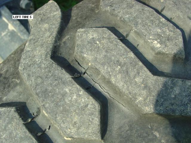

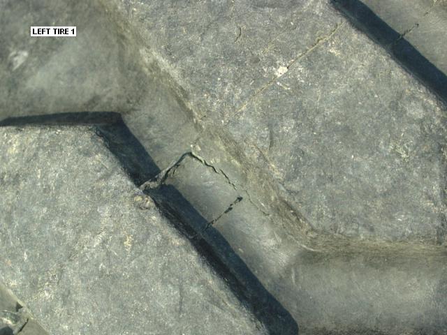

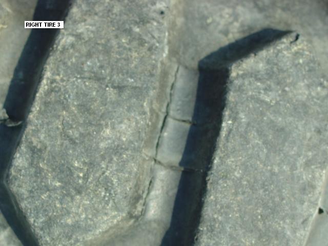

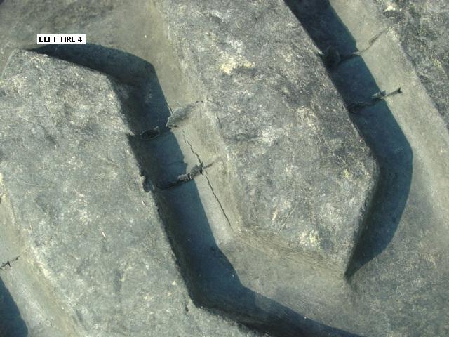

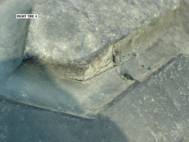

Hey Guys,
I just noticed this today, and haven't talked to my dealer yet (Holiday). I have separation of several lugs on each of the front tires, some worse than others. Is this normal, or should I be concerned about a tire failure in the near future? The tractor has 142 hours and is a year and a half old. Should this be covered under warranty?
Thanks,
Joe

Take it to the tire company, not Mahindra. It is either a Carlilse or a Titan, they would determine if it is defective.

No way you're leaving us hanging like this. What did they say???!!??

They are Titan tires, and so far I've had no hassle what so ever. Tuesday morning I contacted my Mahindra dealer and he recommend I contact Titan Tire directly. After speaking with the manufactures warranty dept. and a dealer here in town Wednesday, I emailed both of them photos of the tires. Today I received a phone call from the tire dealer and was told he just got off the phone with Titan and a new set of tires were on there way.
Here are the photos I sent them.

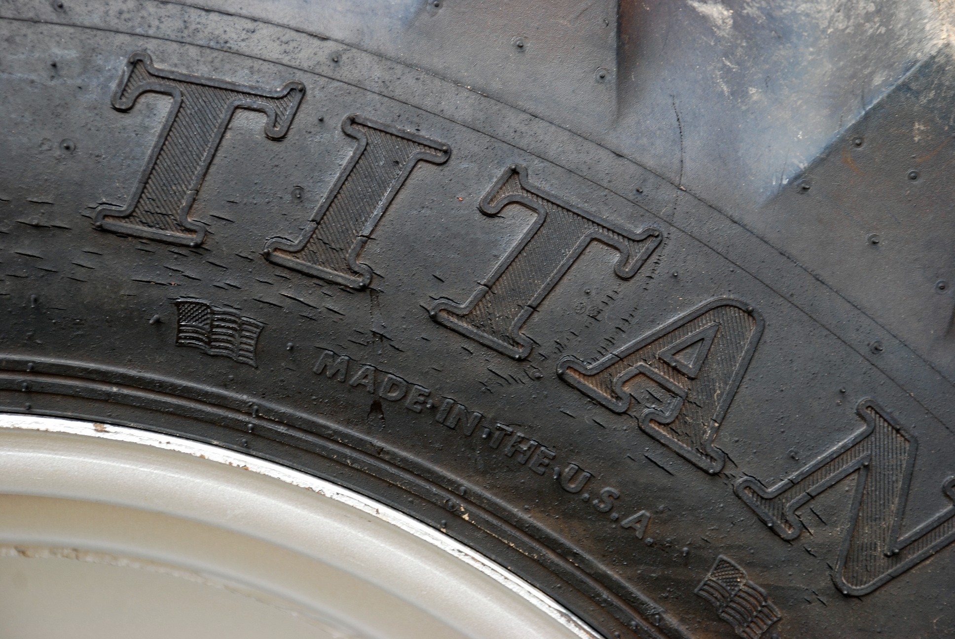

I wish I had that easy of a time. I had a side wall issue. Tires are less than a year old and they look like they are 10 years old.

Willl said:
Sun damage ?
From what I have gathered from the Titan dealer, it seems the they have forgotten to add some chemical to the rubber. THis makes the tires highly succeptaple to premature dry rot/weather cracking.
