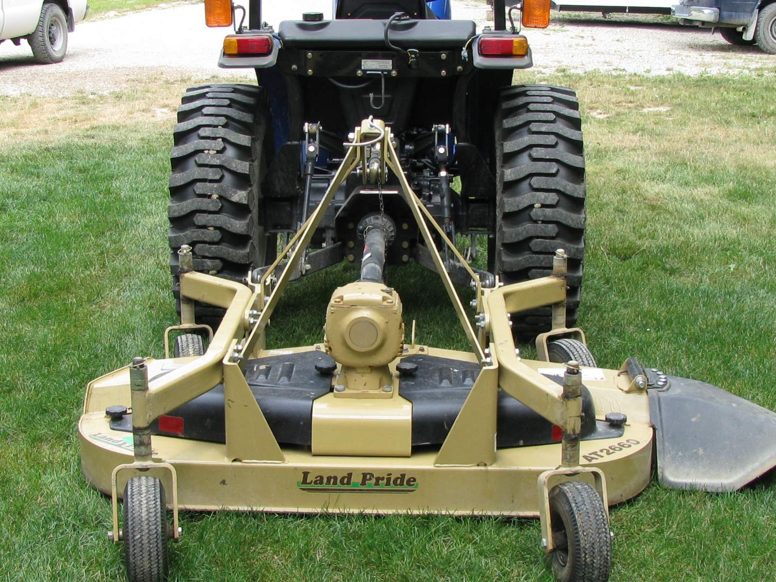

Just wondering if anyone has actually worn out a set of tires on their CUT. I have around 465 hrs on my Titan R4's and can barely see any wear. I operate primarily on the grass with some gravel road going between properties. The rear's are 10 ply and the fronts 6 ply. I don't think I'll ever actually wear them out.

I figured they would start falling apart before they actually wore out. It stays in the garage so they don't get dried out from the sun, maybe I'll get 30 yrs out of them as well.:)
