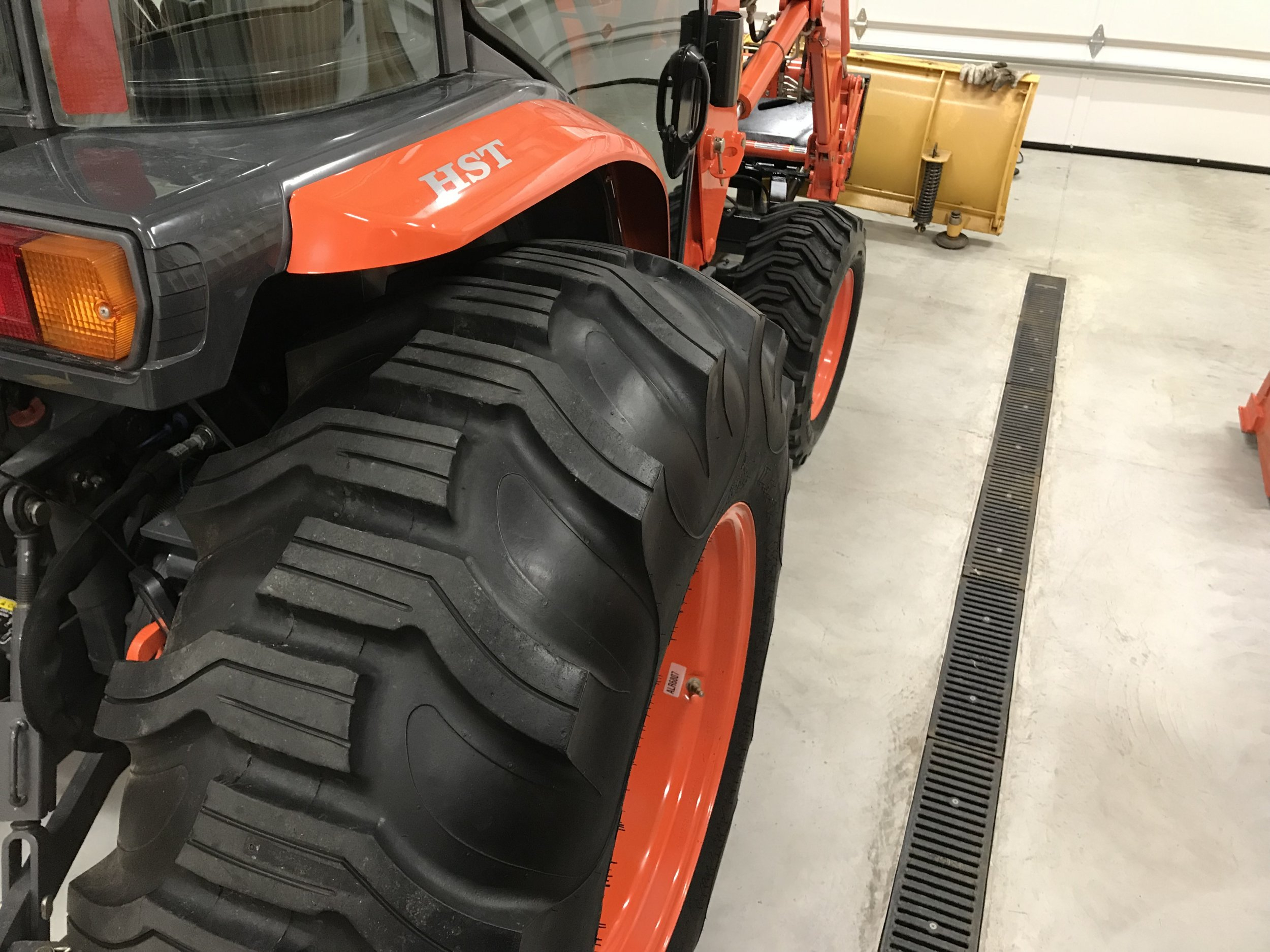

   / Tire Groover; borrow/rent/sell me one? #8
You will indeed be happy.
