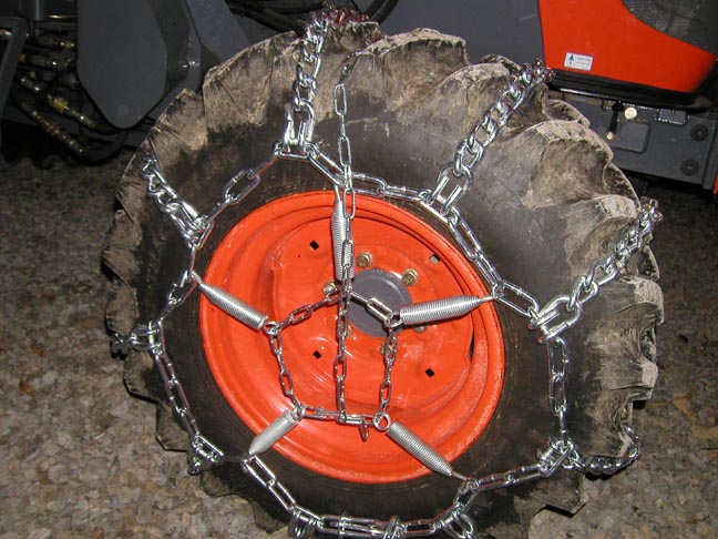

Tire chains have been a fairly hot topic on this site. There have been lots of discussion as to what tires (front or back) they should be on, two link or four, will it ruin your 4WD system, who to get from, etc. I have posted a pic of the chains I bought from Tirechain.com. They were easy to put on, no snow here so don't know if they will bump me to pieces when I go to use them.:rolleyes:
Mornin Oleozz,
My chains are quite similar to yours other than your center springs, I have a couple of rubber bungee cords on each tire and I get bounced around pretty good on frozen ground ! I kind of wish I had bought the skidder style chains.
