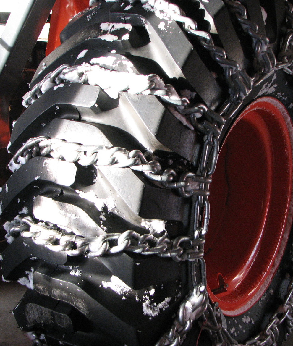

I have the R4s with 2 link ladders from tirechain.com, I don't have fluid in my rear tires, so I jack up the back, let all the air out of my tires, hook up the chains, then put about 16 psi of air back in. Chains are real tight, and they don't slip around.

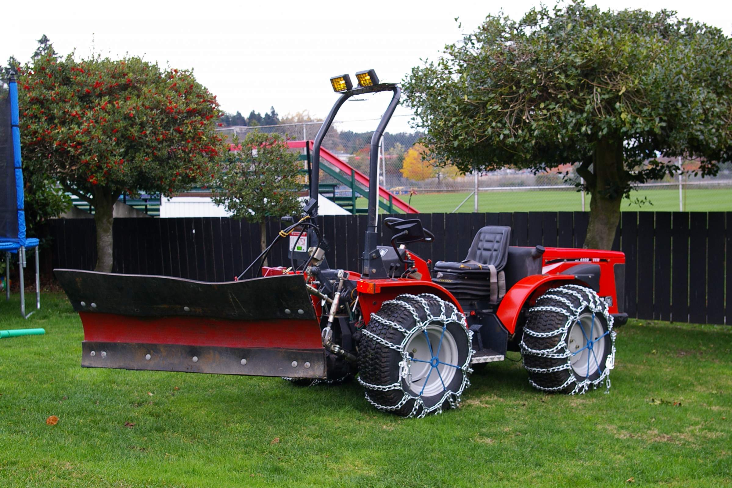

got my chains from tire chains .com got he octupus bungies from kal tire
