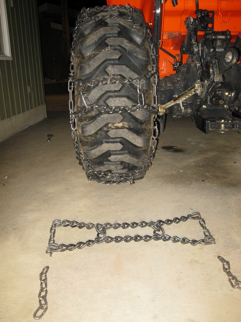

Standard DUO's are patchy and rough for the wide, small diameter 43x16-20 tires. I had 7 patterns of 13-link cross chains. They were patchy and rough riding. I modified them by adding 4 patterns (for a total of 11) to each chain as shown in this thread:
http://www.tractorbynet.com/forums/attachments/268885-duo-chains-planned-modifications.html
I fill the end gap with two standard non_DUO cross chains to each chain. I could use one more DUO pattern but would have to modify it since the total chain would be a bit too long. If the cross chains were 12 links instead of my 13 links the total of twelve 12-link patterns on each side would likely be ideal.

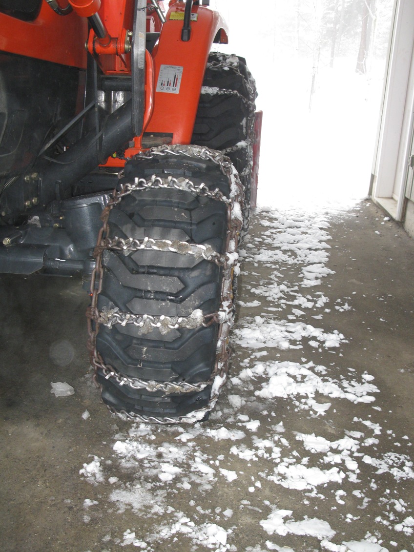

It looks like the chains for the 43x16-20, #1073010, have 15 links in the cross chain, which would likely provide poor coverage for your tire. There would be a lot of tire without chain on it. Here is a photo of my first set, which also had a 15-link cross chain:
Also, the item #1073010 chains appear to have the DUO pattern legs with 6-link spacing on the side chain instead of the usual 4th links. That would add more area to the part of the tire not covered by chain. I don't think you would be happy with that chain. I did not like my DUO's(where the DUO legs at 4 link intervals) until I tightened up the pattern by eliminating the link between separate DUO patterns.
