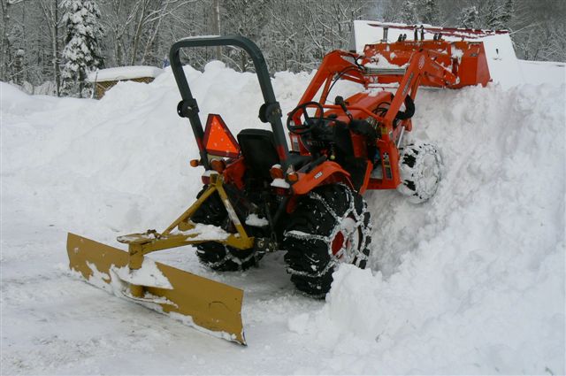

I have v-bar 4 link chains from the same place on my rear tires and 2 link v-bars on my front tires. The 2 link chains give better traction and a smoother ride but they cost more.
They work very well and allow you to go anywhere and you never have to worry about your tractor sliding sideways on a slope:eek:
I had to reverse my front wheels in order to have enough room for the chains to move around but the rear wheels were fine. You should check with your dealer as to the clearance on the L3400.
I hate putting my chains on my tractor. After researching many of the past posts on chains here on TBN I found the easiest way to put chains on. Place a bunjie cord on top of the tire and have it hold the front of the chain in place and then drive the tractor forward. It's still a pain but this method makes it much easier.
The attached picture illustrates how chains improve traction
