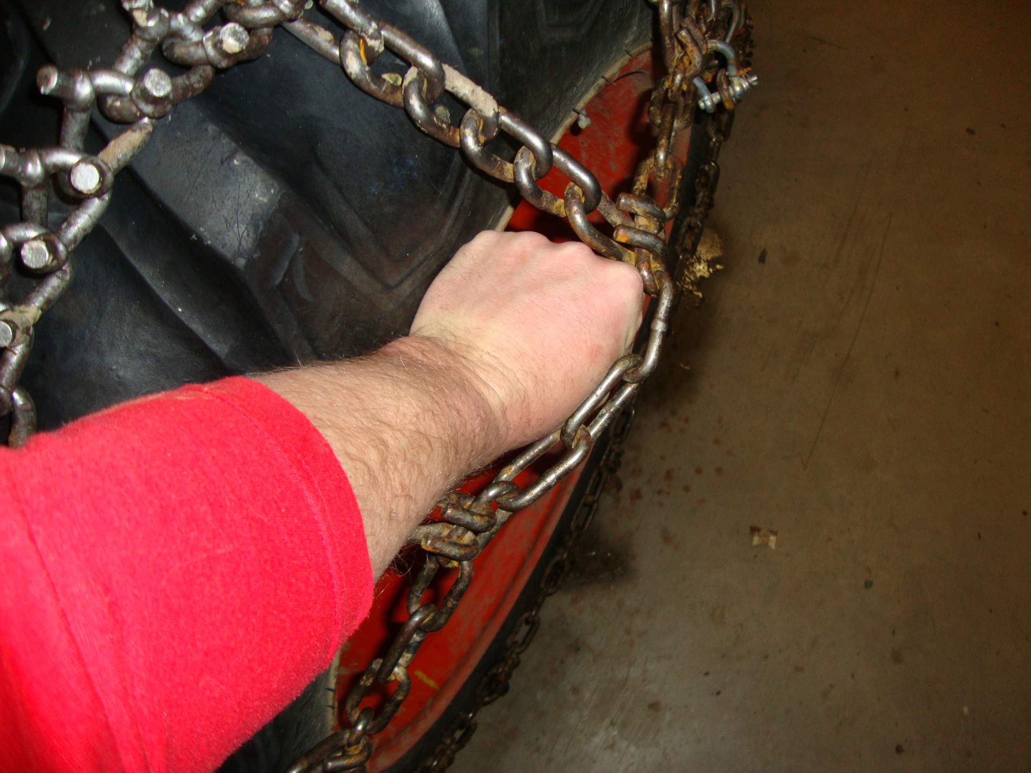

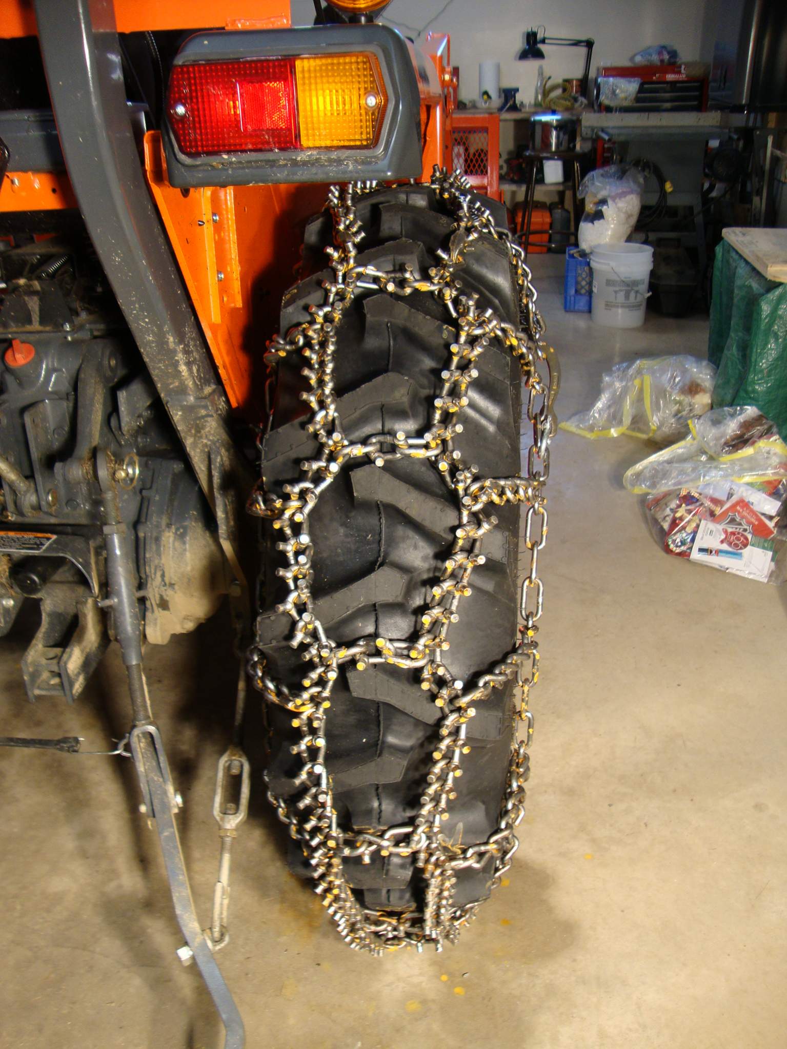

You may have seen these already and discounted them but in case you havent and you need an aggressive chain you cant beat these. They are made in Norway by Tellefsdal. I think Aquiline is the same. They come 8 mm (5/16") and 10 mm (3/8" +). Mine are the 8 mm ones.

I have not run them much in real soupy deep mud so I cant say there, But if you have just a slick slimmy surface layer they are great. Tellefsdal is the one who recomends that you should be able to place your balled up fist between the tire sidewall and the chain. I got mine thru my tractor dealer.

I got mine from the dealer as well, mine are Tellefsdal, the same as Gordon's.
Simply the best tire chains I've ever seen, the grip is very good on ice, snow, pretty much whatever. Also very smooth running on pavement, provided you run them loose as Tellefsdal suggests. I've never had them come off, it's virtually impossible if they're sized right.
I think Whistlepig has the Aquiline Talons, very similar to ours.
They're not cheap, mine were $550 Cdn a couple years ago.
