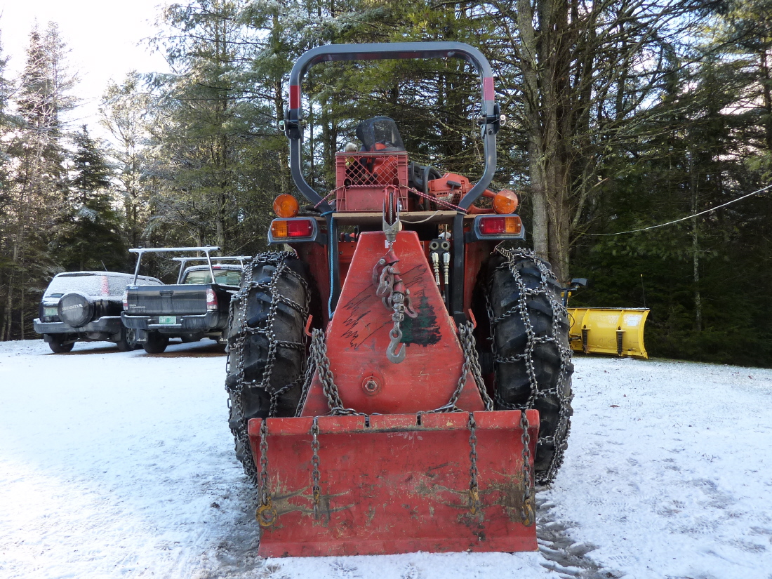

I bought mine in 2005 from Desmarais Equipment in Orleans for $365. It was the best price I could find anywhere. They are made in Norway by Tellefsdal. My tires are 12.4 X 24 Ags. Prices and suppliers change but I would give them a call. Ask for Andy at extension 105. You cannot beat these chains.
those look like some quality chains.
