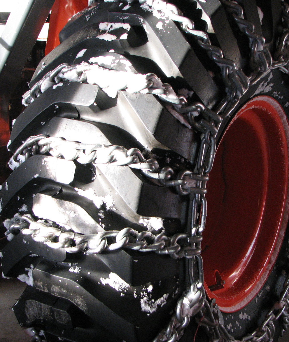

For the past 4 years I've been using the 2-Link Ladder on my B7800 when I snowblow.
My first concern was not to screw up the cement floor in my garage and 2 link Ladder
work very well for that.
While snowblowing, on very rare occasions I have had to engage the differ. lock when backing up small icy hills. My B7800 is not very heavy, I have no loader and there is no liquid in my tires, but I've never got stuck, and have always been able to snowblow my
driveway and my neighbors hilly driveway.

The ladder type will not hide out between the treads. Especially if you don't put them on so tight they can't walk around a bit, and don't put on tighteners. But you do what makes you feel most comfortable. :)
I have R-4's and use the ladder type, and most of the time, leave them off. But they for certain do not stay between the treads. :) Mostly just need them for the slippery slush underneath a wet snow. When all is below freezing, not much need for chains.
I use chains on all fours for deep snow and working in the woods.

I just put a set of 2 link ladder chains on my JD, and it has R4 tires. The ladder chans are quite large and do not hide between the treads. I have chains on all 4 now, wished I done it a long time ago.
