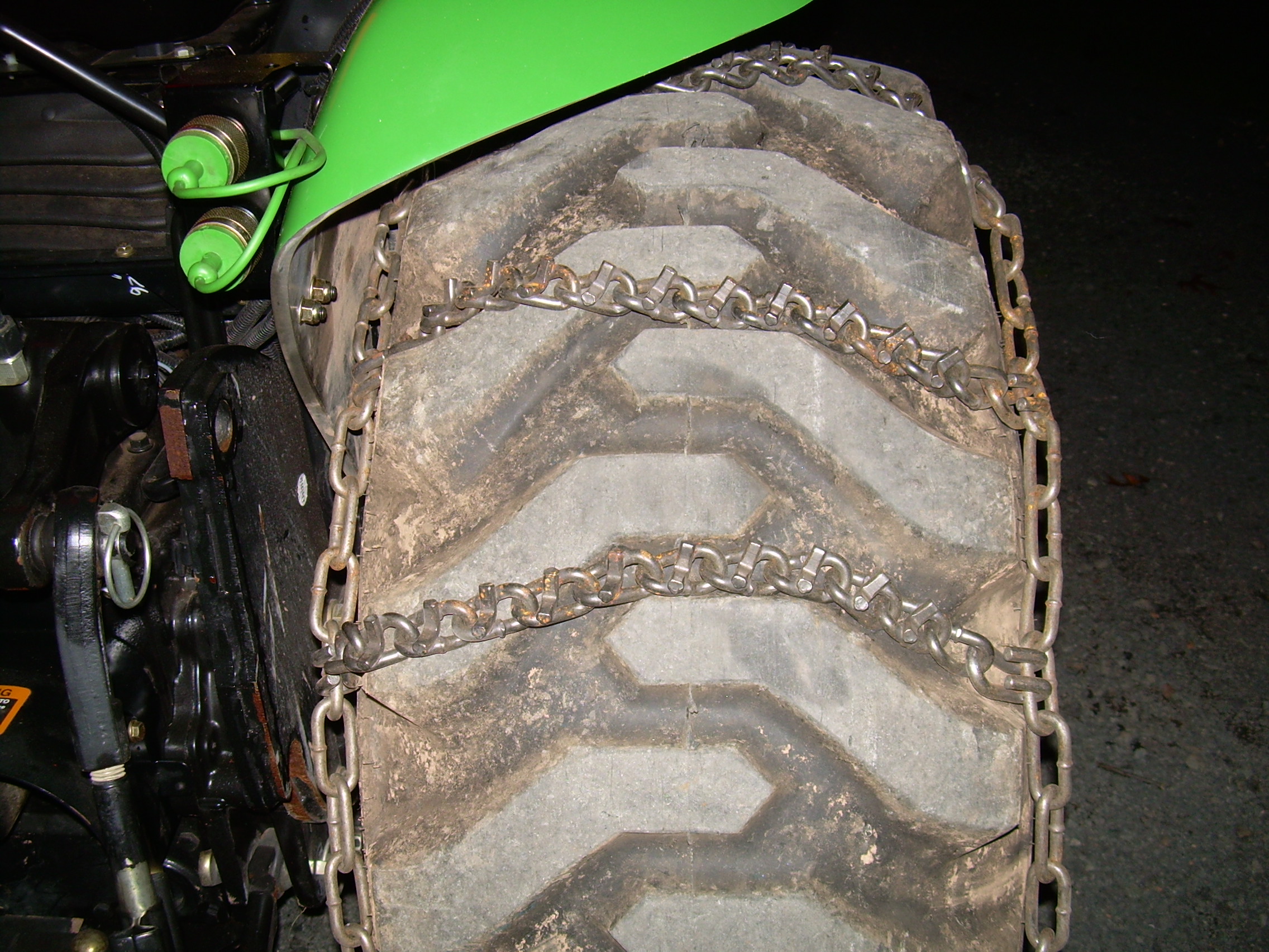

Hi Guys, Need a little help here. The first significant snow of the season and I did it again! Pushed the snow too far over the bank, and couldn't back out. The heavy, wet snow immediatly turned to ice under the tires and bucket pushing with diff lock were not effective, as I had ZERO traction. So, once again, dig out the Come-Along and 50' of straps,etc.. When pushing with the bucket, the front tires are up and the rears are planted, but they just zing on the ice. I think rear chains would make life so much easier. I put rear chains on my old tractor, a 1952 Farmall Super C, (great old brute) but the cross links just dropped between the lugs and were ineffective. I'm looking for chains with the cross links connected on the tread to keep the chain between the tire and the ice. The problem is that I can't seem to find them to fit the 15x19.5 R-4 tires on my JD4310. Any leads would be appreciated. Thanks, Greg.

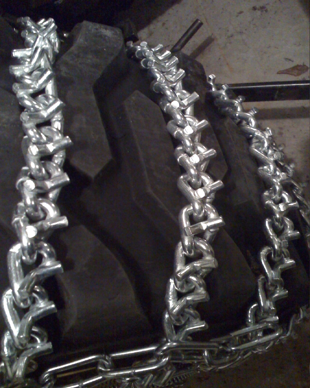

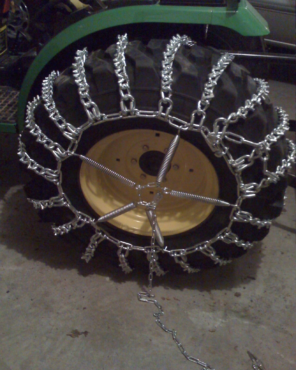

You wont get stuck with these, just posted these pics in another chain thread. I have a 4310 with the same tires (I assume) and yeah some of the chain falls in the lugs but even with 4 link spacing the tractor becomes a bulldozer with no tire slipping/traction problems what so ever.
Go with the 2 link spacing, even better.
You do have to flip the rims for clearance inside the fenders though.

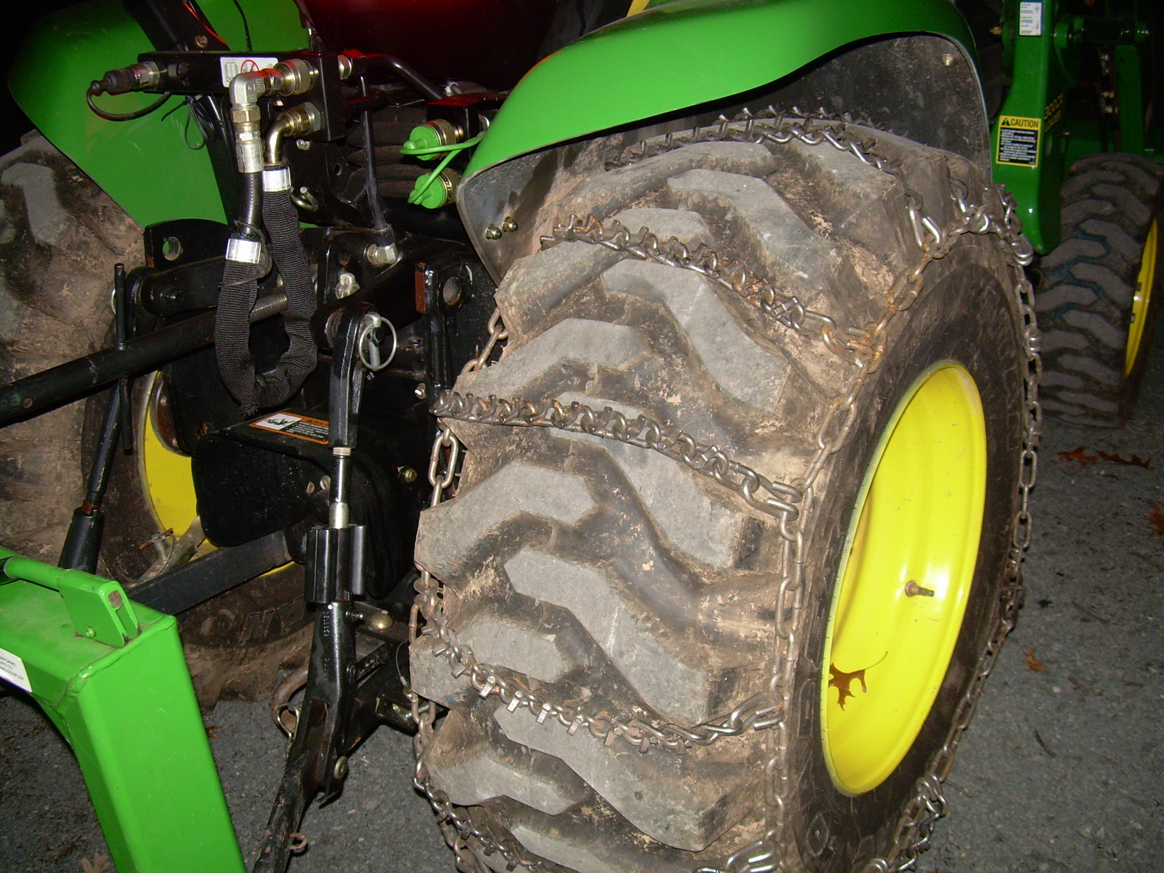

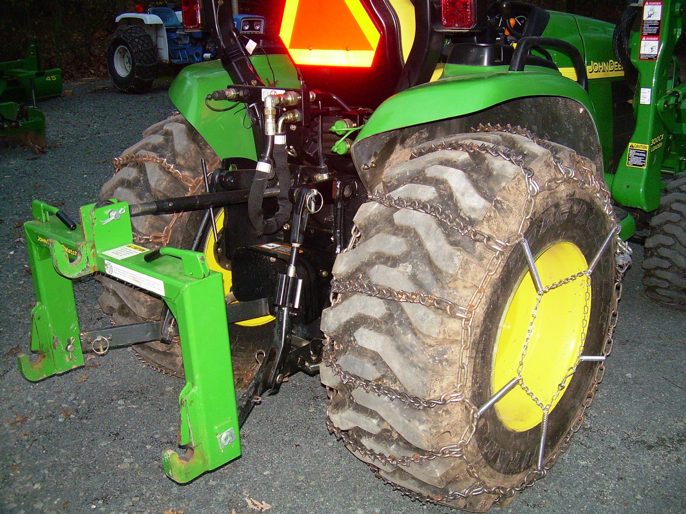

I have the exact chain set-up as jb4310 with a logging winch on in the winter. It has no problem in the woods at all. got them at the JD dealer I think about $200 for the rear set
   / Tire chains for ice?? #6
these work GREAT for me on ice!!!!!:cool:
