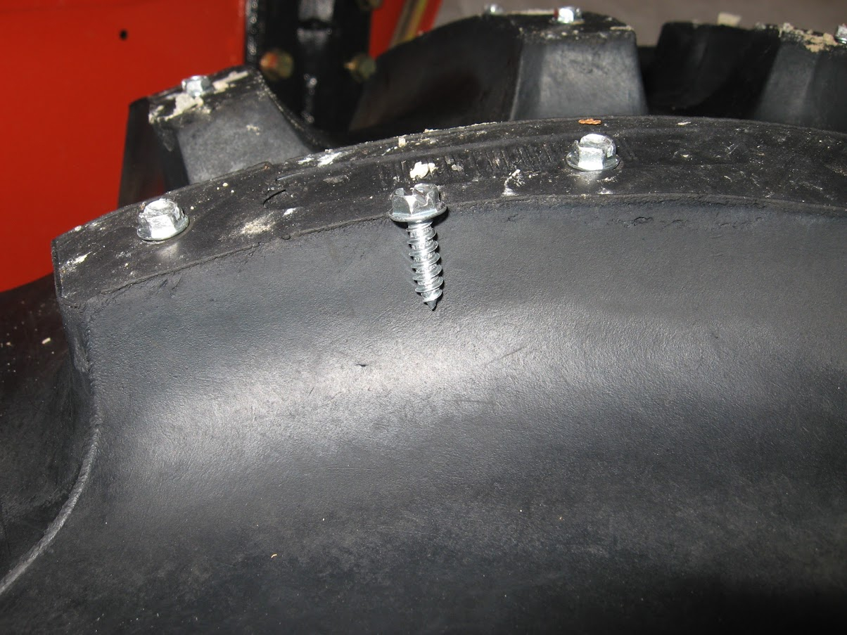

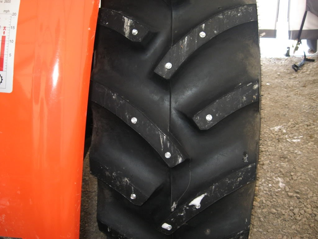

Do you have any slope on your driveway? My tractor probably wouldn't pull up my 7-8% grade hill on ice with just the fronts chained and a 7' blower on the back. Or it would be spinning a lot. If you only do one end, usually its the rears, and you can steer with the brakes.
I also just stud my tires with shorter hex head screws if we get enough ice to bother with it, works quite well and is pretty fast to zip in with the drill, then I do all 4 just for reducing spinning and sliding.

Thanks for the screw suggestion I never considered that although it brought back a 60 year old memory we used to do that to out dirt bike tires in the winter to go tear up frozen ponds, those were the days. What length screws do you use?
I think ~3/4" in the rears and smaller in the fronts, well short of the lug depth anyways! I wouldn't use these in the woods in the winter as spinning and gripping one on a root would probably rip it out, but they seem to stay in very well on gravel and ice. It's best to put them in when the tire is warmer but I have put them in, in -5C as the driveway was pure ice!
I'm still using the same screws since 2012, as they hardly wear, as I think these are self tappers and so are hardened a bit. These are the rear ones. I just set the cordless drill to a low torque on the slip clutch and zip them in.
This spring I missed a couple taking them out and did a couple miles of paved road and it still didn't seem to wear them much at all?
In 4wd I can drive on pure ice on a 7-8% grade, even while dragging my Neon to the top of the hill with the parking brake on...:LOL:
