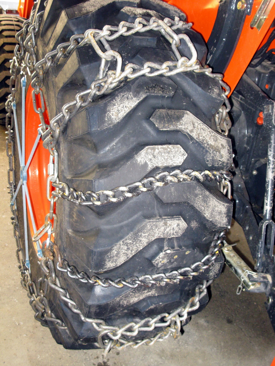

The photos show additions made to the DUO239's. The spacing between the DUO239 patterns was about 3 lugs. The blank space was 8 lugs which adding cross chains reduced to 3.

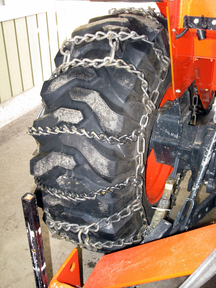

Another photo shows the small clearance to the fender support. The chains don't hit the support and the chipping is from the tails hitting when I did not properly secure them. A 5/16" quick link (threaded link) protrudes slightly more than the cross chain grab links, so I used a 1/4" laplink.
The poor clearance is at the worst spot. Even with the present poor installation the chains do not hit the fender support. I can improve it by hammering the crosschain grab link flatter. Also, the chains are mounted crooked because I simply let them down and pullled them back up to work on them. Reinstalling straighter will move the inner side chain a bit higher and provide more clearance. Even with the present poor installation the chains do not hit the fender support.

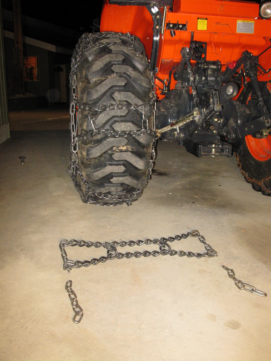

It has been a struggle to get this far. A local supplier built a first set of chains after I sent him the Titan data for my 43x16-20 tires. He built chains using 8 patterns of DUO297 cross chains 26.75" (14 links) long. They were much too large. They had five lugs between patterns, and after removing one pattern were still too long (photo attached).

I am sure the DUO242 with 8 patterns of 22" would have been exactly right. Instead of an 8 lug gap it would have been the correct size with a denser overall pattern of around 2 to 2.5 lugs instead of 3. They would ride slightly higher on the sidewall giving me more clearance from the inside grablinks.
So that's how I ended up filling in DUO239's. It has smoothed out the ride. As Destructo_d mentions, they can be smoothed further by adding crosslink between the DUO patterns. Tirechains.com sell these as DUO Ladder chains (photo attached).
If I was doing it over, I would be inclined to go with something like the Trygg Safety Grip (photo attached) or two link ladder chains--but the DUO's will work.
