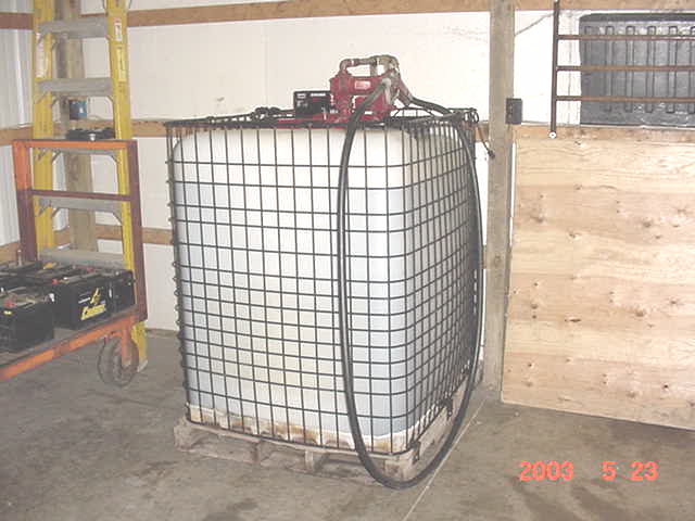

Local fuel dealer will sell 55g drums for $20. I'm thinking something square with fork pockets in it 12V electric pump with 10 micron + water filters in line. Local Fleet Farm has white box with chain loops on top no fork pockets but cautions against moving full tank.

Barry........Attached is a picture of my shop fueling setup (diesel) . My fuel distributor gets fuel additives and oil in these large plastic totes. Mine happens to be a 320 gallon model , but these totes are made in various sizes and are made with fork pockets or skid mounted. The going price for these totes around here is $50- $75..............I know they make them in a smaller;....approx 100-150 gallon size too..........I made a top bracket to mount my elec. pump (12V) and also a fill opening. The pump is a gasboy/tuthill style like they sell at TSC or northern..........Tom

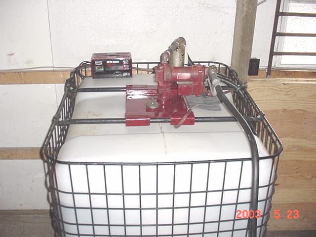

Close-up of pump and water separating fuel filter.

A number of those pumps are product specific. Meaning that gas or diesal will eat out the seals and other parts in no time if it not specifically made for hydrocarbons. I have a backpack sprayer that I tried a combination of water diesal and embutox. It worked fine untill the next time I wanted to use it and then everything was dripping down the back of my pants.
