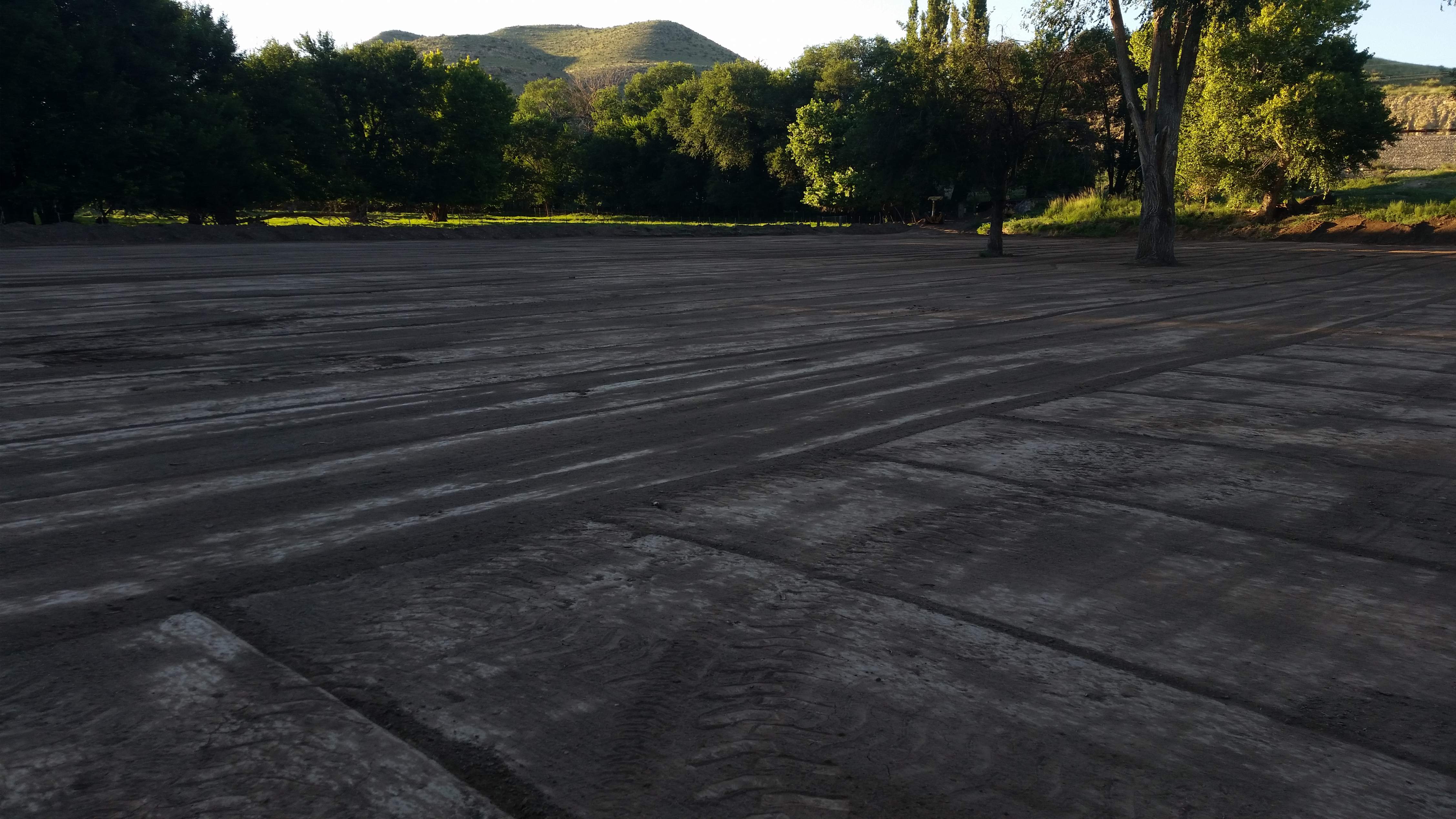

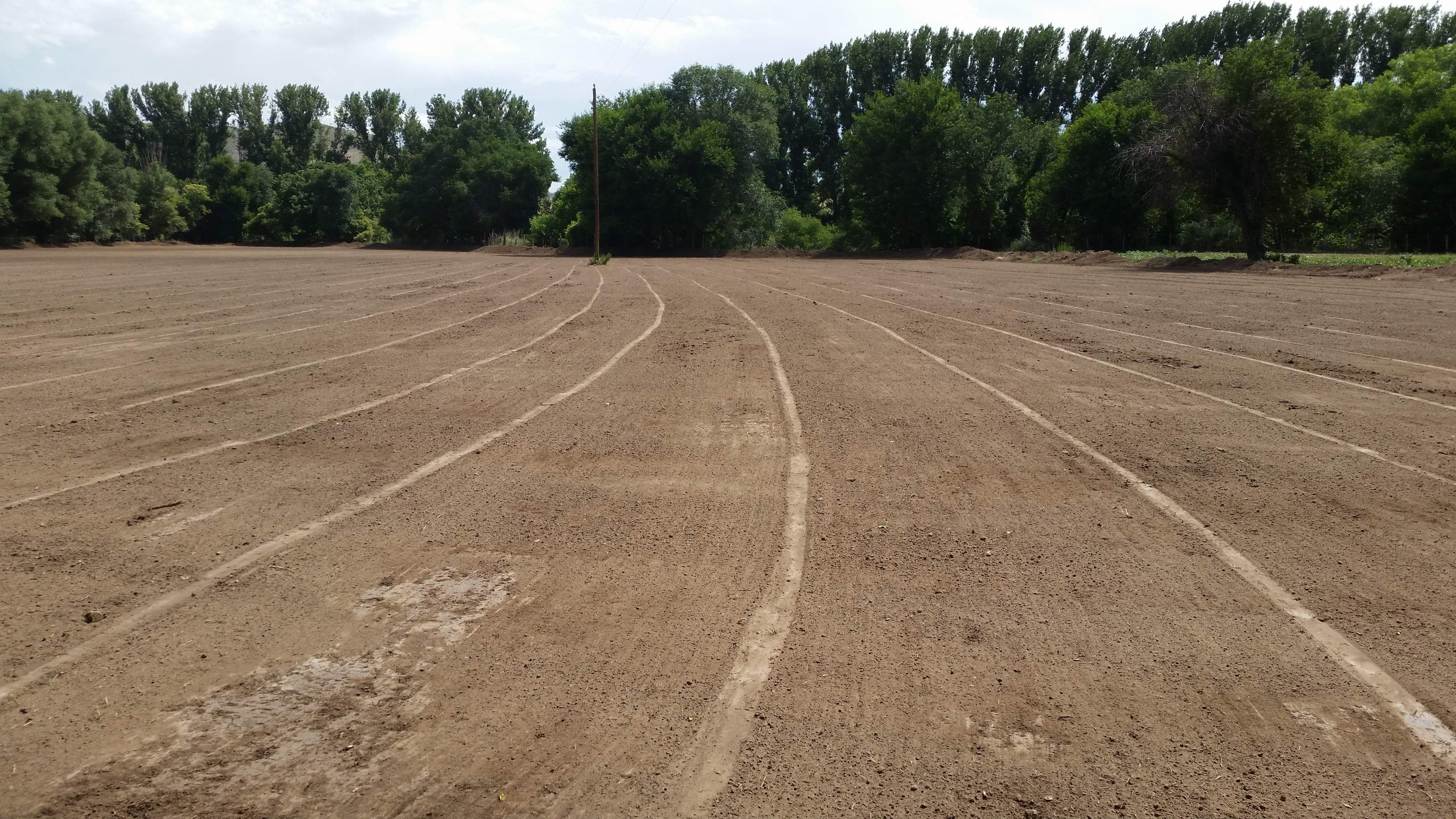

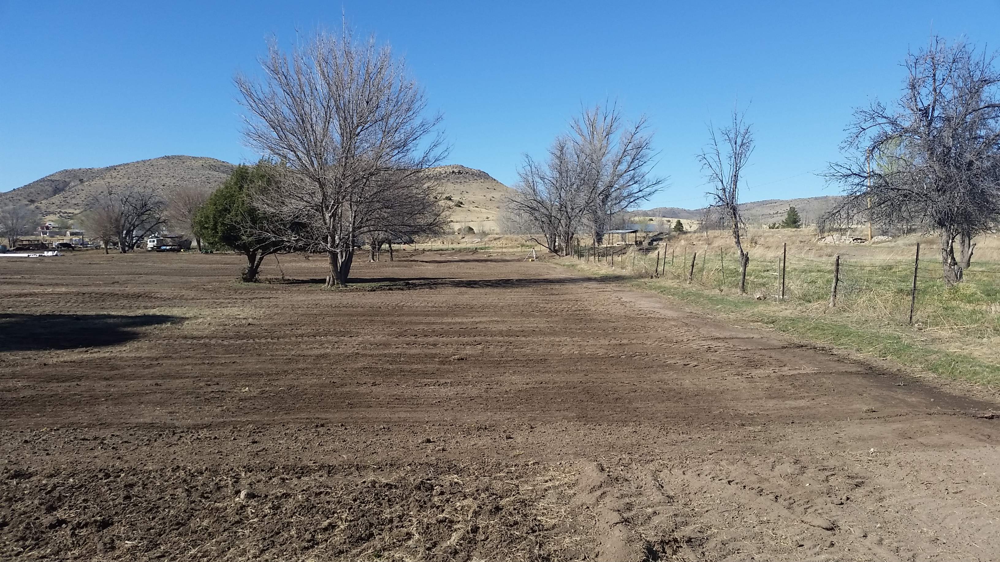

What you are calling a rock rake most of us call it a landscape rake. There are many of us over 60 on this forum nothing unusual about that. A picture and a rough idea of the size of the area to be cleared would help. If the rocks aren't too plentiful a three person team can clear an acre / 1.5 hours that how it has averaged out for me. I have a rock bucket and two landscape rakes which work much better on tilled ground but not with vegetation growing as in your pictures. Your expectations may be too high as you mentioned.
Another method I use with a rake is to work up a windrow of rocks by driving forward about 50 to 75 ft and dump the rake then drive forward another 50 to 75 ft and dump the rake. Making successive passes I wind up with windrows of rocks and grassy debris, I then use a backpack leaf blower and blow the grass off the windrow. I pick up the windrows with a rock bucket or standard bucket to dispose of them.
To get a decent grade on a field as pictured below requires rock removal, my experience has been that rocks don't grade well. I have to remove them to get good results. I have found that picking them up is the cheapest way to do it. No shortage of rocks here in the Rocky Mountains.
