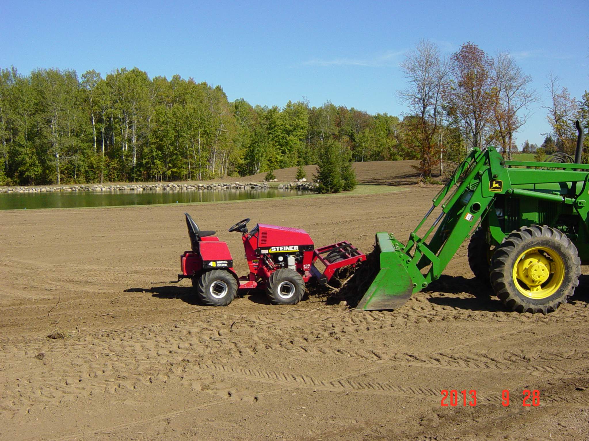

I used a Harley Rake.... or should I say soil conditioner today for the first time. Tearing up, leveling, easy, but I never learned to wind row debris. The rental I had was almost new, LOL, it may have been new. It did not have the hydraulic function of left and right angle. I tried the angle for a little while pull the pin, and struggle to get it back in, but it only went one way and back tracking got old quick. It also seemed to be out of level once angled. Had to go back and fix what the angle did. If it could go left and right angle from inside the cab, that would be good. Any tips. I would like to windrow debris.... otherwise we will be hand raking small rocks

Welcome to the Harley. The only one (Harley) worth having.
The thing is quite useless unless you have all the functions. And yes, it has to be level, otherwise one side will be lower than the other when angled.
The machine does a beautiful job, no doubt about it, but that's only half the fun. Now you have your rocks in windrows. How the heck do you pick them up? This has being driving me crazy for years. Lately, I have been pushing the stones (and dirt) into a loader bucket with another spring tooth rake on a little Steiner tractor. It is a lot of work and you get rid of a huge amount of good material along with the stones.
A project I have been working on is to build a "Flip Screen" bucket imitation and I could have so much used that this year for my Harley work, but my build has been delayed and I probably have to collect my rocks in the old manner..
