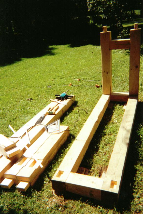

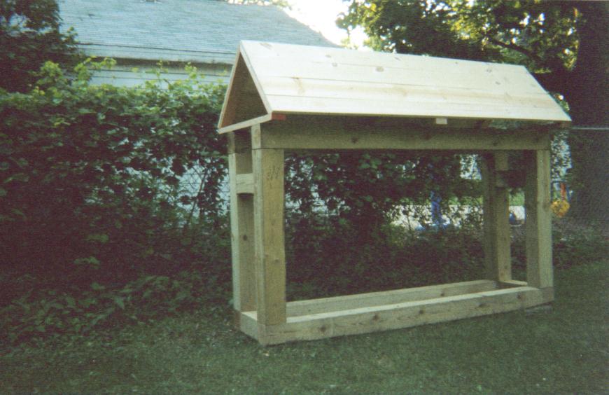

Photo sequence of my wood rack. It's small. I don't heat with wood, I just like a fire now and then. 9 pictures, I'll post a picture of the the completed rack when I can get a photo.
Photo 1.
Cliff

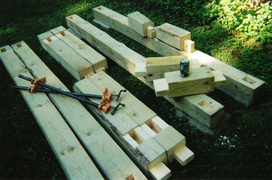

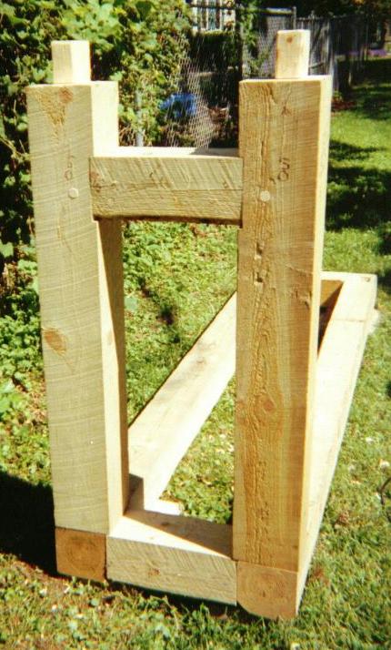

Photo 2
Cliff

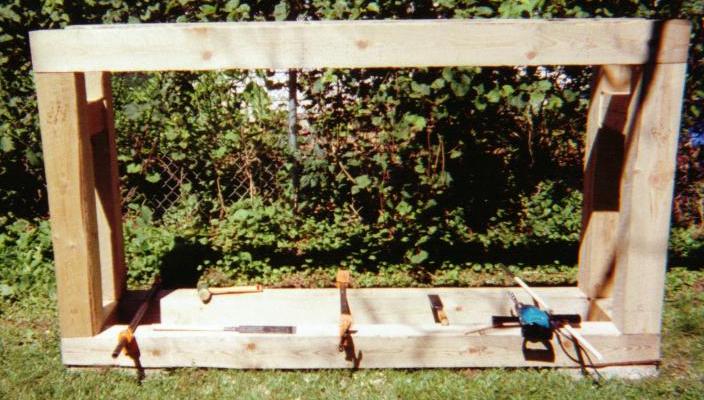

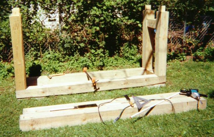

Photo 3
Cliff

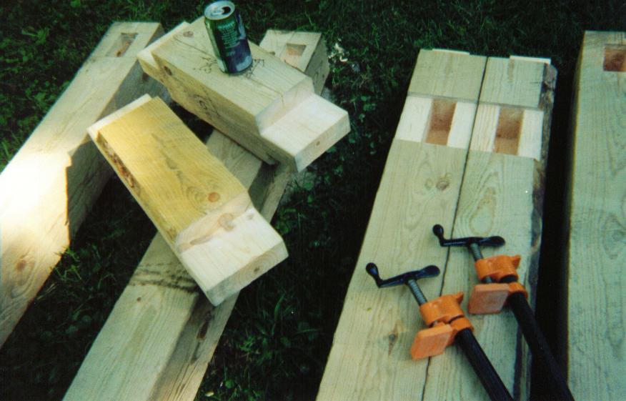

Photo 4
Cliff

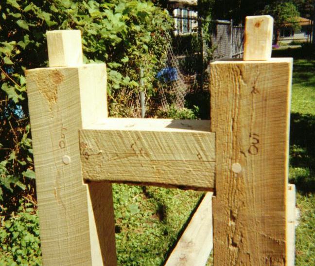

Photo 5

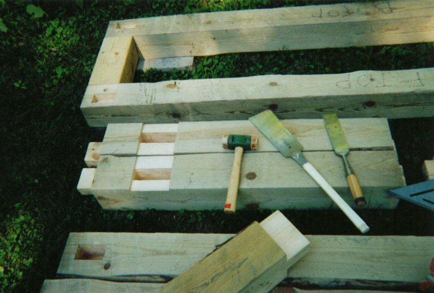

Photo 6
Cliff

Last one at this time. I will take a final photo soon, but it has verticle car siding and a shingle roof now.
Cliff

Poppa,
If you look closer at photo 6, you'll see the Makita 1/2 inch drill I used. I drilled the holes out with a 1&1/2 inch forsner bit, then used that 1&1/2 inch timber framing chisel and a 1 inch corner chisel to square the mortises. The tennons I cut with the Japaneese type hand saw you see there.
Cliff
