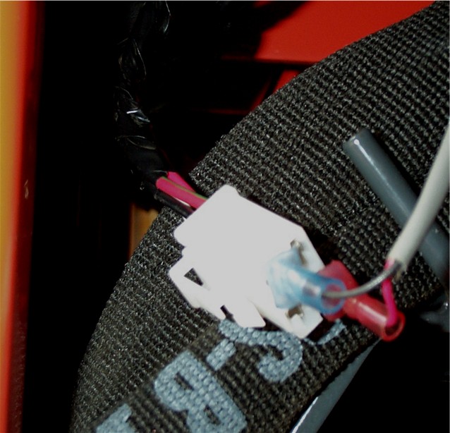

I remember I saw a post somewhere on this board that showed an unused power connection on the BX22/23 under the steering column that someone used for power to their Tiny Tach.
Does anyone know where this is. I just got my Tiny Tach yesterday and want to install it this weekend, but don't want to connect the power wire to the battery directly, but want to have it come on when the key is turned on.

Here is a picture of the connector.
John

fatcat,
My power connector was a little hard to find. It was tied underneath the instrument panel.
I mounted mine just behind the steering column. I think I still have an extra gromet if you want me to send it to you.
John

Thanks for the picture and the description of the location. No need to send the gromet, I'll be stoping by the hardware store Saturday morning for some stuff so I'll pick one up then.
Thanks again.
