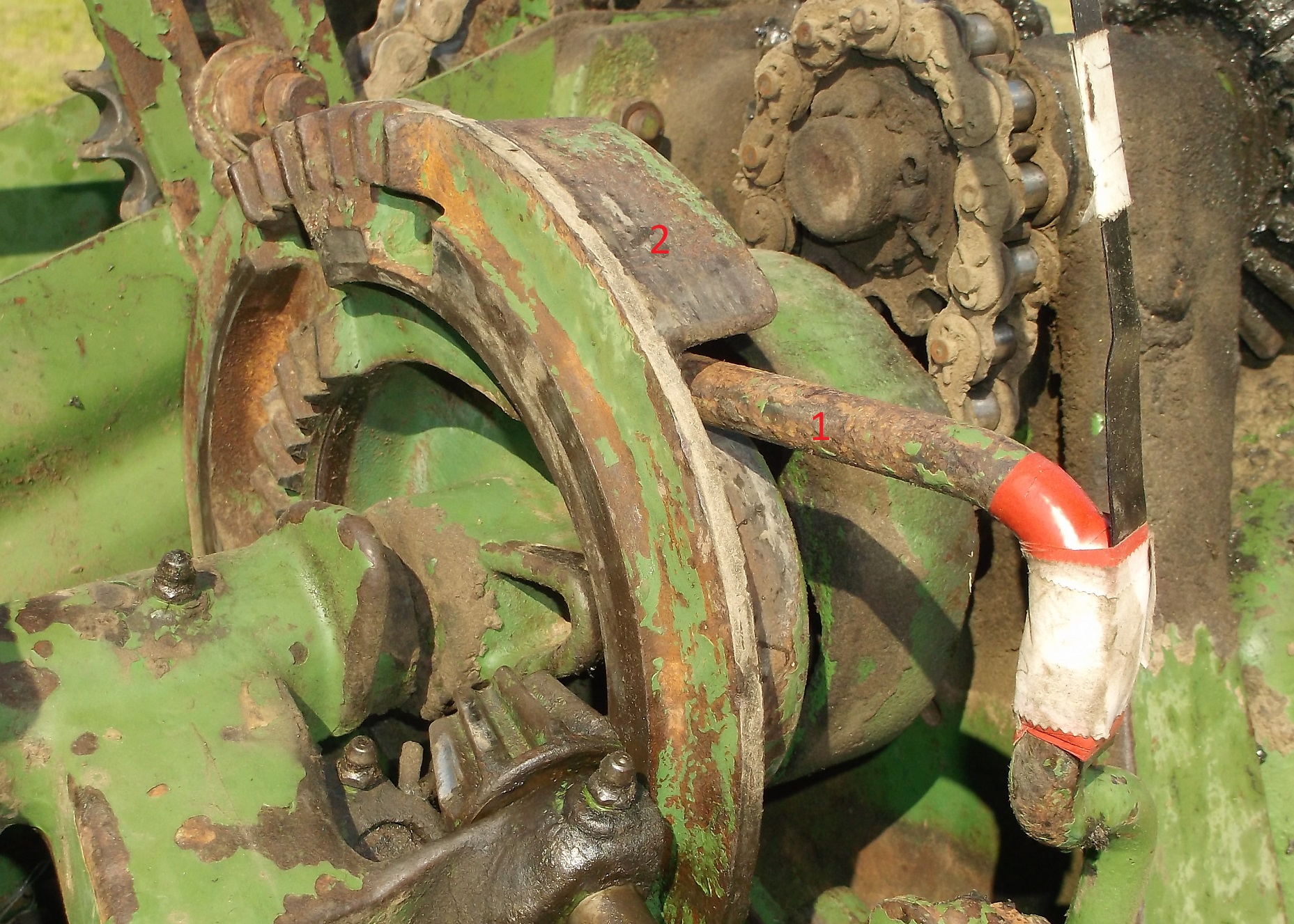

I've noticed, that on occasion, I can't manually initiate the knotting sequence... There is some sort of safety mechanism that won't allow that sequence UNLESS there has been approximately +/- 21 cycles of the plunger and the "safety bar"(#1) is lowered into the "go ahead and tie the bale" position... that safety bar is connected to the rotating "star" that measures the bale length... At the proper bale length the safety bar(#1) is in position to initiate the knot, BUT there is a second "guard"(#2) that won't move to clear a path until approx 21 plunger cycles have happened....
What or where counts the plunger cycles that allows all this to happen ???
After a bale is tied, #1 is on top of #2... approx. 21 plunger cycles, #1 moves to it's current location ... With the star rotation, #4 pushes on #3 and initiates a knotting cycle...
What I don't understand is... the rotation of #2, how it is moved and what initiates the movement after ~21 plunger cycles... I can't see or find anything that moves during the 21 plunger cycles..

I realize now I need to add more information that i just thought of....
When i noticed the knotter not activating, #1 was on top of #2... Now, to be more specific, my windrows were pretty big... My travel speed was walking speed... as the windrows got smaller, I noticed the bales were tying.... HUH ??? Why is that... So, having a over-direct-under Sherman transmission AND an under drive Howard, I engaged the Howard to reduce my travel speed while keeping the baler feeding at the same rate... The knotter worked perfectly and all the bales were tied perfect...
That's when I did the test... Number of plunges until the safety was in the "tie the bale" position..
Now I realize you CAN'T feed the 14T too much hay or the knotter is "locked out" by some weird safety lockout... Which I can't figure out how the knotter counts plunger strokes... Well, it may not be plunger strokes but that's how I counted until #1 dropped below #2 so it would tie a bale...
I've been looking at the chains and thinking I should change them... I'm chicken... If I screw up the timing.... I'm sunk.... What I should do is measure a new chain and try to estimate, with a micrometer, how much stretch is in the old chain... It does look good.... sprocket teeth don't seem worn....

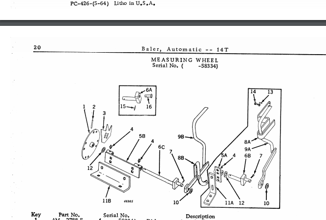

Knotter & needles on most sq balers are not dependent on any set number of plunger head strokes to cycle in fact knotter can cycle on every plunger head stroke if trip dog lock out mechanism isn't adjusted correctly or is not touching pawl correctly. The trip lever(key 9A or 9B) on an early model 14T would be a little more difficult to trip than later model sq balers but I think it could be manually moved BUT it's been many/many yrs since I made a service call on a 14T baler when I was employed at JD dealership.

I found 9A was sitting on the "wheel" and couldn't disengage properly... I attribute it to worn chains...
I changed out all the chains.... Found the directions to time the baler were wrong... I had to readjust the chains etc. based on the location of the plunger to needles... What a PITA... after maybe 6-10 chain adjustments to the main drive sprocket and chain.... I got it working and have baled hay 6 times... what a blessing.... no missed knots or no missed bales...

Thanks for update. I'm glad you got baler to bale hay. I seriously doubt "wear in chains" caused bale measuring mechanism to "not disengage properly" but I've witnessed several other strange things when repairing farm equipment during my life
