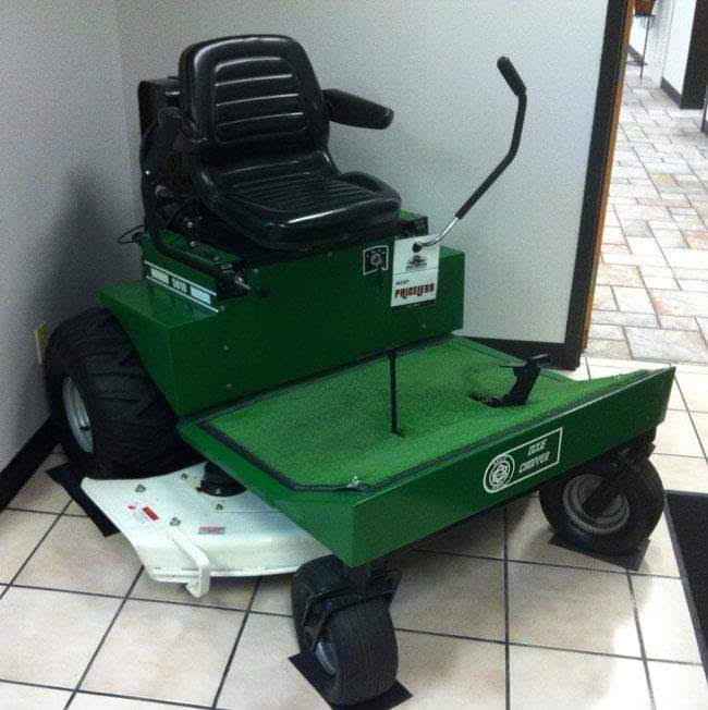

The one that started it all
Everyone needs to thank this guy for this awesome invention.
