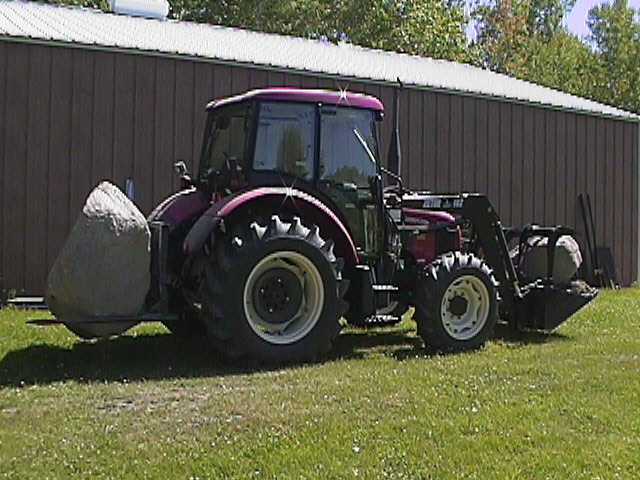

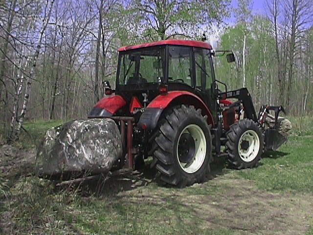

Another idea is have your local blacksmith shop weld up a 10,000 - 15,000 lb capacity 3pt bale fork. Mine is made of 3" reinforced square tube & used truck axles.
Idea is to dead lift most or the whole thing & cart it off. Weight prevents wasting energy spinning wheels just grab something for the nose to hold it down when overloading the rear end.
   / Time to move a couple small stones... #6

Another idea is have your local blacksmith shop weld up a 10,000 - 15,000 lb capacity 3pt bale fork. Mine is made of 3" reinforced square tube & used truck axles. Idea is to dead lift most or the whole thing & cart it off. Weight prevents wasting energy spinning wheels just grab something for the nose to hold it down when overloading the rear end.
My 3-point is not that powerful... and my tractor is not that heavy. 3-point lift capability is only 2,865 lbs. That larger rock... and probably even the smaller one... wouldn't even know that I was there. :eek:
Use of my own tractor, if even remotely possible, would require some serious creativity!!! :D
