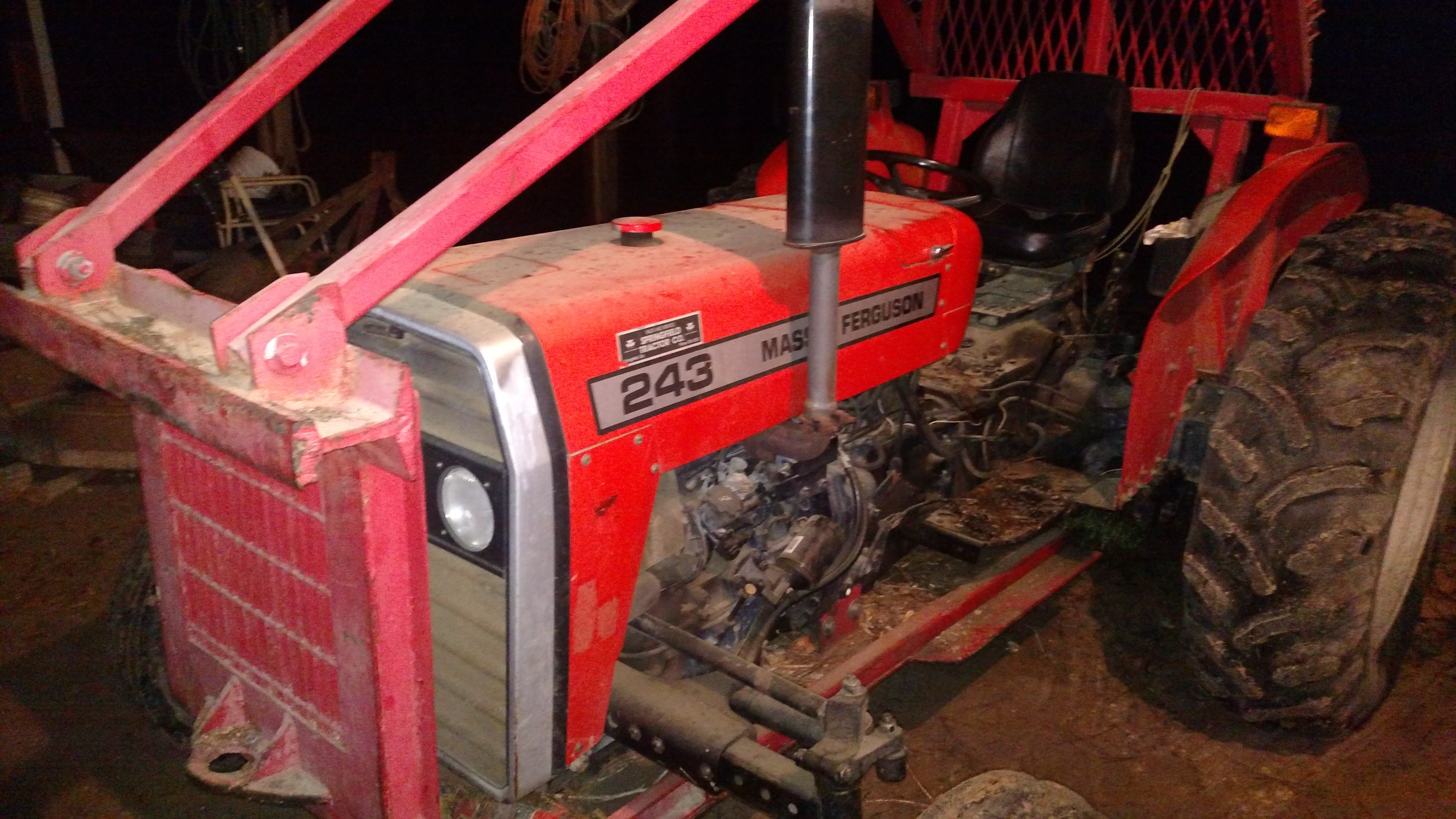

/ Time for some skid plates #2

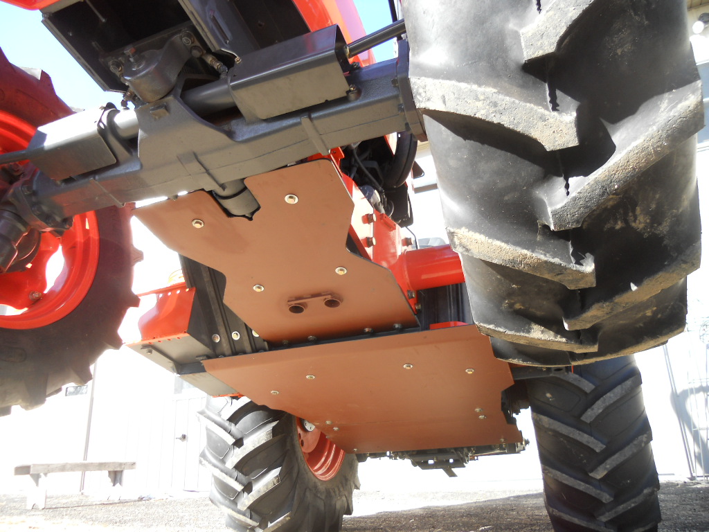

Full belly works great if you can swing it on your model or as close as you can get. IMG_20201118_055433.jpg

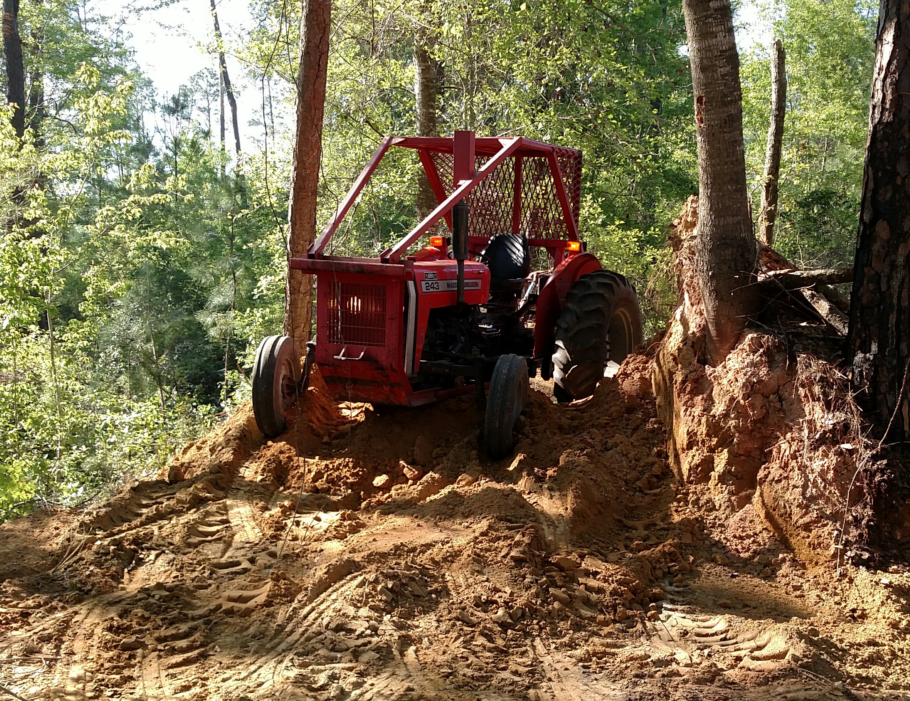

I broke a couple of foot throttle linkages before going into full forestry mode. No problems since..

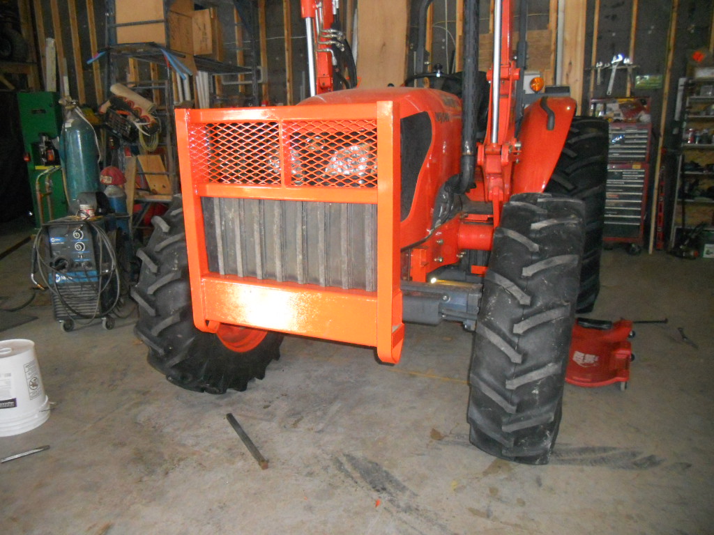

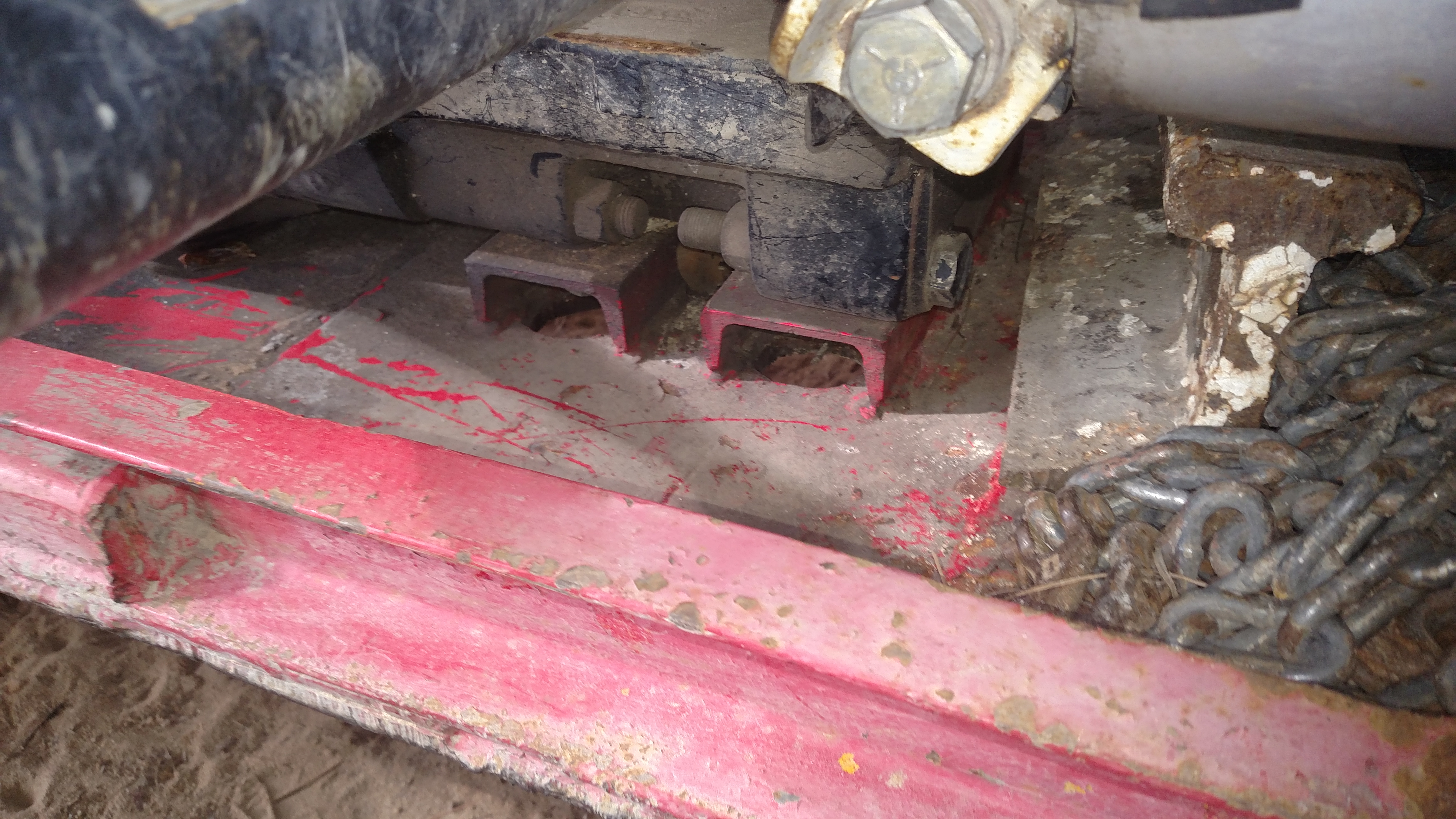

/ Time for some skid plates #7

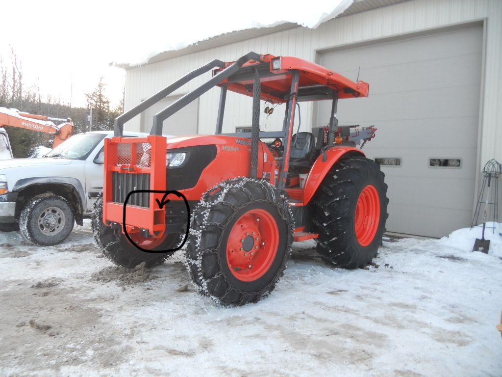

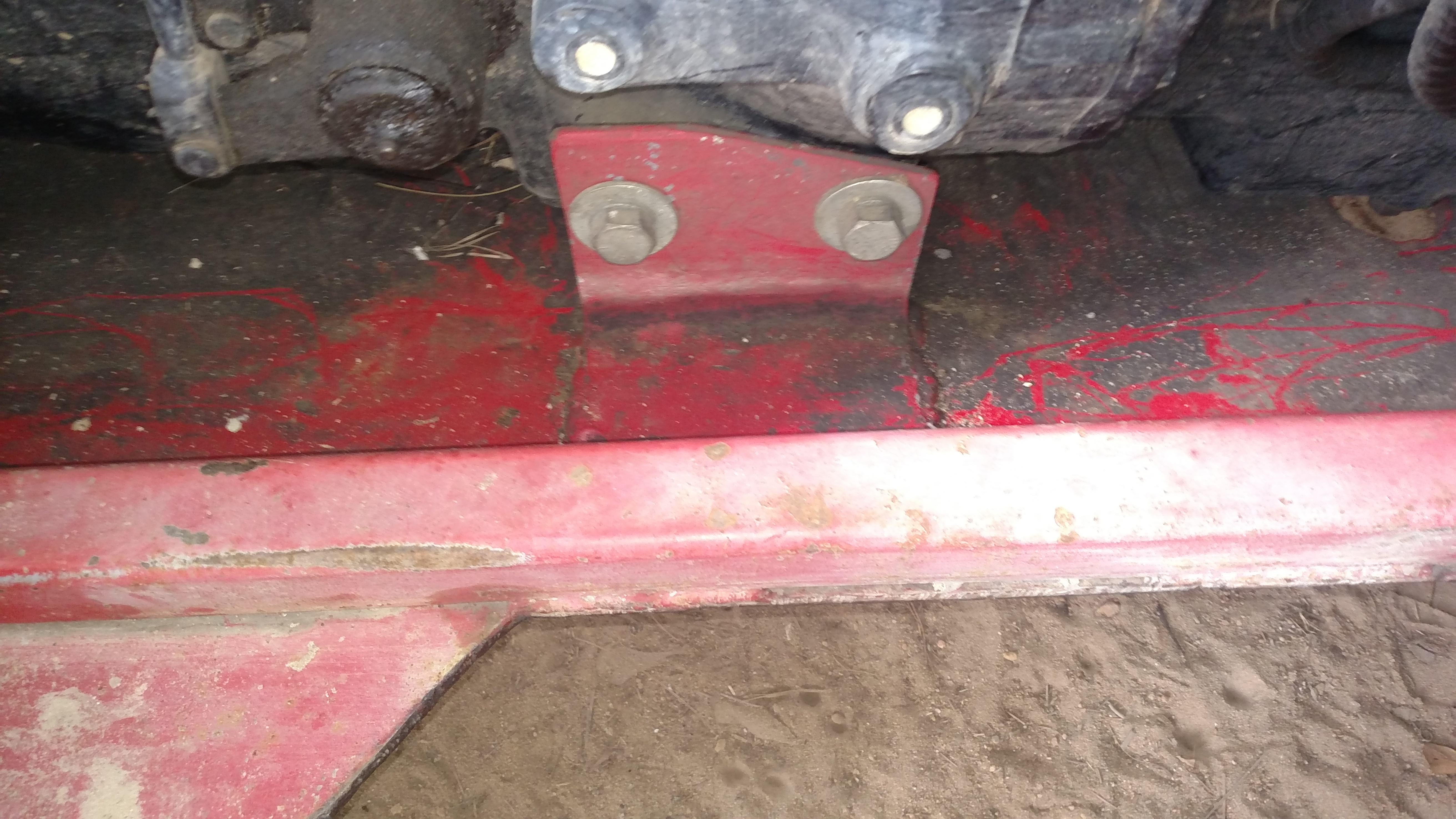

Not real pretty, but nothing get's past it.
If also makes for a handy chain box. (pic on rt. circled)
/ Time for some skid plates #9
Thanks Red, as you well know, there's not much to attach to under there. Got any pics of your set up? I like to see how others handle this.:thumbsup:

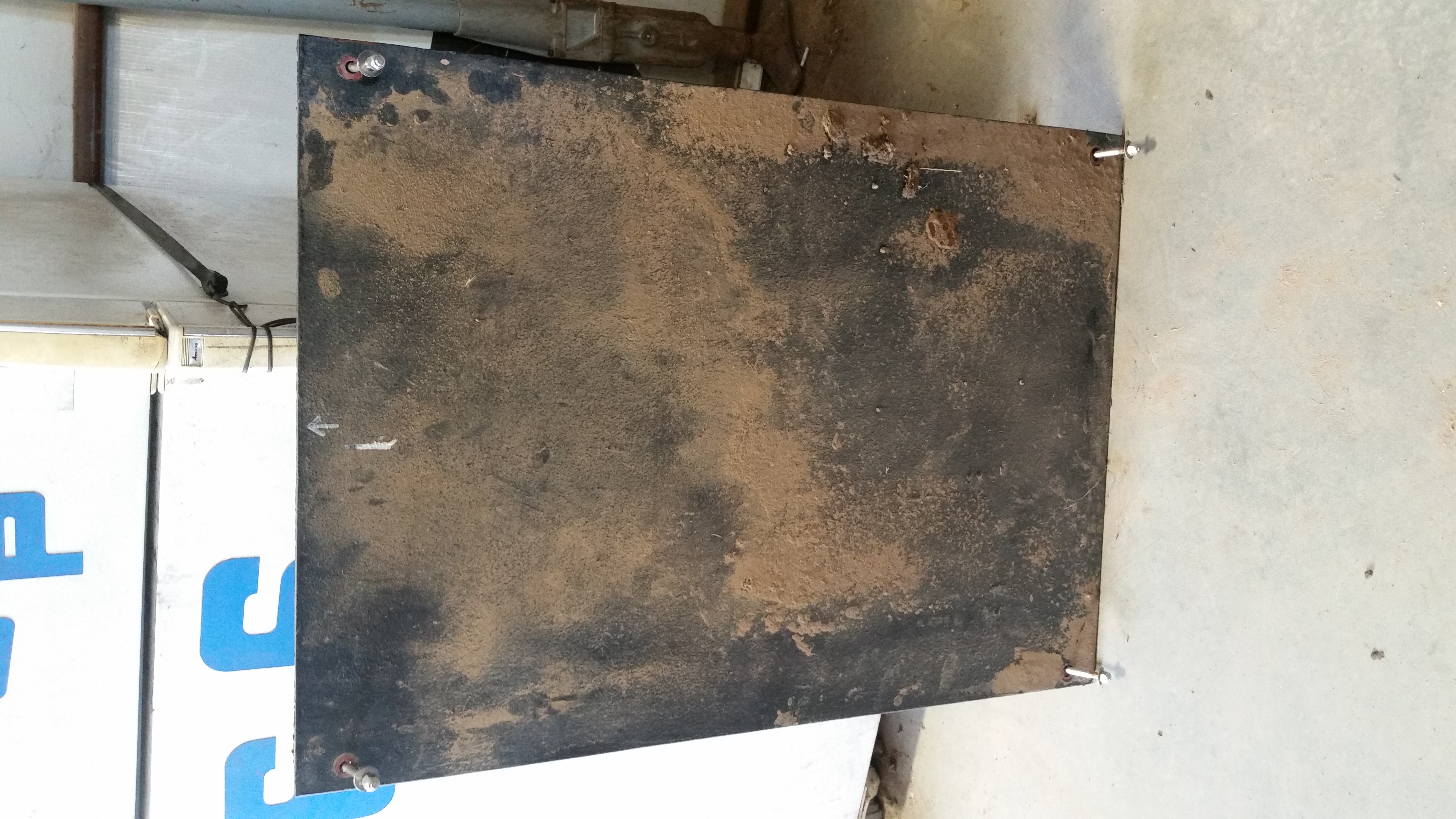

/ Time for some skid plates #11

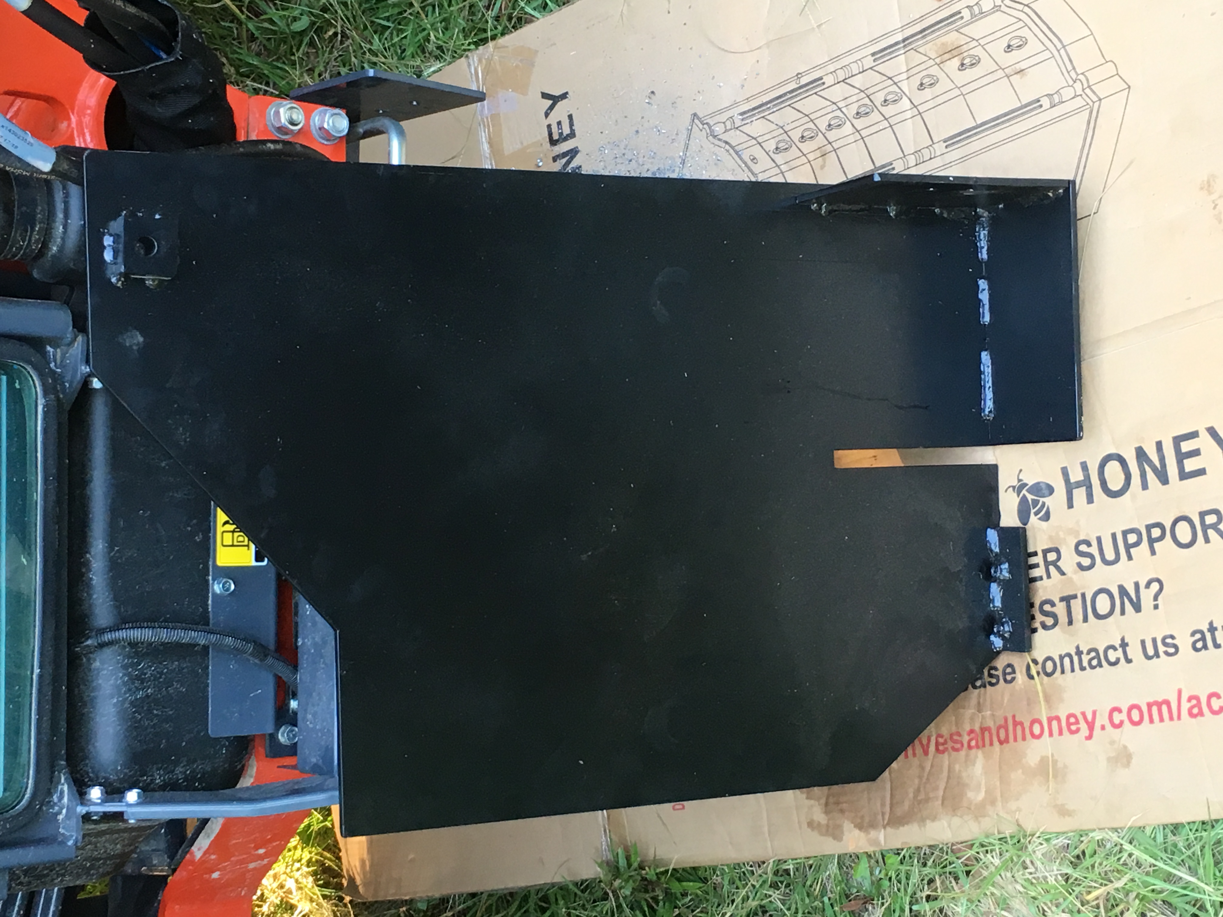

Here are a couple pic's of the armor I made for my LS4155. I use the tractor clearing trees and brush quite a bit. Its been on there for several years with no issues.
No idea why the pic's aren't orientated properly.

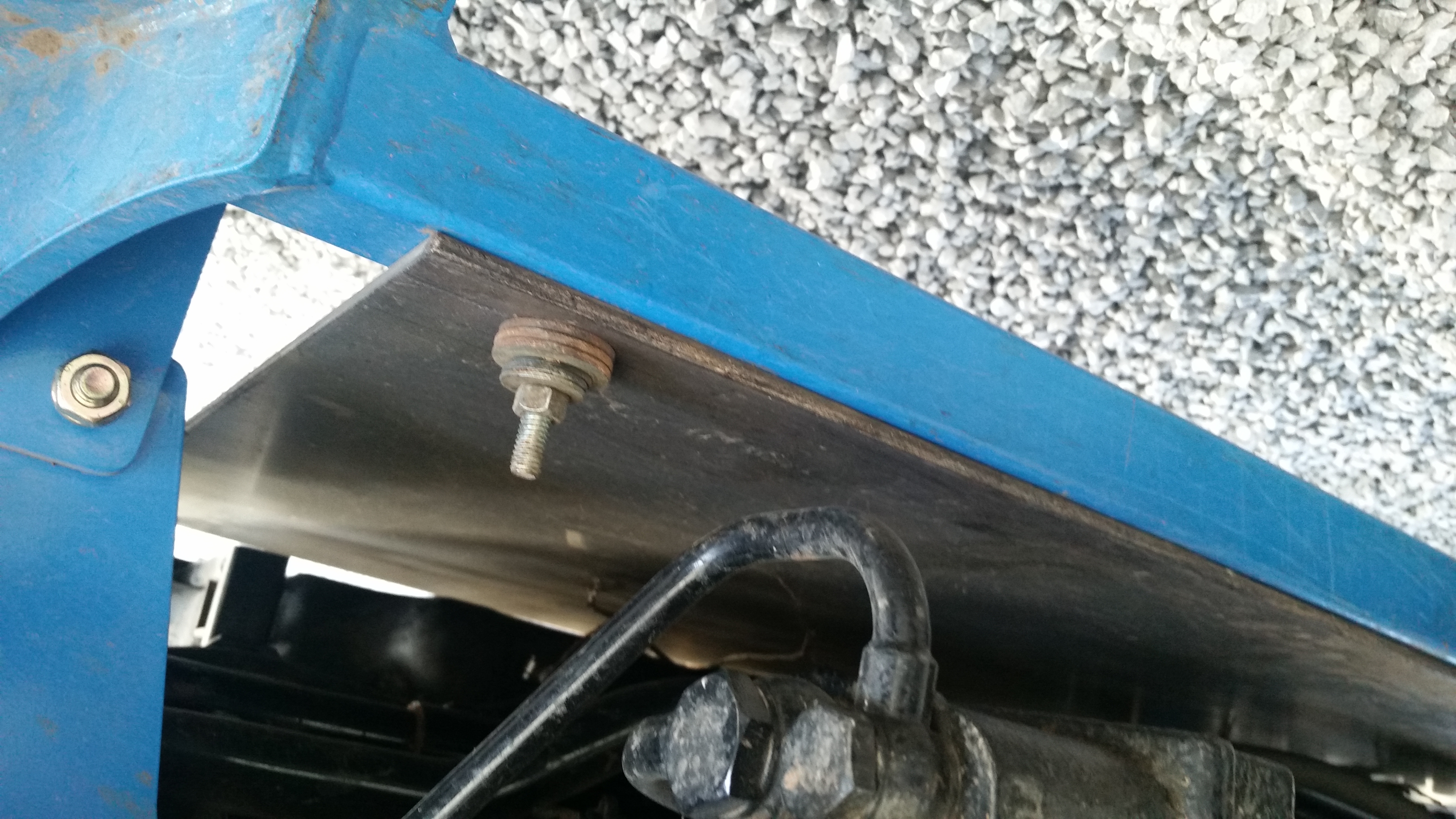

This is what is under my Grand L. While nothing like what Rustiron made, it does protect the hydraulic filters and third function lines. One of these days I may add a little more under belly protection.

/ Time for some skid plates #13

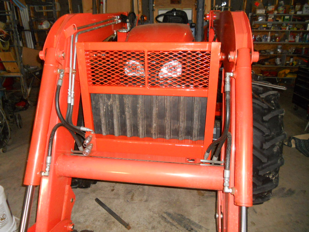

The 2 mounting FEL spots along each side, heavy angle laid on it's side welded to the 3/8 sheet steel.
Upfront used 4 holes that front bumper/brush guard attaches. C channel welded to sheet steel with 4 bolt holes. Don't have any good pics on hand but will get some tommorow.

Hey buck and cataclysm, this was a winter project for me and I admittedly went to extremes. (winters are long up here:laughing:) I took it as a challenge to keep anything from poking my tractor and to only have to worry about the mower or the logs I'm dragging and keeping my hat on my head. Your skid plates and guarding look great and I'm sure they work well and I enjoy seeing other's solutions. :thumbsup:
The angle welded to plate steel bolted to FEL mounting bracket.
Up front c-channel welded to plate 4 holes torched through for bolts to mount to frame.
3" channel used to fab front and 2" tubing along 3/8 plate for bracing. Such a long run of plate will bend and warp with if not braced..(ask my buddy he knows) Choose tubing because it's easier to clean out than the channel.
Other holes cut in plate for oil and hydraulic drain.
