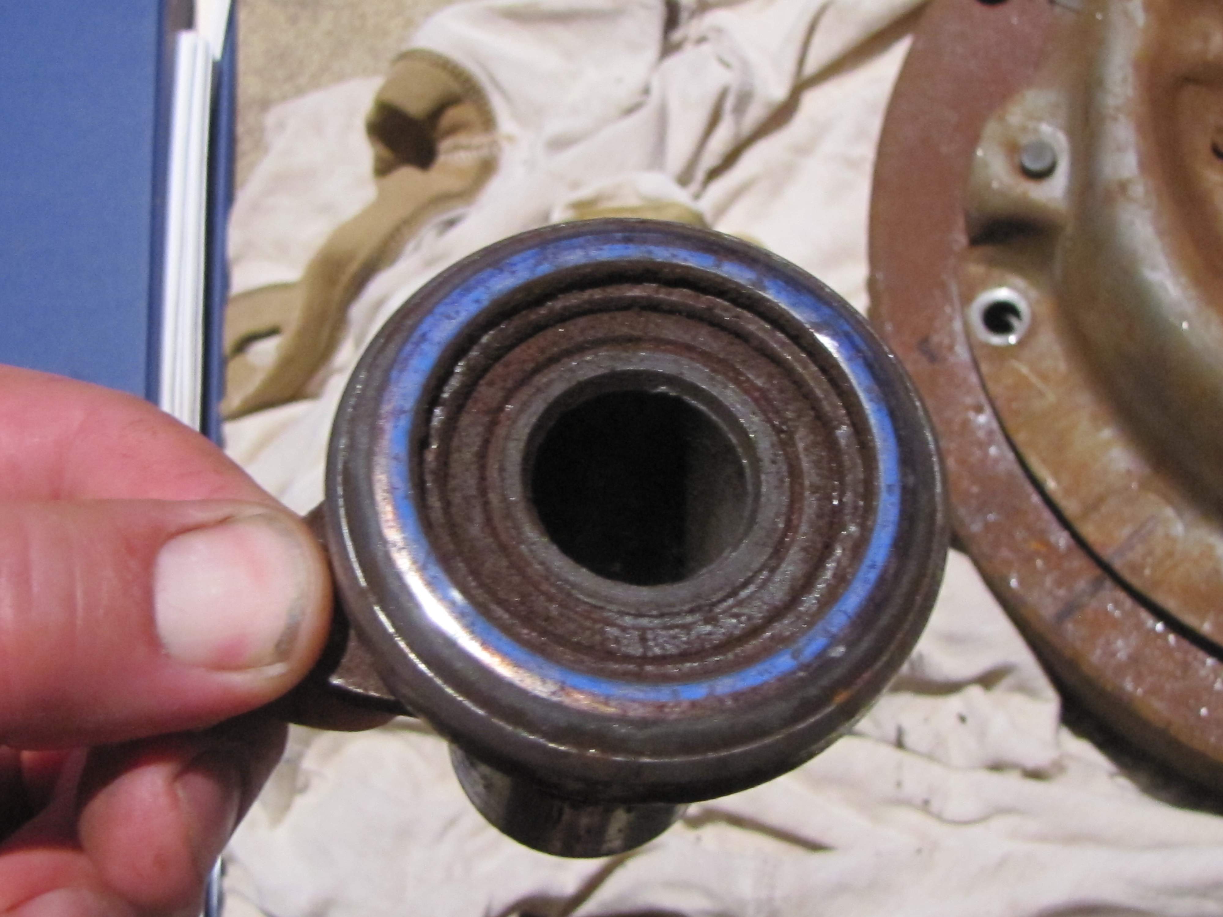

Throwout bearing is totally dry, and has several mm of play back and forth. Any grease that used to be around is non-existent. The shaft as well has some old grease on it but is pretty stiff.

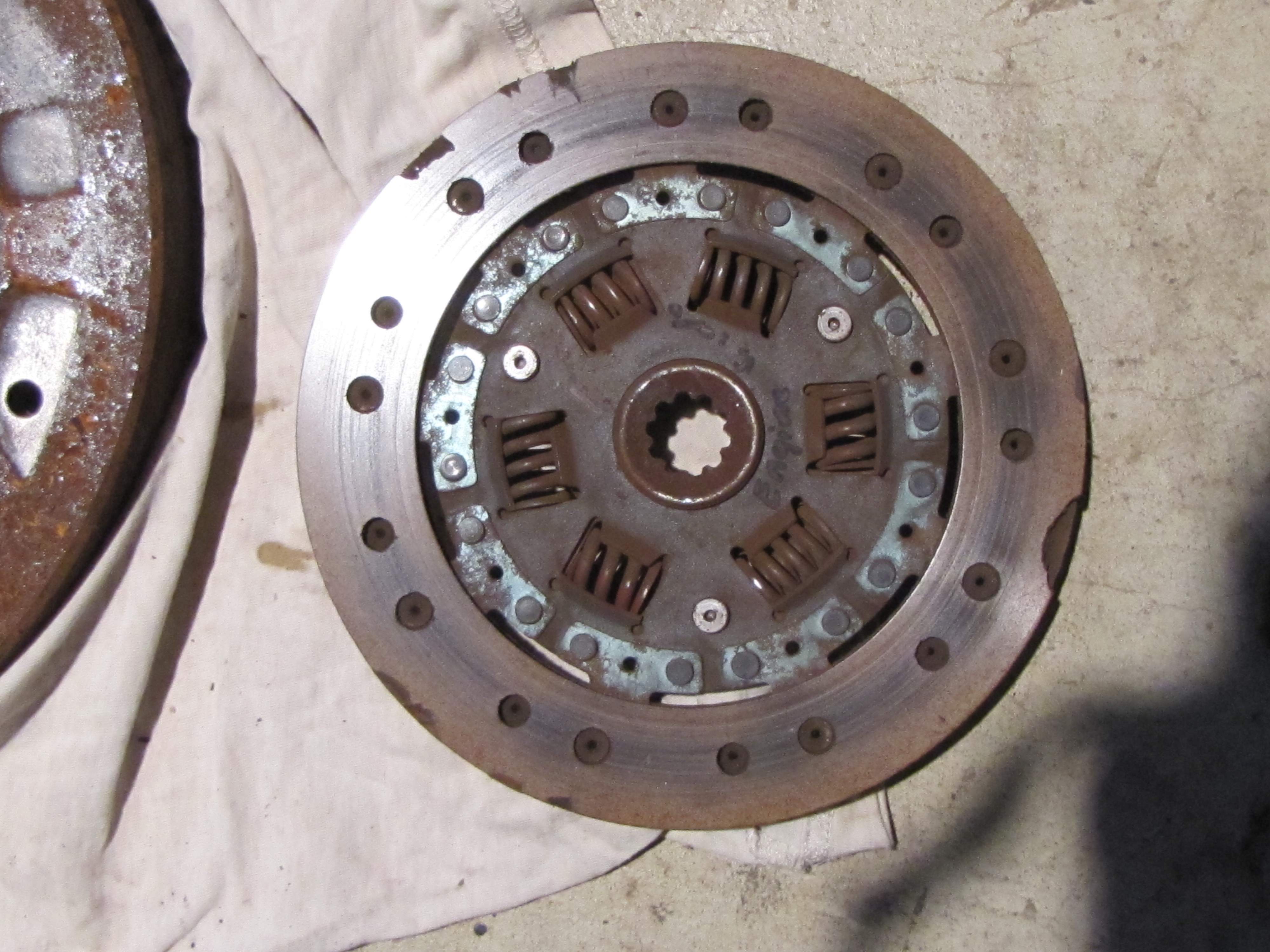

The clutch disk is actually not as worn as I thought it would be the shallowest rivet to surface distance is about .57mm. The specification for replacement is .2mm. More troubling, I think is the large chunks missing from the outer edge of the clutch disk (see picture). It is the side of the disk that runs against the flywheel. The other interesting thing is that most of the wear looks to be along the arc of the rivets..not sure what to interpret here.
Both the flywheel and the pressure plate are glazed and have dark spots...pretty much what I expected.

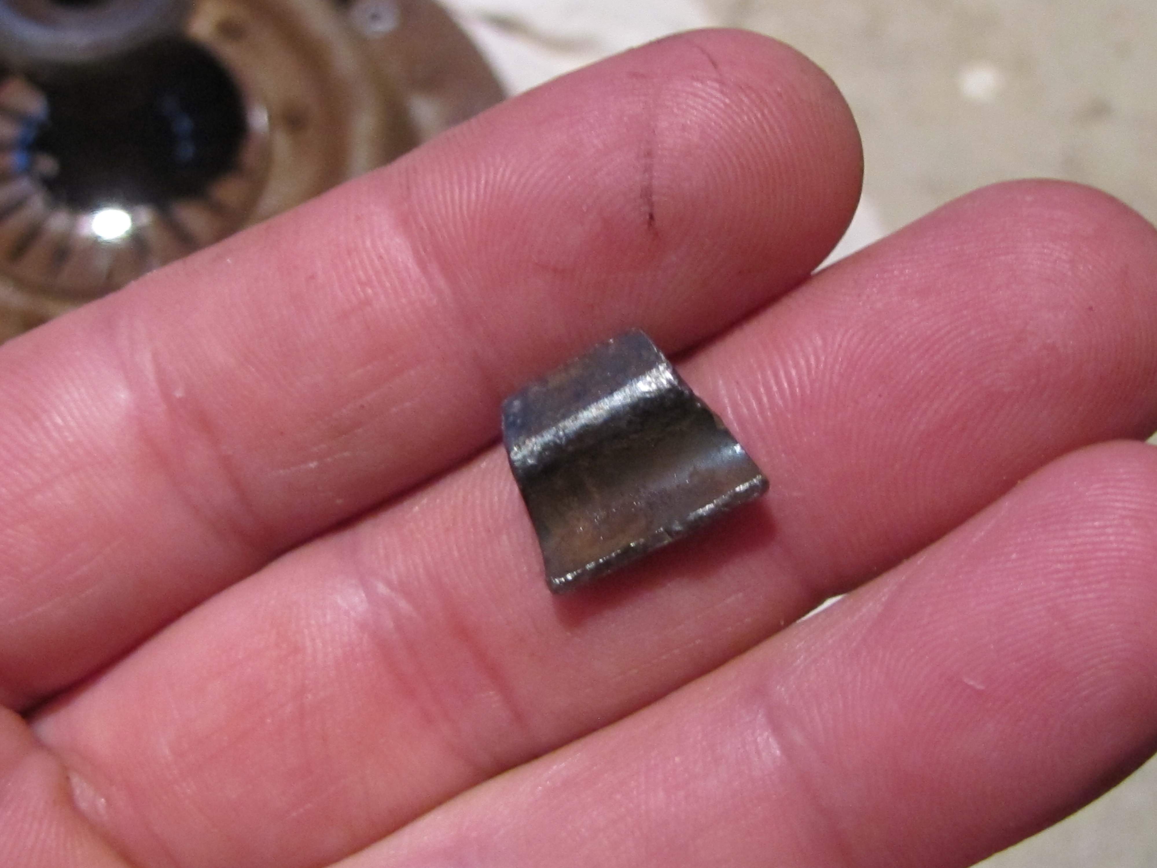

Lastly, I found this little broken metal spring looking thing (picture included) floating around behind the flywheel. I have no idea where it came from or what it is.

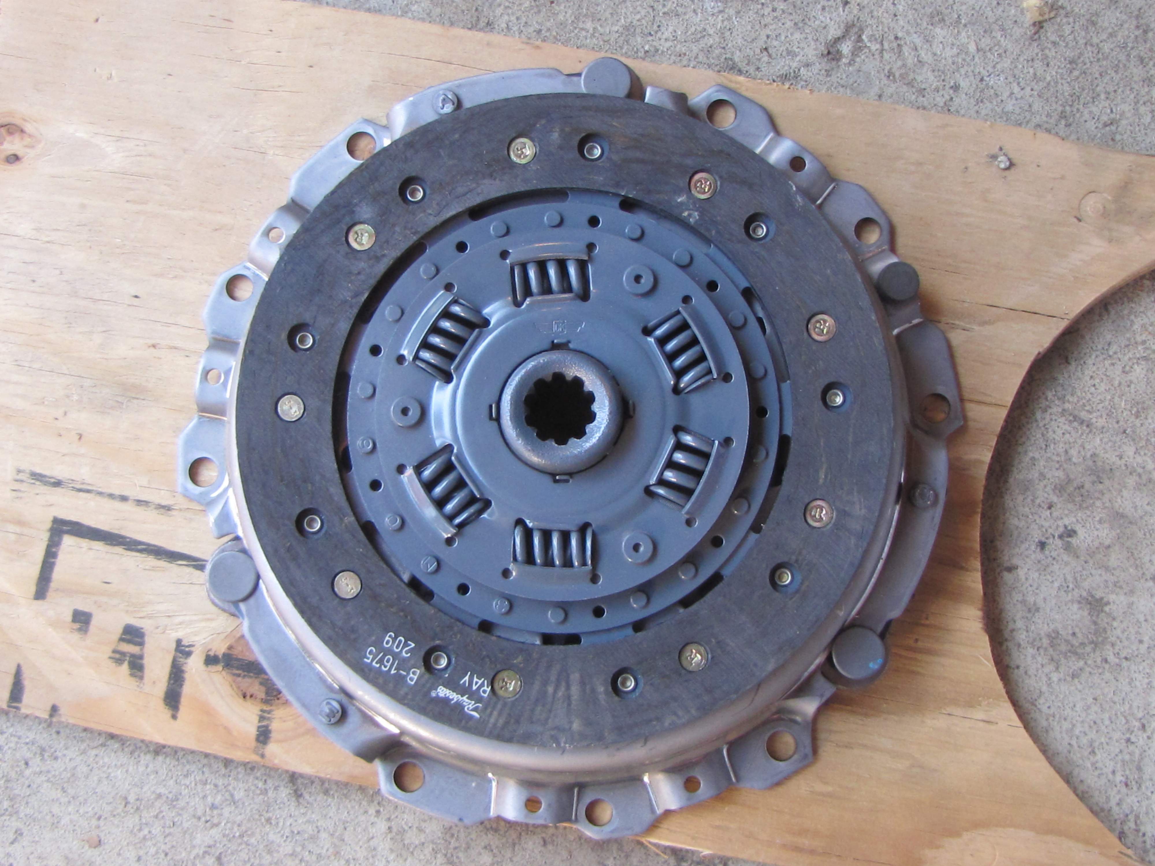

I ended up replacing the clutch disk, which was rebuilt ($101.50), the pressure plate, which was supposed to be rebuilt, but looks completely new ($134.20). Throwout bearing ($85.00 :eek:) and guide bushing (24.25). A new fuel filter while I was at it, because I had to drain the fuel system to split the tractor. A couple O-rings and a bit of labor for a total of $368.90...whew!

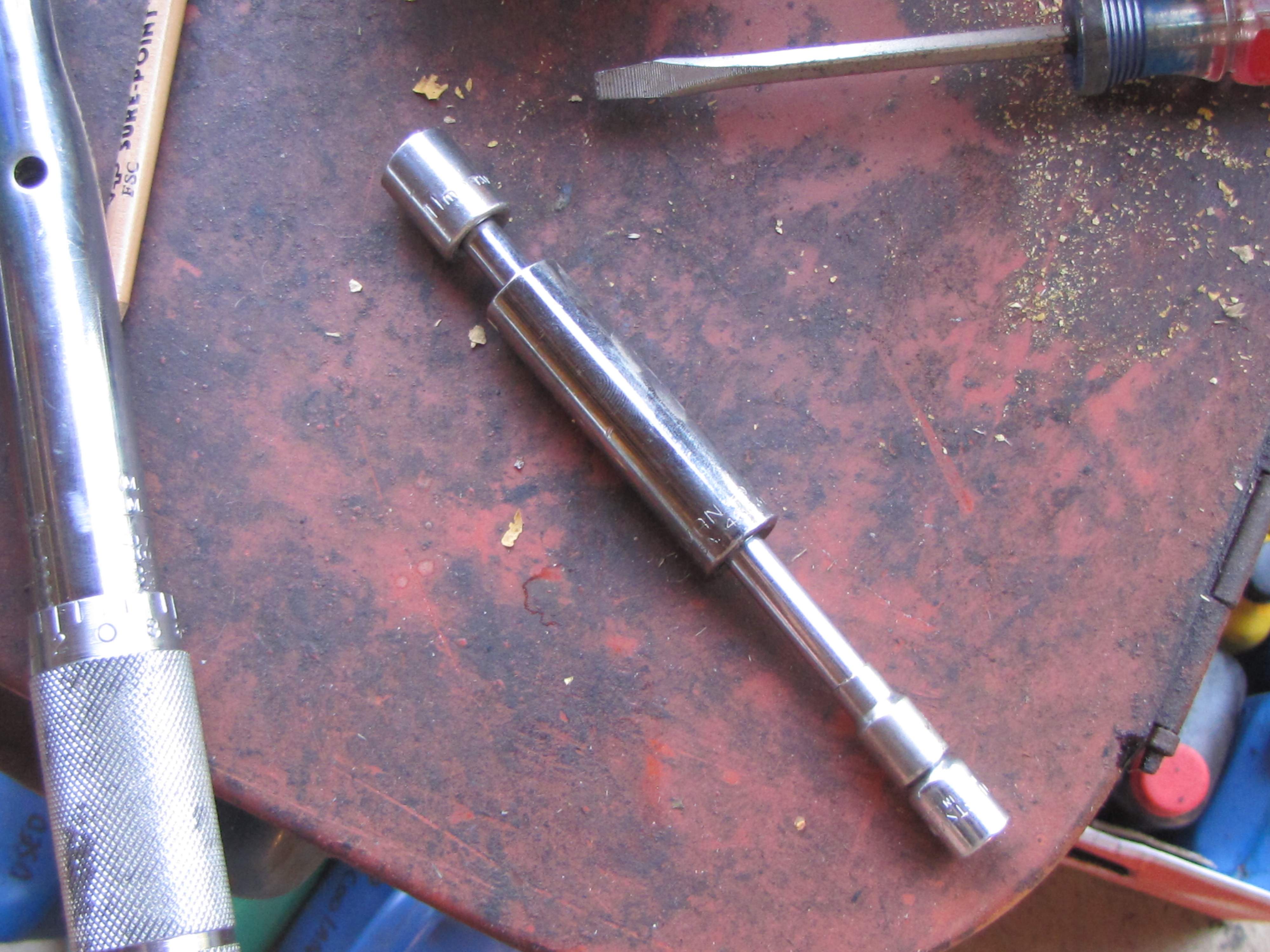

I had to fabricate a clutch alignment tool out of some sockets and other stuff. A stash of junky old sockets came in handy for this. The general alignment tool from NAPA was too big... and nobody had a 10 spline plastic one.

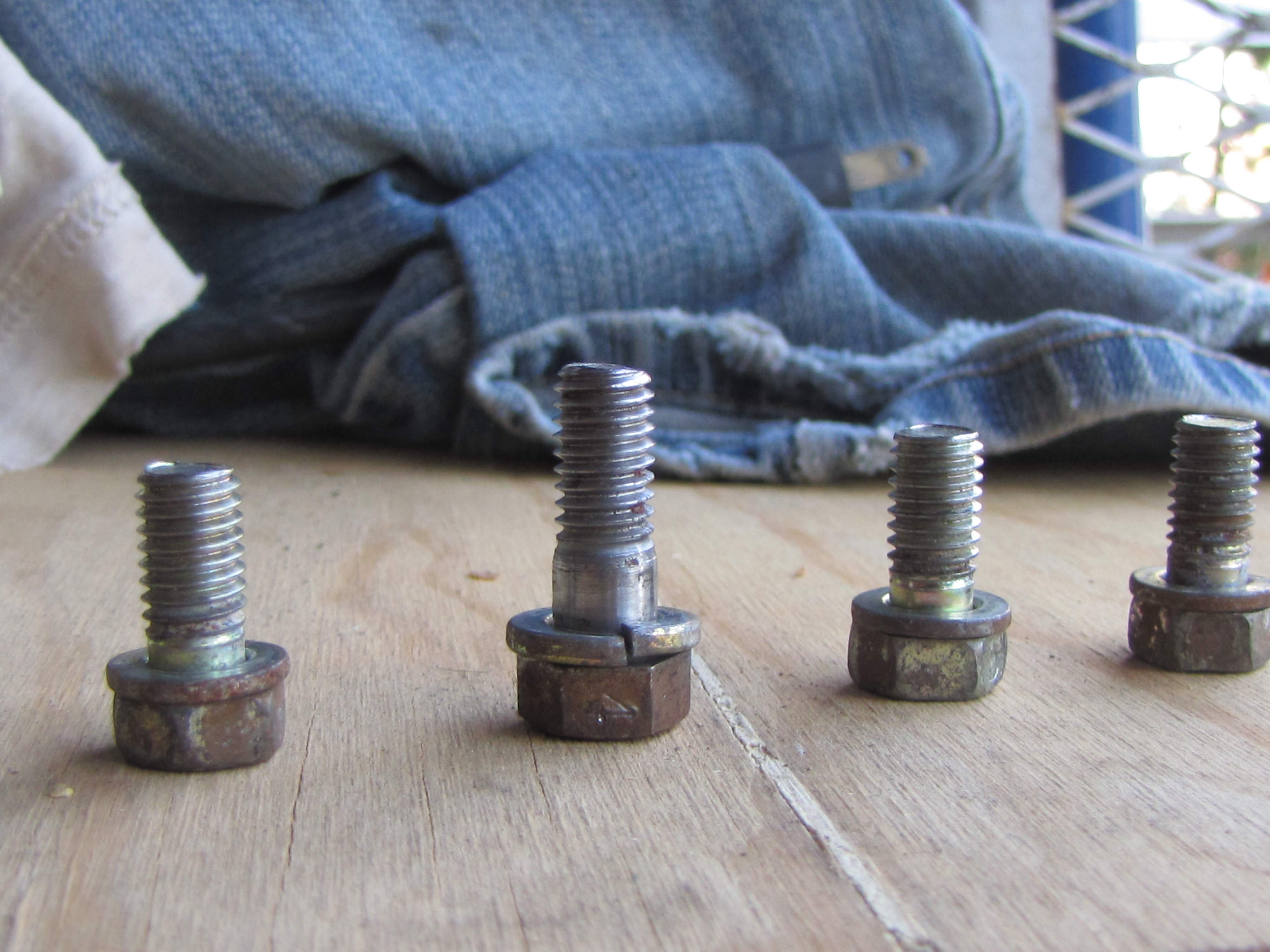

when you pull the clutch bolts make sure you mark them as there are 2 that are different. The manual calls these "reamer bolts" and they have 2 dedicated holes opposite one another on the flywheel. I actually ended up match marking the flywheel so that it was put back on the crank in the same position, then used this mark as a reference for the bolts...I went overboard and marked each bolt so this time each one ended up in the same hole.
