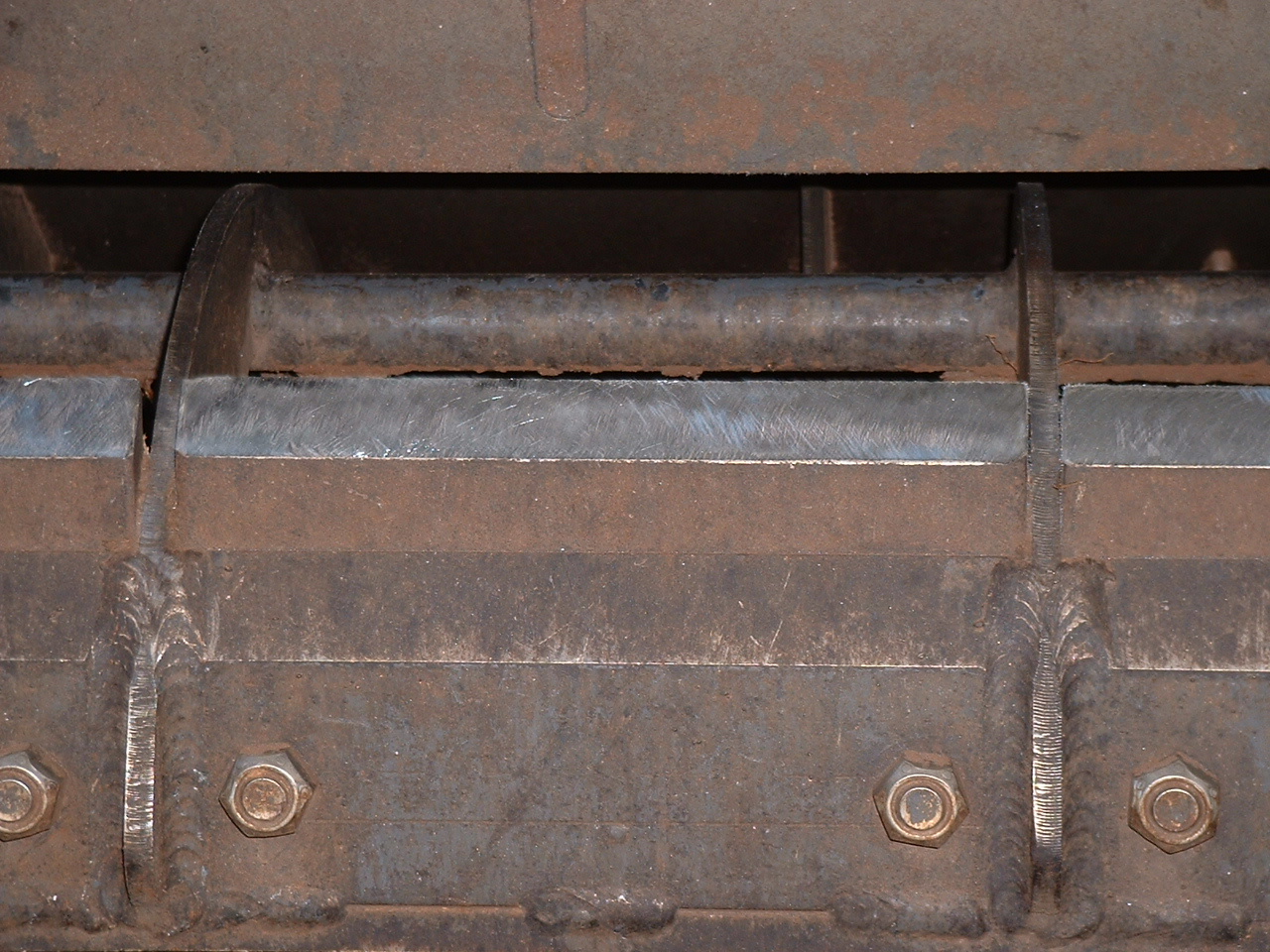

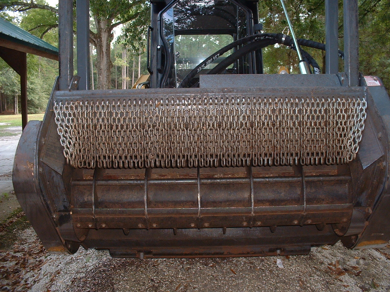

7 inch angle grinder with the NORTON 3X disc here.ps-thanx robbie..I also built a small riser to park the machine on so that im sharpening at chest height or so..Ive found slow speed is better...rotate the head back as to expose your blades as best possible..Flip the chains back and out of the way..Lock the drum with the alignment holes and pin on the left side as you face the front of the head.."Blip" the grinders trigger and move the grinder fast across the face of the blade..I usually "pull" the grinder working from left to right..Its not as perfect as when they are NEW but they will be sharp and the knives dont really care when they are eating all that wood...as long as you dont grind in one spot too long and change the edges profile...and may create a balance issue...FYI-Your forearms will feel it after doing a set....I seem to get a full day of cutting with mine..possibly 2 but all depends on what your into...I like to run a day and touch em up after for the second day...If i hit rock or wire or bricks ,etc then it takes a bit of cleaning up the edge....
I think it just takes some time and practice...dont think you ever get them perfect.....hope this may help.. DSCF0004.JPG
