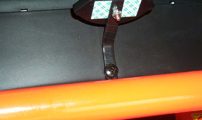

I own a B2910 w/o a canopy or cab. I purchased a tiltmeter from R&B and having problems figuring out a way to mount it. I did get the brackets. I would like to minimize hole drilling. I could mount it on the hood but I am worried as I spend alot of time clearing brush and I can see it catching on something if it is too far forward./w3tcompact/icons/tongue.gif I am asking others who have solved this problem to tell me how and perhaps post a photo or diagram. I did email Rick at R&B and got the reply copied below. Thus the request. I thank all in advance./w3tcompact/icons/smile.gif

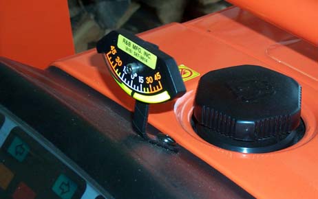

Not sure what model tiltmeter you have (or even what model I have for that matter /w3tcompact/icons/frown.gif ), but on my B2910, I mounted the bracket to the dash board screw (hood side, center of the dash). It sits behind the crossbar of the loader, so should be protected and it's close enough that I can see it no problem. I'm at work now, but can post a picture when I get home if you'd like...

Here's a photo of the back side showing the bracket and center screw on the rear of the dash. The bracket came with the tilt meter, but it'd be easy enough to make from some scrap.
Jerry

And a photo of the front/side.
Jerry

Thanks for the photos. My particular model has two brackets and is a little larger. From the first photo, it appears the tiltmeter is not perpendicular but appears to be in the second photo. If it is, and I heard somewhere it should be, you just re-bent the bracket? Your solution is in line with what I plan to do but I am a little hesitant to try to re-bend the brackets since I will have to bend them by hand and I am worried about getting the bend right on two brackets.
