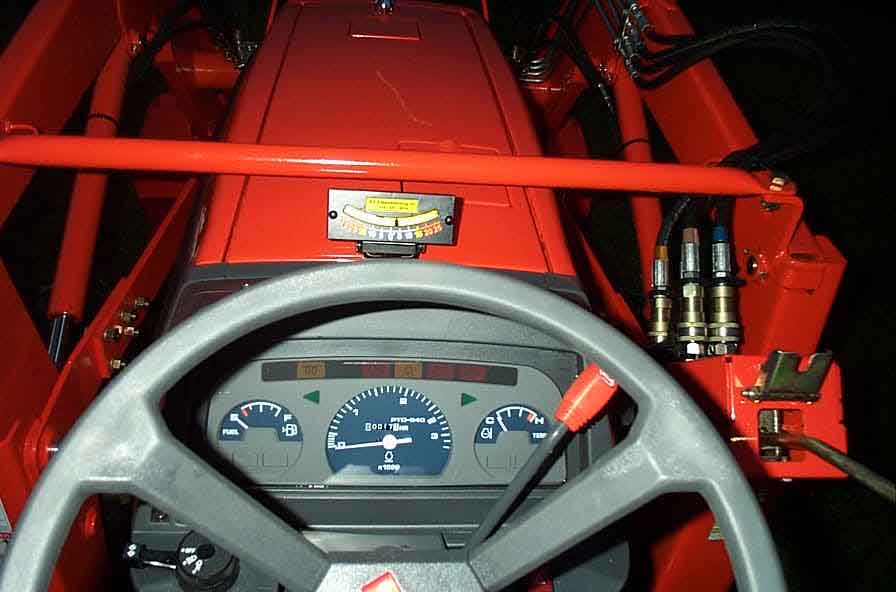

Preliminary mounting positions...

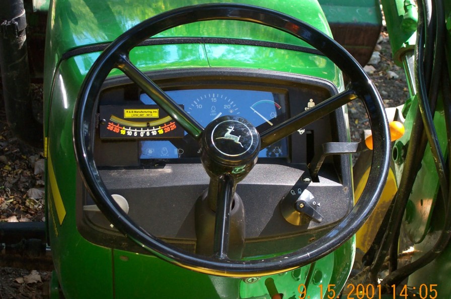

Closeup...
Doing a lot of brush hogging... so far, I found the dash mounted position to be the most protective place to mount...

I can't tell for sure from your picture, but is that tiltmeter vertical? If it is angled back it will be easier to read, but it will exaggerate the sideways tilt of the tractor.

From the seat, it's got great visibility with the rest of the instrument panel...
I was hanging over the seat taking the picture.../w3tcompact/icons/wink.gif

I was thinking the same thing as Will. If the meter is tilted back, you might be getting a false reading. Or is the mount deceiving.

I looked at the dash again today... yes there is a slight angle... I didn't think to measure the amount, but I will.
I had it mounted on the hood..., but I was concerned about knocking it off... I kept looking at the tiltmeter to make sure it was still there... It ended up being distracting enough to move to the dash area.

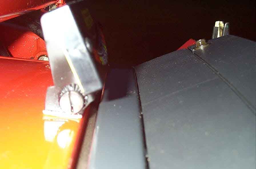

Here's a shot of my tiltmeter with the prototype bracket. I have it tilted toward the front of the tractor but with the bracket you can adjust it how you want it. See the next picture.

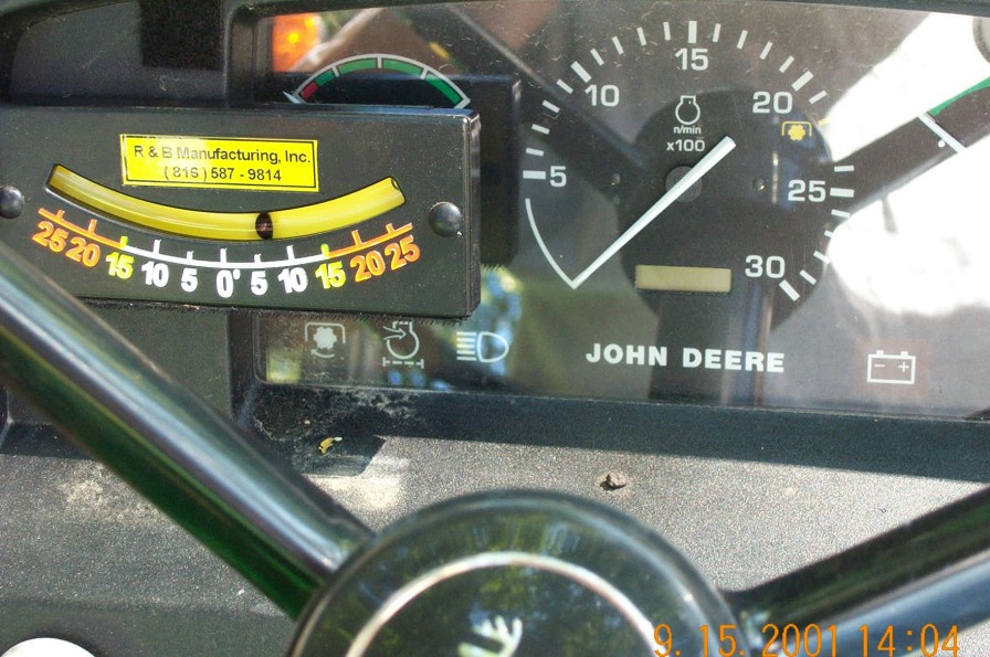

side view
