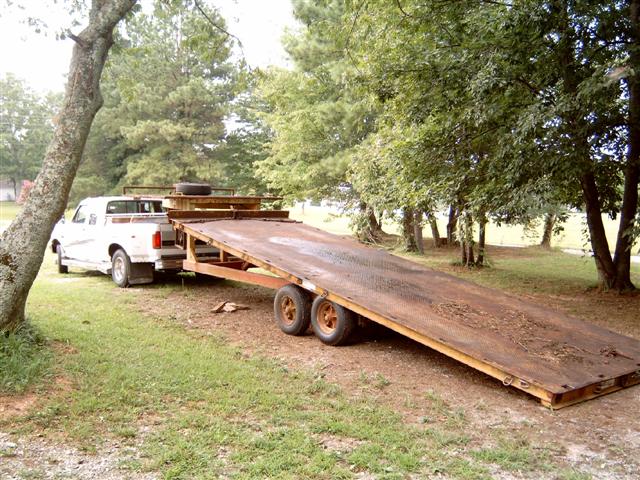

My .02 cents worth,
shop around some more, I just came across this one because the couple was moving out of state and didn't want to take it with them. I did my research by calling the manufacturer direct and he said he'd pay me $4500 for it now if I brought it to Alabama, which is more than what the guy is asking for it. The manufacter rep was also super informative about this trailer. I guess my .02 cents is shop around, do the research, ask a lot of questions, then bite the bullet and get one. We are like you in a sense that we probably won't use it that much but one thing I've found out living on a farm or in the country, somebody always needs the use of a trailer. Plus we bought more than we probably needed for the simple fact of using it as a multi-purpose trailer, ya know, hauling multiple hay bales, putting my drum set on it and rockin out, carrying various vehicles on it, carrying materials and tools as needed for those specific projects on the North 40, etc...
don't know if this helps but I just think you can find a better deal on a used one.
Steve

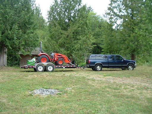

1) That's a great start. Add a couple of feet more to allow for adjustment of load.
2) Wood. But be sure the trailer maker doesn't weld the boards into place with a captive piece of steel. I saw this when I was looking, it was done so they didn't need to put in screws but made board replacement a metal working operation.
3) I do not know the brand. Be leary of the cheapest car hauler you can find. I found some bad examples of workmanship and paint. A few hundred more gets you a much better trailer. Name brands like Big Tex or PJ trailers (mine) are a good bet. I like my dovetail & ramp trailer just fine, tilt adds complexity and takes away some stiffness.
4) Is that a good price? Depends on what they are selling. A pile of junk with shiny paint or a used but high quality trailer. The price is in line with what I saw one year ago when I bought mine for cheap trailers.
5) The trailer to haul a 5000 lb tractor needs to be rated higher than 7000. My 10k rated trailer weighs 2500 lbs empty.
6) Yes. Check for paint underneath as lots of makers don't paint it all. Check for good tires with weight ratings high enough to handle the loads. Check for proper lighting. Check for an adequate ball hitch. Know you'll need to buy a spare trailer wheel and tire.
Be sure to look at the "good" brands to see what the cheap brands have skimped on. In my experience it is night and day and well worth the few hundred bucks for a quality trailer.

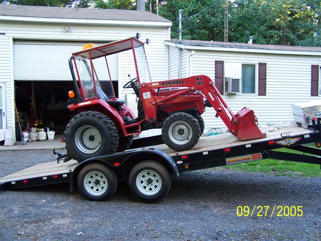

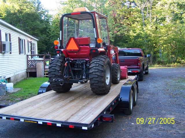

I believe one should buy more trailer than you need. I'll try to answer your questions since I have a tilt bed trailer. Mine is made by H&H trailer and is a 20' x 82" between the fenders. I bought it for multi use since I haul cars and trucks as well as my tractor and a narrow equipment trailer wasn't wide enough for a full size vehicle.
1) for length put your longest attachment on the tractor and take a tape measure from front of bucket to back of attachment. That will be your minimum length. Are you ever going to bring an extra attachment going to a job. If so you'll need additional trailer space to put it.
2) I prefer wood decks. I think they would be cheaper to replace than a metal deck down the road. Just my opinion.
3) Looked at trailer on E-bay but don't know if its a brand name or not not what the reserve price is so I won't comment.
4) A 16' wood deck tilt bed for $2200 may be a good price but does that price include brakes on both axles, D-rings for tie downs, spare tire and mount for same, etc. some trailers are listed as a basic trailer and you may need options that can add up.
5) Weight - You mention your JD3320 will weigh in about 5000#. For any trailer you must deduct the actual weight of the trailer from the advertised rating. for example if a 7K trailer weighs 2300# deduct that from the 7K rating only leaves you a trailer that can carry 4700#. Trailer weights vary by mfg. and type of material. You may need a 10K rated to haul 5000# or more. My 20' tiltbed weighs 2300# and very rare that I haul anything over 4700#. If I need to I use my 12K Appalachian gooseneck.
6) Check underneath for paint or undercoat on the frame. H&H undercoats all their trailer frames.
Lastly, do you really need a tilt bed? A good dovetail trailer will usually be cheaper in price than a tilt bed. See Highbeams pic.
I know H&H trailer and Appalachian trailer as well as others sell tilt beds. Check them online. My Pics attached.
