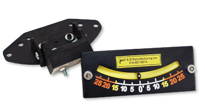

I have a JD 110 TLB.
I just got a Tilt Meter for it, but neither the JD manual nor the Tilt Meter instructions gives me any idea of just how much tilt is safe and how much is too much.
Is there any rule of thumb for this?
I don't want to find out how much is too much by watching the meter as I tip over...
   / Tilt Meter #2
One of the tiltmeters from R&B has yellow letters for 15% and red for higher numbers. See photo from their website. As the tiltmeter is designed for tractors, that sounds like it would be wise to keep it at 15% or lower. Higher than that induces pucker factor anyway. I'd be extra careful using the FEL or dragging anything if I got anywhere near 15% too.

That is exactly the model I got. (Bought it from the link on TBN) I noticed the yellow & red numbers & took the 15 degrees to mean "danger here" and the red numbers to mean "extreme danger here", but every tractor is going to be different.
Maybe I should rephrase the question to:
"Is there any data available on where different machines would start to tip?"

There are far too many variables for the manufacturers to put numbers in a manual. All tractors are different and any additional added equipment such as type of ROPS (if any), canopy, FEL, any 3ph attachment, etc would affect the center of gravity. On smaller tractors, even the weight of the operator could have quite an influence on the COG. I have a tilt meter on mine. But I use it more just for reference than anything. I go more by my pucker factor. But the tilt meter does show me that my pucker factor tends to kick in at about the same point pretty consistently. /forums/images/graemlins/grin.gif
   / Tilt Meter #6
Good answer by Bill (BB TX). I've read somewhere that the tractors should remain upright up to 20 degrees, but that's for the tractor alone; no implements, accessories, etc. And of course if you're moving, and you're already at 20 degrees, it won't take much of a twig or pebble on the high side, or tiny low spot on the low side, to increase that angle too much too fast. As an experiment once, I eased my Kubota onto 18 degrees with the finish mower on the 3-point, and got off to see if I could push it over enough to raise the wheels on the high side. I did not get the wheels off the ground, but might have been able to with a little more muscle. At any rate, I was very careful when I passed 10 degrees and just made 15 my personal maximum.
