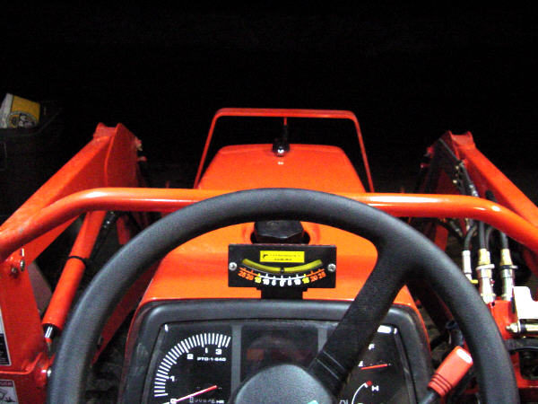

I just took a picture of mine on a B7500. I got mine to "regulate" my pucker factor. In other words, I use it to calibrate the "bubble" in my head. I have had a couple of instances where I have felt the tractor could go over, with a load or hit a bump, or whatever. After that happens, my "pucker" factor is doing overtime. I just need something to look at every now and then to make sure the tilt that I am feeling is real. There is no substitute for being able to know and "feel" your machine. I don't watch the gauge on slopes, I am too busy driving, but I use it periodically to help me verify what my head is telling me. For a new operator, I feel it is important to get this kind of feedback.

mount the tilt meter on a long 2X4 and lay the tilt meter on the slopes that you are wondering about. this way only the 2X 4 will roll down the hill if too steep. One once recongize that it is not the steepness of the slope but the sudden change in slope that will cause a rollover and the meter will do nothing to indicate this sudden change.

you are talking about false safety. If you don't look at on the slopes, why have it at all. But you are right to say you are too busy when on slopes. If the meter had the ability to look ahead and give warning, then you would have a good device. A meter that indicates present time, it will be too late to react.
