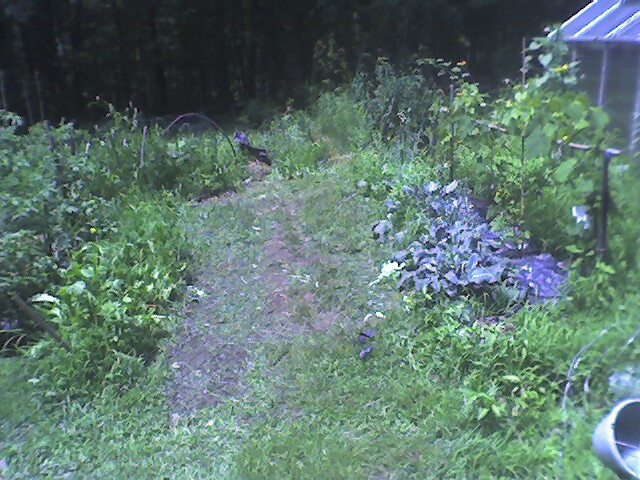

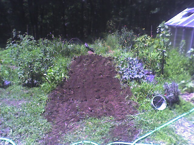

Well the onions were gone from a nice sunny spot and I wanted to plant some corn or beans there, but I'd taken the tiller off and put the box blade on and used it with much success on the gravel drive.
Did I want to put the tiller back on for a 8x15' plot? Did I want to dig it up by hand or use a little electric cultivator I have? No.
But wait! That box blade has those little tiller bars than can be put WAY down.
So I tilled the plot with the box blade and it did VERY well.
Mike

Box blades sure are handy. How many passes did it take to loosen the soil like that?
   / Tilling with Box Blade
Took 5 minutes, say three passes. Little rototiller hardly penetrated the dirt but it was nothing with the box blade. I may be tilling too much anyway, some say it ends up compacting the soil too much...

I too tilled my first food plot with the box blade, scarifiers down. It worked great. When we finally got a tiller and my wife wanted to start a small garden, the first thing she did was rip it up with the box blade scarifiers before mixing in mulch and fertilizer with her tiller. One really good thing is the box blade scarifiers pulled up all the big rocks and roots that would have been a problem. So she tilled pretty clean soil without wrecking her new tiller.
