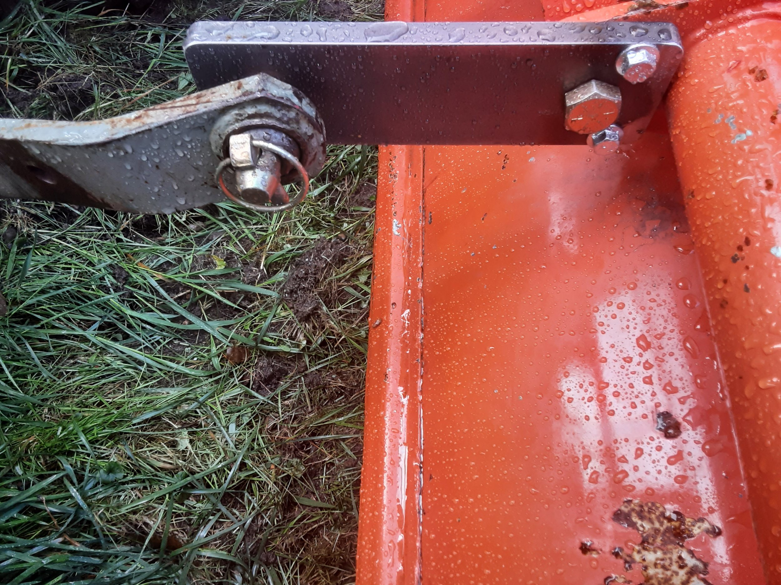

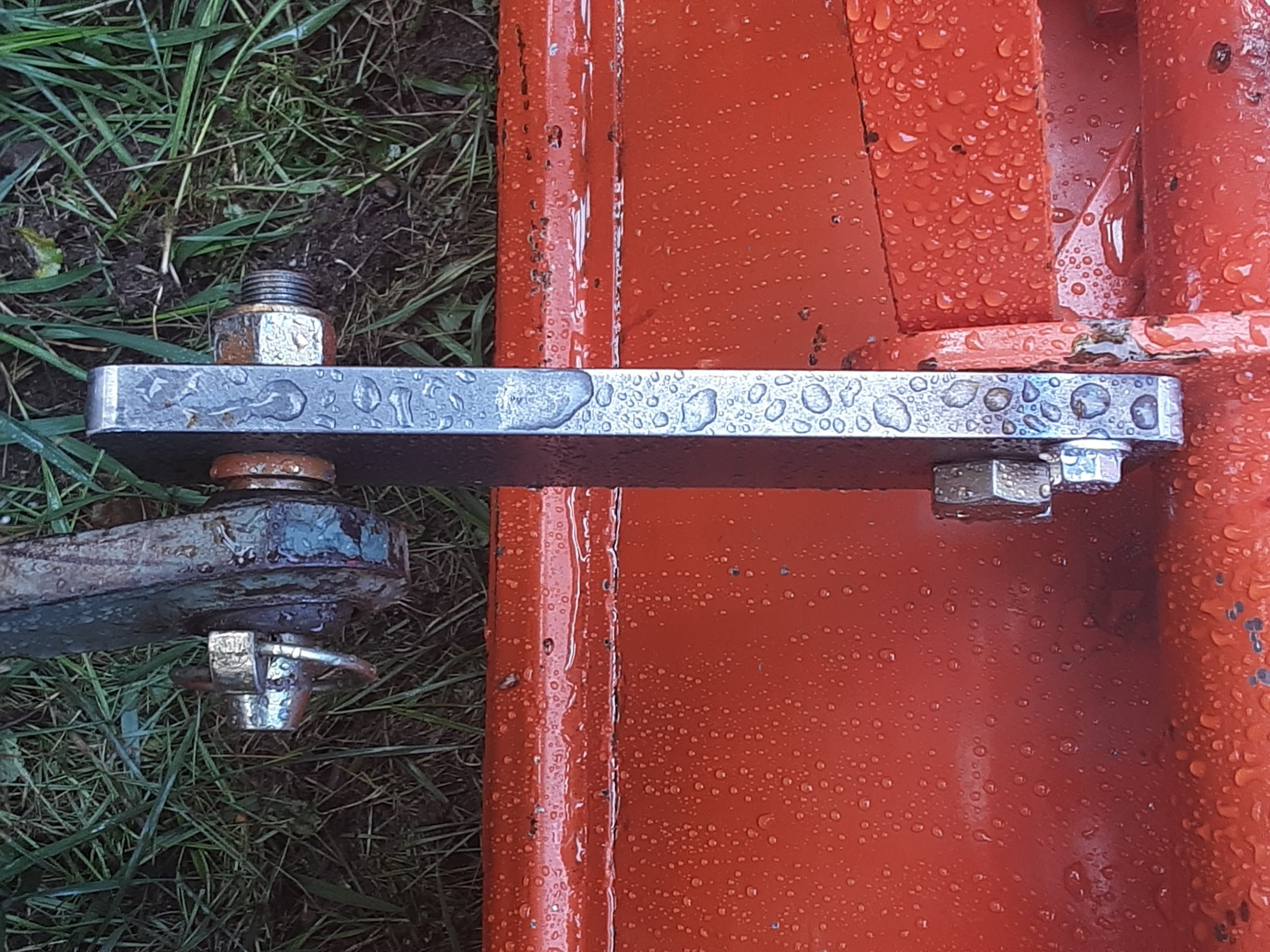

These are the extensions. They are 10 inches long and the pin location has been moved 7 inches. I used a 3/4 bolt in the original pin hole because the hardware store didn't have any 19mm bolts. The other two holes are 10mm. Using the holes in the extension plates as guides I drilled and tapped the tiller plates m10 x 1.25. I wanted to use all metric fasteners because the tiller is all metric. Since 3/4 is so close to 19mm I put 3/4 holes in the extension plates. I tapped the 10mm holes because there is a gusset welded where one of the 10mm holes had to be. Since I didn't want one bolt with a nut and the other threaded in I made them both threaded. The plates are made from 5/8 thick 3 inch wide cold rolled steel flat bar. When the weather warms up I will remove the extensions and paint them. The plates could have been welded to the tiller. I have several welders and the skill to weld them on, but I decided to bolt them on just in case I ever want to remove them.

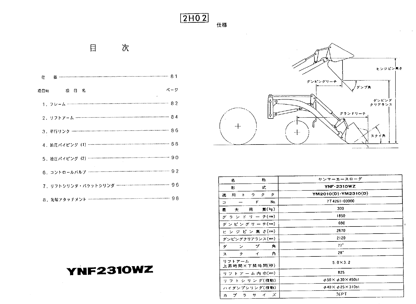

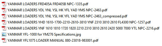

Eric,
Yes, Yanmar made a loader for the YM2310 - - -
For your interest, it covers many of the YM model Gray Market machines with loaders. :)
The exporters to the USA do not send the loaders over here. Rather these loaders go to Thailand or VN for use. :(
This is my limited loader PDFs.

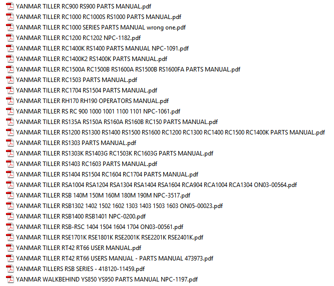

Back on topic of Yanmar tillers, here are my limited tiller PDFs.
  • YANMAR LOADERS YNF 1610 1810 1720 1820 2210 2310 3810 2610 2420 5000 7000 YTL NPC-2216.pdf
