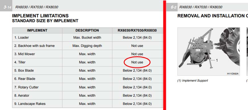

The manual for my tractor does not approve a tiller (rotavator/rototiller).
Why would this be, and do any other manufacturers specifically disapprove?

I looked through the manual available on the Kioti website for your tractor:
https://www.kiotitractors.com.au/uploaded/Manuals/RX6030-8030.pdf
I couldn't find anywhere where it said you couldn't use a tiller. In fact in the section covering attachment of 3 pt implements, the example they use for the manual's pictures is a tiller. I'm referring to page 6-2.
Was this just something your dealer told you?

There's a table on page 3-14 of the linked manual that states "Not use" for the tiller.
   / Tillers on tractors #5
Well then flip a coin I guess.
I would ask Kioti mothership. Sounds like misprinted manual to me.
I only registered the table, and didn't notice the photo on 6-2. So yeah, flip a coin:
Regarding the Kioti tillers, it appears they're rated to only 50hp? The RX8030 lists PTO hp as being 65.
I'm not sure the hp requirements/limitations of my tiller (Sovemo) but I'd think overdriving a tiller would be more painful to the tiller, not the tractor?
