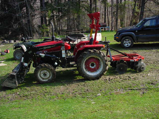

I would like to know the advantage a tiller has over discs? You can do 10X the work with the discs as the tiller and don't have to worry about shear pins etc. Once it's turned with a bottom plow and the soil is half dry the discs do a great job. Whats the tillers' advantage on a 1/2 acre or acre plot??

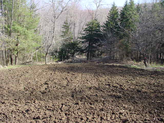

A pic of the plot after using the discs.

The disc harrows farmers use normally weigh in at about 300 to 400 lbs per ft of cut, how much disc can your tractor lift? This means you have to keep driving over compacting more. A tiller will dig 6 to 8" down often with the very first pass giving you a quality seed bed for faster germination and root growth.
   / Tiller Vs Discs
I only made two passes over the same area and was satisfied with the job. I forgot to mention there are many soft ball and bigger sized rocks that rear havoc on a tiller. My buddy up the road tried tilling his plot and kept bending tines and busting shear pins. I can see the advantage of a tiller under ideal soilconditions but in this case I think it is the only alternative. Also what would be a sensible size of the plot with a 5" tiller?? A few pics of my tractor and the work it has done for me can be seen on my website if interested... Thanks for any more info I can get....

I have a 6.5 disk harrow that I bought at TSC. It does not do as good a job as a tiller. However, I am using it to do 3 or 4 acres at a time. A tiller is just way too slow for that. After 2 or 3 passes, going as fast as the tractor will go in medium range, the ground is broken up pretty well, but only 3 or 4 inches in reality. So far I've had good luck with my grass planting doing this way.
If I had under an acred to do, I'd use a tiller.
