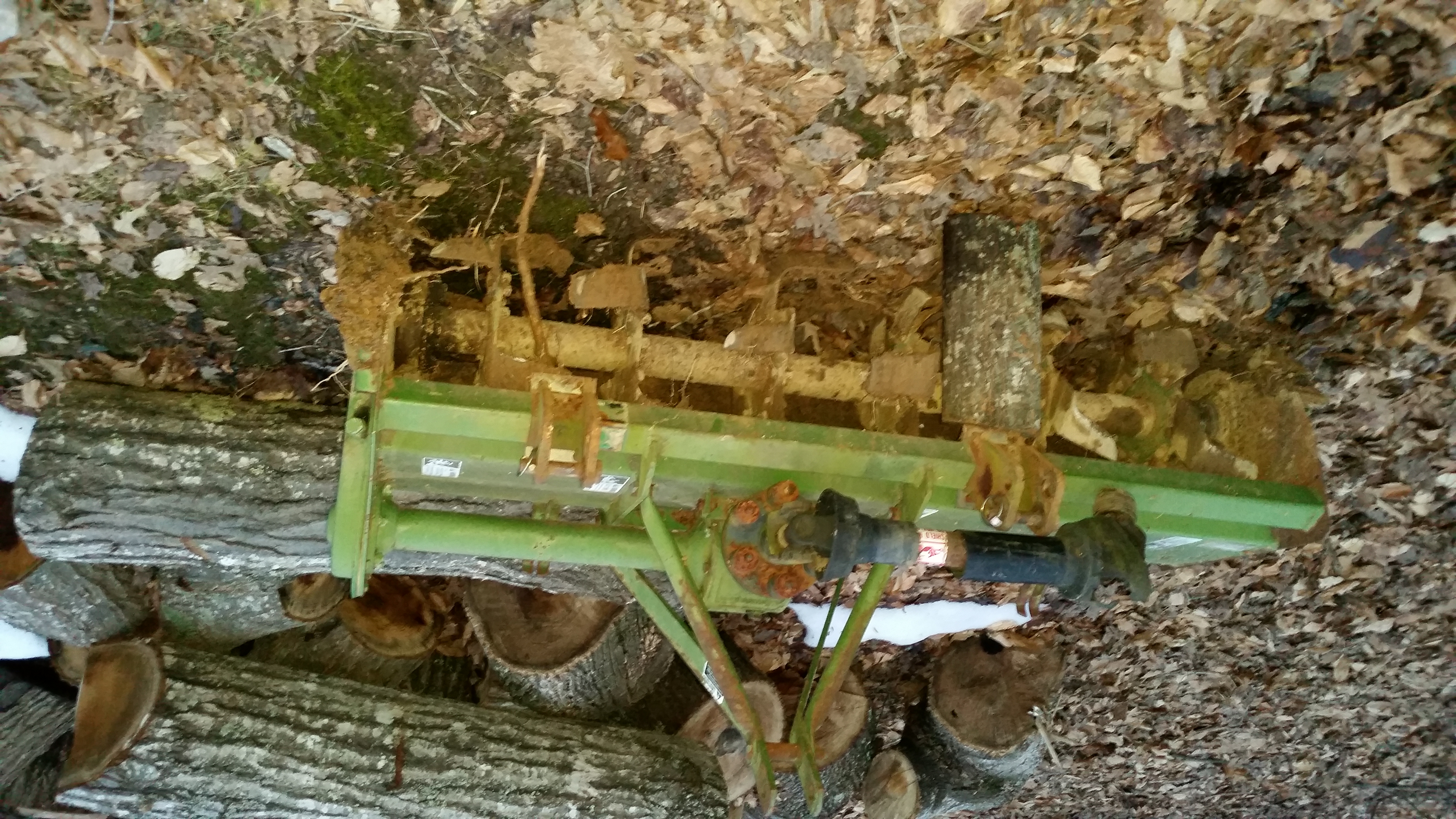

Hello everyone, looking for some input on replacment tines for a tiller, I've done some research on it and still haven't made up my mind so figured I would get experienced advise.
I bought a used JD 660 (built by Howard) a couple months ago and it could use some new tines, the PO replaced a few but they are outnumbered by the worn and broken ones.
The tiller currently has "L" tines on it, however after reading it looks like "C" tines might be better for my application because of rocks and clay around here.
I don't plan on doing a lot of new gardens other then a few select friends/family but I also will use it to prep for new lawns at times.
My biggest hold back on switching is that the "C" tines may not till as well on in the established gardens or give as fine a seed bed when doing shallow cuts on lawns. My worry with the "L" tines is I'll be breaking them due to rocks.
Price is the same for either style.
I might be over thinking it, but just want to optimize my equipment if I'm spending the money.
I believe the broken tines might have been due to the fact that the slip clutch was rusted solid, ended up replacing the driveshaft.
Thanks for looking.

I had a JD 660. Great tiller. Made in Germany, woof! I traded it on a Kuhn 62 210. The Kuhn is a bigger tiller all around and has the C blades. I can't tell any difference in the tilth. If I want the soil finer I just go slower and lower the back gate down. I do think the C blades might use a little less power. I know I had quite a few rocks jam the JD660 and the clutch would slip. So far the Kuhn hasn't jammed once. The C tines could the reason but I'm not certain. If your tractor is a B2620 that tiller will for sure load it down. I would go for the C tines and never look back. My JD 660 was a load on my Kubota L4200 when I had it set deep.

The 2 tines that run closest to the outside edge, on both sides of the tiller, are the ones that wear down the fastest. The tine furthest to the right in your picture has a lot of wear on it but it still has enough length to the cutting portion to cut like a new one. I wouldn't replace it until it came to more of a point at the end. When tines wear to a point, they start wearing the length of the cutting portion shorter, that is when they need to be replaced. Yours has some wear but it still has a lot of life left in it.
As expensive as they are, I wouldn't replace them until they had much more wear showing.

I have a Howard Rotovator also, and did some research when I replaced my tines. There are advantages and disadvantages to both types of tines. They both till the same depth.
The C tine uses less hp since it does not contact the earth all at once, the outer edge will hit first and then the rest of the tine will make contact. This reduced the shock of the blade hitting the ground utilizing less hp. However it does not cultivate evenly. If you were to rake all the loose dirt away the C tines would leave a scalloped pattern at the bottom of the cut. This creates inconsistent tilling depth.
The L tines take more hp as the entire blade contacts the soil. However they leave a smother bottom of the tilled soil. This means that the depth is the same a crossed the entire length of the blade.
I think that they till the ground to the same degree of pulverization, to have a finer fluffier soil Howard made the tiller with more or less blades. More blades meant that the soil was tilled finer.

I was leaning towards the "L" as I could keep the good ones that are on it as spares, I counted about 10 decent tines, 3 are broken and the rest are in various states of wear but all have over an inch of their length worn off.
I think you can see almost all the good tines in the picture so it looks better then it is.
I did see that howard offered a model with an extra flange for a finer finish, I'm pretty sure my little kubota wouldn't be happy with any additional load on unbroken ground, at least not until I bump up the power :)
I think I'll go ahead and order a set of "L" tines and break the ground for my buddies new garden with the old set.
Having a functional slip clutch now will hopefully reduce the chances of tine breakage.
