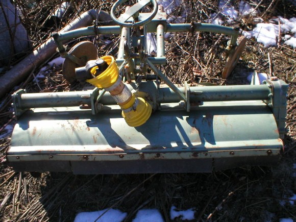

Hello,
Due to a serious cockpit error, I'm in need of the cross kit for the PTO shaft on a Yanmar 1301 tiller. It measures 1.045 across the bearing cup and 2 3/4 overall length. (Measure with a micrometer, mark it with a crayon and cut it with a chainsaw). I tried TSC and the local auto parts store without luck. Looked on Ebay, did a Google search and did find one place I could order it for $23 or so.
Any other suggestions beyond "Put down the crackpipe and pay attention to what you're doin"!
You know something simple like, it's the same as the universal in a 73 El Camino!
Thanks,
Curt

I pitch those in the dumpster when I break them. I order a shaft assembly from Agri Supply with guards for under $75 bucks shipped. That way I have a new shaft, new joints, and a shiny yellow plastic guard for safety! I haven't seen a grey market tiller power shaft yet that had a guard left on it.

Nick,
Here's one with the guard still on it. And yes it does have a label in Japanese, so I assume it to be original /forums/images/graemlins/grin.gif

Yea, but it's from the Ice Age!
How come them Yanmar tillers always look like they were built from surplus submarine parts.

I might have an extra driveshaft.
I assume this is the standard 2 point tiller with the real short shaft? See shaft wired to tiller is this picture.
