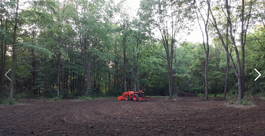

Heres one I did last year that came in very well. I had to clear it first. It was an old apple orchard that had grown into a real mess.
