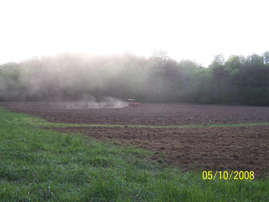

Need some opinions.
I have a 4.5 to 5 ac river bottom, sandy soil. In the past I have plowed and disc for planting, pic attached.
I want to get away from plowing but the dics will not cut thru the crop residue and field grass unless I make several passes. The planting times for crops vary so even if I plow and disc the entire field I alwasy need to go back and disc. This year I plan on planting potatoes in Feb...about 1/2-1 ac. Once harvested I will plant pumpkins in that area plus an additional acre. I do a lot of Fall Harvest crops to sale.
Other crops will be greenbeans, corn, squash, etc.
I want the 5' tiller which cost $1499.00. I can get a field cultivator for around $600.00...5' or 6' give or take. The field cultivator is not the "C" tine but the heavy spring type.
My concern is will the field cultivator cut thru the grass good enough to make one pass with the disc? Disc are 6' with weight on top, (phone pole).
The tiller will be slower but I should only need to make one pass. But 5 ac is a lot to till, but I will not till it all at once...
I want the tiller but I am trying to justify the cost sice it is a $1000.00 difference. But there are other things I can use the tiller for!!
So any opinions???
Also I plan to purchase in the next few weeks.
Thanks,
David

David, if I misunderstood any part of this sorry.
If you have grass so heavy a disk will not cut it think a plow will be a problem unless you are running coulters to cut a path in front of each shank. Think you will find the grass wrapping around the shank and being a problem. For my experience in trying to grow crops (vegetables) without chemicals found the best deal was to disk the field and let it set, then disk again and bed it in rows. Let it sit that way until I am ready to plant. Then at most the day before bust those beds open and rebed (can be done in one pass with cultivators set with leading middle buster and then hillers to bed it). It gives a very weed free bed to plant on. There are trips in this and may not suit your desire. but between a tiller and any type of plow believe you will find the tiller the best choice for single pass.

David,
I tries to go field cultivation in lieu of tilling and it did not work well. You have to have c-tines so close and many of them to make a good bed and then you'll have issue with maintaining constant depth and lot so HP to pull. Tiller afford you one pass ready bed with not much horse power if you go slow.

A conventional field cultivator probably won't do well with crop residue. Under normal circumstances a disc will do better. If you're already having issues with a disc, I'd say the problem will be worse with the cultivator.
Tillers do OK in MOST crop residue, but you'll still have issues if the residue is heavy enough.
When I first bought my tiller, I tried it prior to planting a 10 acre field of corn on corn. I tried another field, approx 5 acres, with a disc first then the tiller. I was much happier with the outcome after using both tools. Crop yields were almost identical. Your results may vary.

I was hoping the tiller was the best way to go:). I have not used a field cultivator before. We always would plow and disc. I had tried the one row culitvator but it was so light it would not work good. I was wanting to use the field culti to loosen the ground so the disc would cut it better and be quicker than plowing. The field grass is not thick but there is enough there to keep the disc from cutting in without 3-4 passes.
I am basically looking for a quicker way to get the field preped and the tiller looks like it is the best option.
Now to find a TSC that has one in stock. I have two TSC close to me and one will not have any in until Feb-March. The other has one 5' KK in stock. I will try to get by there this week or next and have a look at it!
