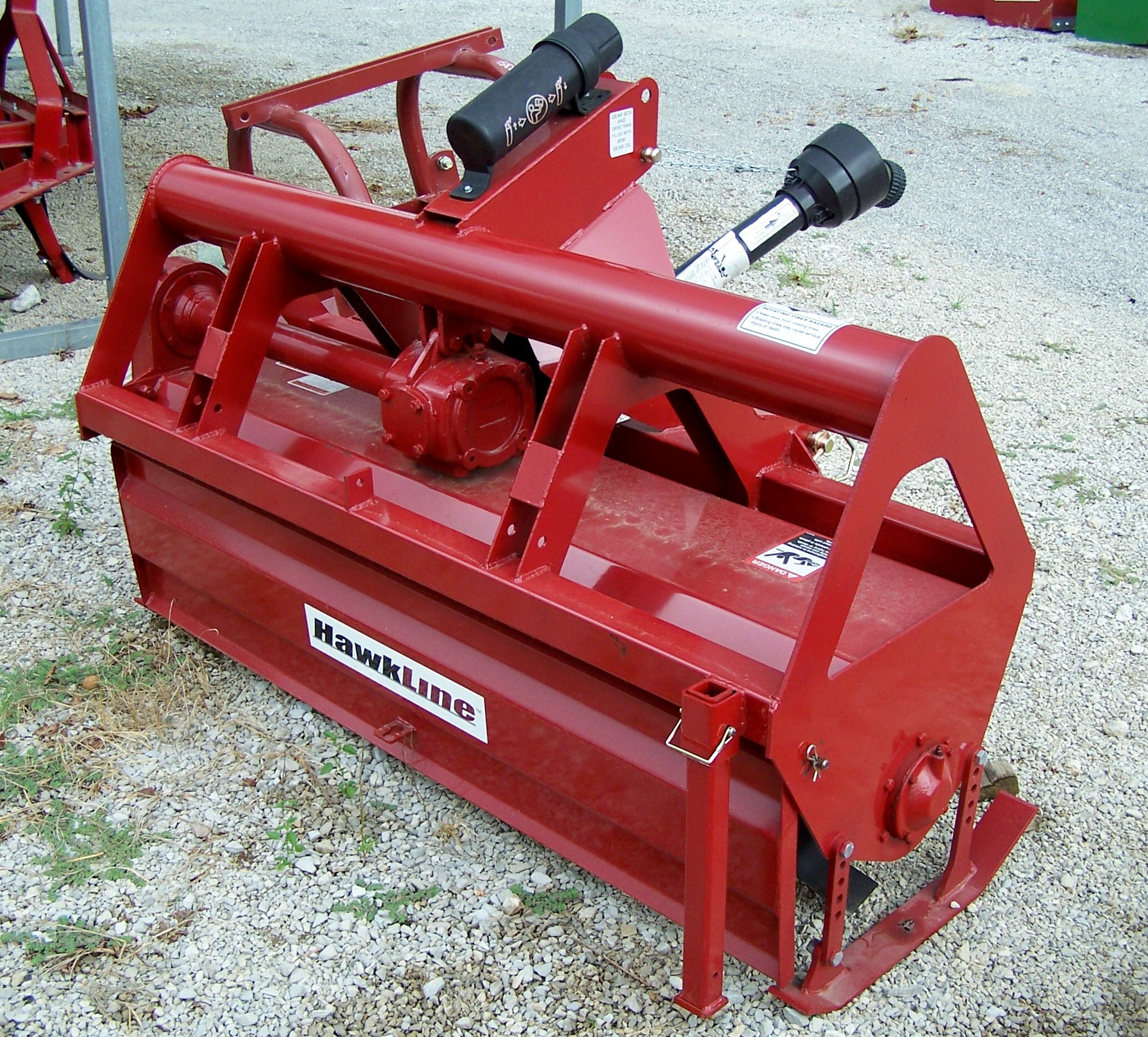

Looking for advice on purchasing a 48" tiller for a GC2400. A little history, originally began looking at compact tractors of approximately 30pto hp. After looking at all major brands I felt the best overall tractor was the MF 1643. Unfortunately the frame size of that particular model dwarfs others in comparative PTO HP. Given how well I like the MF, I am leaning toward purchasing the GC2400 with a loader. I think overall it will be more useful around the yard for now and later down the road I might be able to justify a larger model.
What I am trying to decide now is what type of tiller to stick on the back. Has anyone out there tried a reverse rotation tiller on one of these tractors?

We have the 48 inch Hawklin by Behlen Roto tillers with gear drive and 6 tines per rotor, weight 600 lbs and slip clutch for $1495. We also have the Phoenix/Sicma 58 inch (small as I can) get for $2750. I also have the First Choice/Sicma 50 inch reverse rotation for $2650. Hawkline by Behlen shown in the pictures. Ken Sweet

Reverse rotation?
   / Tiller options GC2400 #4
The Hawkline is standard and the Phoenix and First Choice are Reverse rotation. Ken Sweet

So are you saying reverse rotation does not tolerate rocks well? If that is the case I will stay away. I have a field stone rich environment.
   / Tiller options GC2400 #7
Reverse rotation will throw rocks towards the tractor.
On one of these 2400's, it shouldn't hurt anything.
But on my old Cub, that was all belt drive, a certain size rock(usually flat, about 1/2 thick, and about the size of a 50 cent piece), would get caught between the tensioner pulley and the belt. Cutting the belt in half.
And at 125 bucks a pop...............tilling got quite expensive at times.
But as far as 'tolerating rocks'.........a reverse tine tiller will actually dig them out of the ground.

Yes, I was talking about tractors. I see you were where I am. The only one that I think might compare to the MF would be the Kubota. But like you, I think their control pedal/brake configuration would be too cumbersome to enjoy.
Good heads up on the tiller offset. I had no idea to watch out for that. I have seen posts somewhere mentioning use of a 56" tiller on a GC. Think it would handle it? I'm beginning to think I could use a 60" on it given I am currently running a 42" I think behind a 12hp Case 222 (hydraulic drive tiller).
