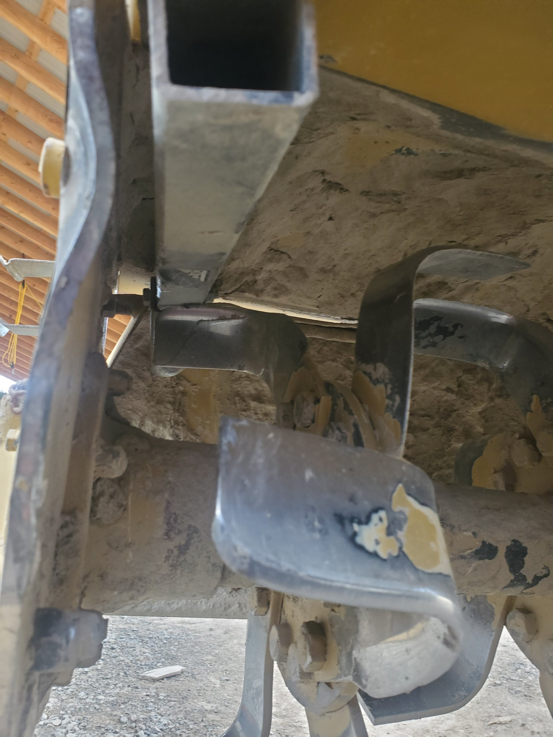

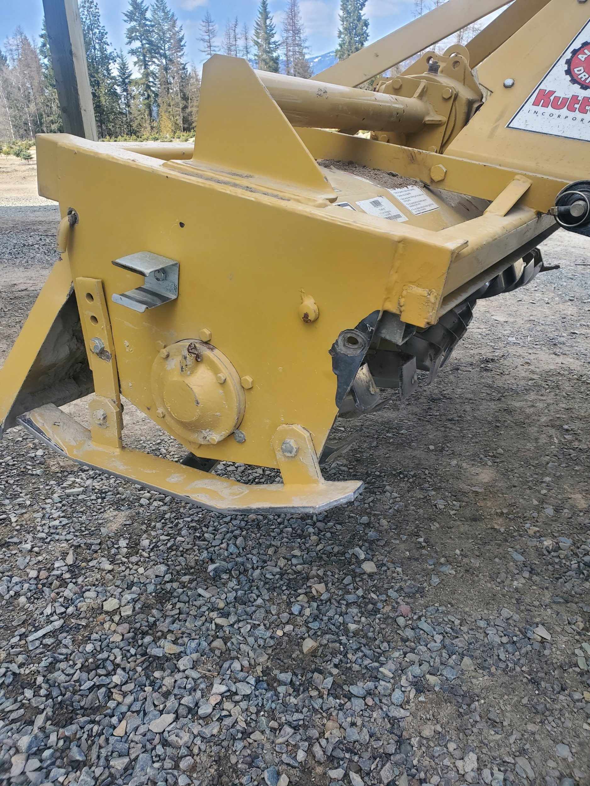

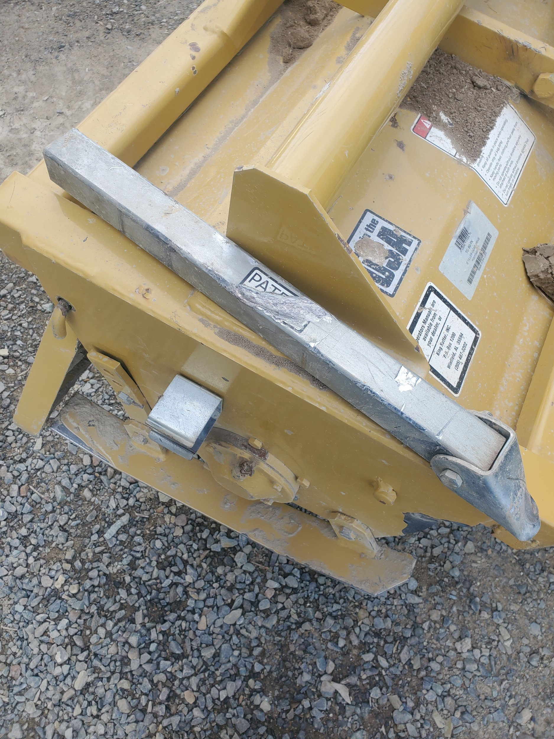

Got home from work, greased my trusty KK tiller and hit the dirt today.
I Was finishing up a 2 acre till from last night. I was tilling up-hill, not super steep but I noticed the LS was seeming to loose traction, stupid R-4's I thought... the loss of traction compared to R-1 I have noticed the more I use the LS that is so equipped.
Pulled the 4x4 lever and continued on my way. Very shortly after the tiller started making a racket that sounded and felt like I lost the gear box then it locked up.
Luckily, I just Lost the kick-stand instead. I had forgot to hang it up after greasing the tine tube bearing.
Some bending back of metal and a new bolt and I thinks I'm good

I welded a cheap trailer tongue jack on the bar that runs across the front of the tiller which allows me to raise/lower the tiller to make it easier to hook up. Once its hooked up I just swing the jack up out of the way.
