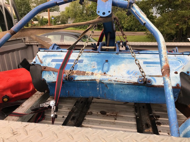

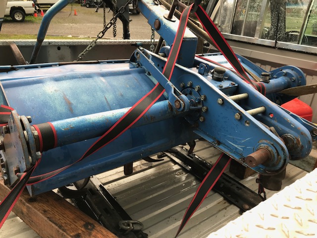

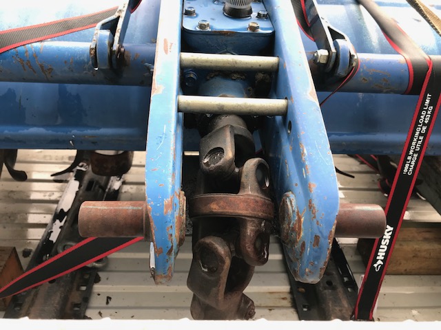

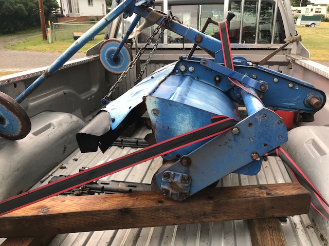

Acquired this tiller & want to know what brand & Model it is..... Is there an adapter bracket to mount this tiller on a 3 point Hitch?

Judging by the color and for the mounting type, looks like an Iseki tiller. Some old grey market tractors like Kubota, Iseki, Shibaura and others usually use this proprietary attaching system. They didn't use the regular 3 point system at the time.
Those tractors were used in rice plantations in Japan, so they would never had to remove the tiller.
